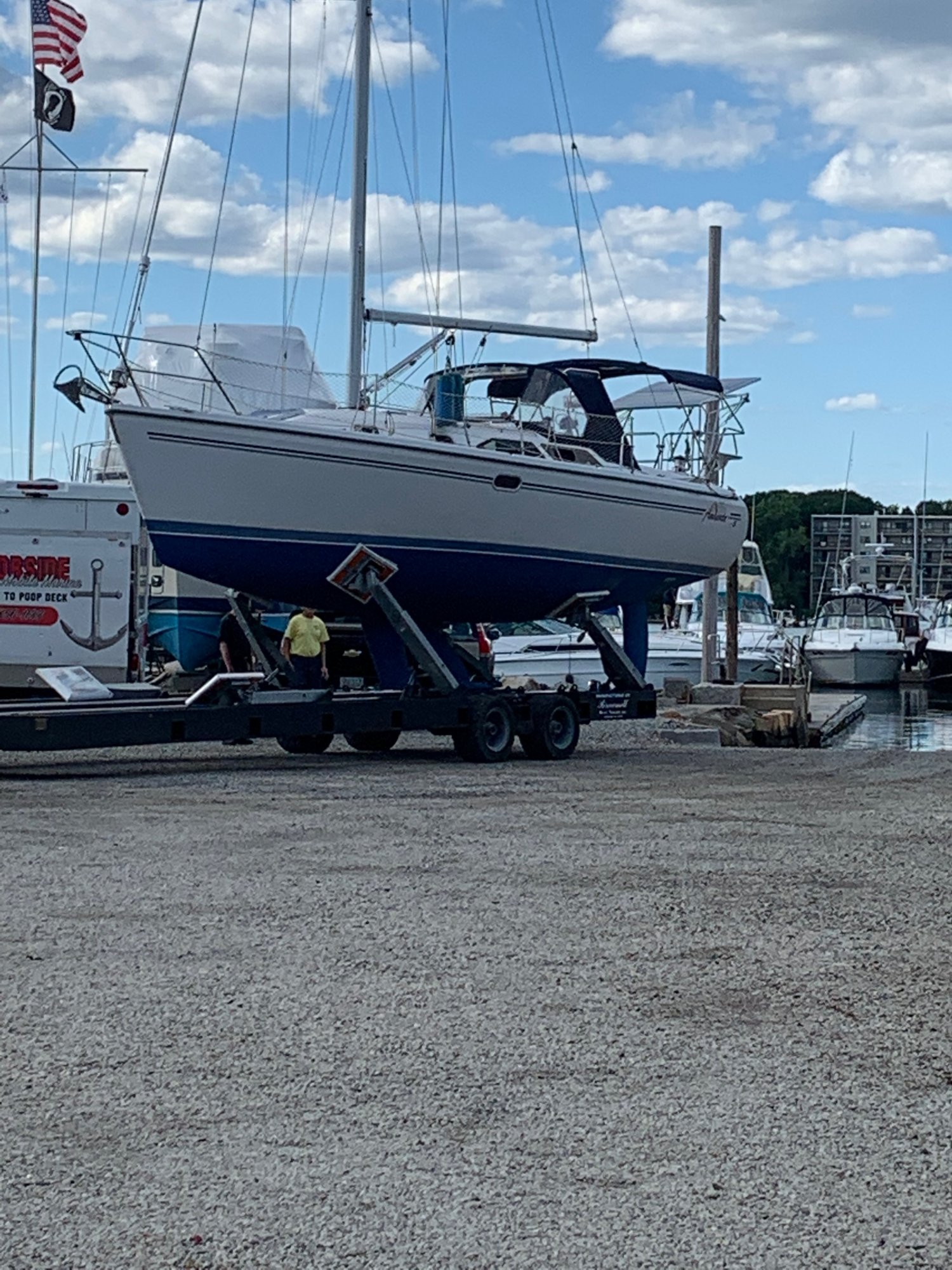

The wings both had yellow paint from the trailer on them, so we assume one may have been stuck under the trailer.
If this was the case, the yard definitely screwed up. The keel should have been supported by a cross beam, with the wings above the level of the trailer. The hydraulic arms should only be stabilizing the boat, not supporting it. We use a Brownell trailer at my yacht club, and different boats require different cross beams and settings on the arms. Deep fin sailboats require a strap suspended between the legs of the trailer to support the keel. Maybe the yard used a strap on your wing keel.

This is my C310 being launched on a Brownell trailer. Wing keel is above the level of the trailer.
