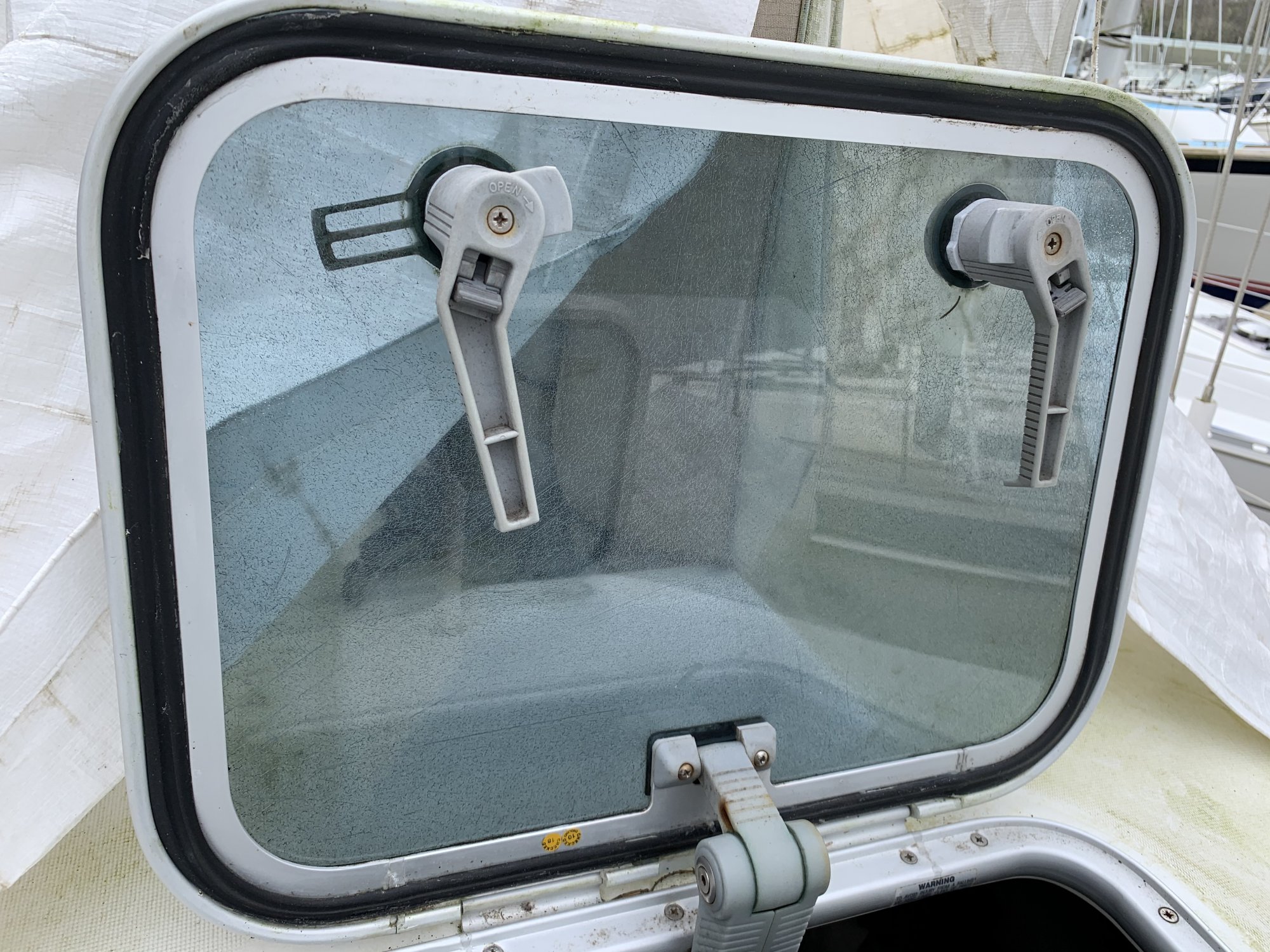

Hi there,
I have a 1996 Beneteau Oceanis 321 with two size 30 Lewmar hatches, both of which have taken this wet winter as an opportunity to spring a leak! I am trying to discover which size 30 hatch I have so I can get replacement seals - but there appears to be a choice from low profile, medium profile, ocean and maybe even costal!
Can anyone advise please?
Thanks

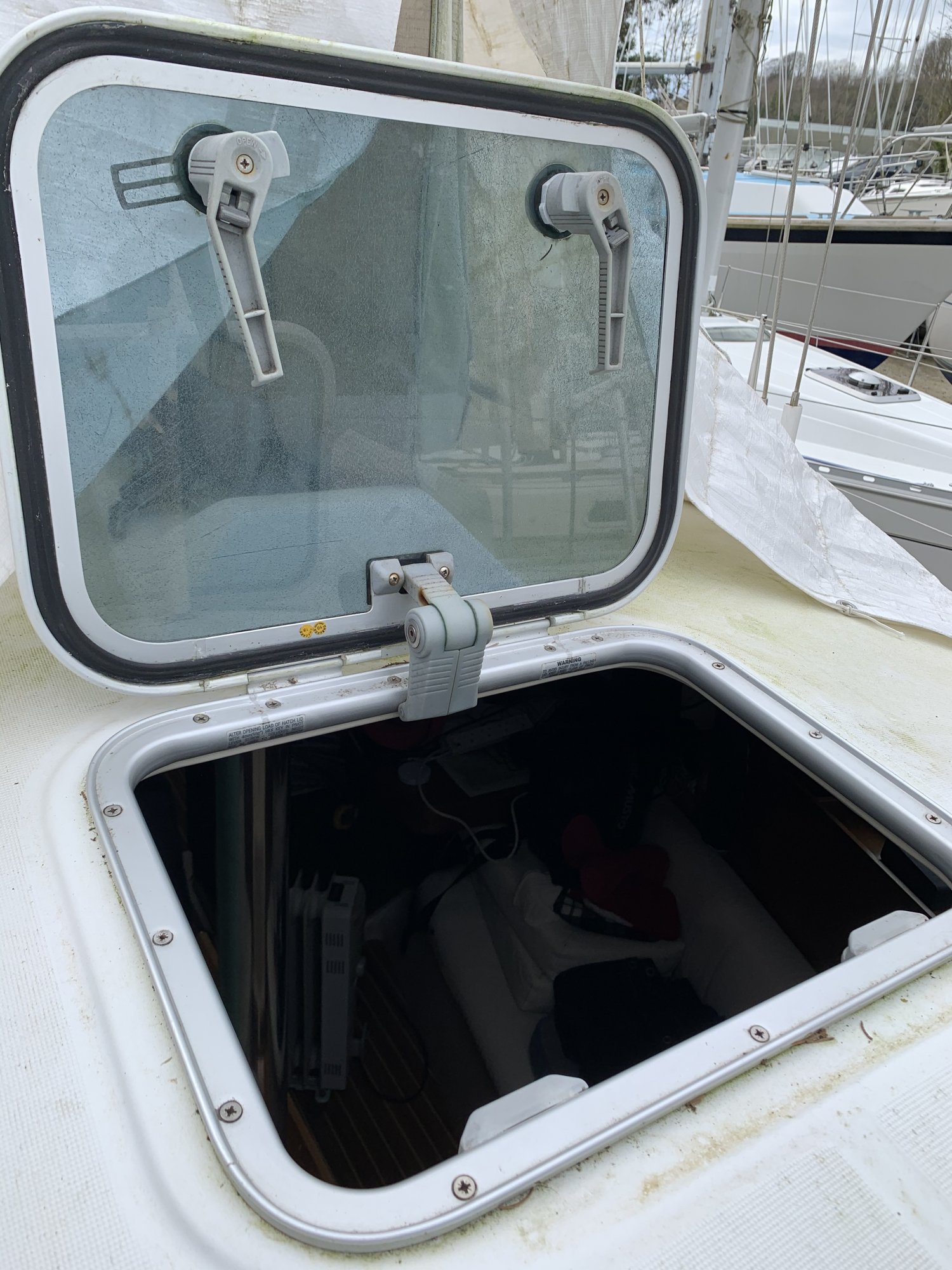

Might have better luck if you opened the hatch to show the angle of the aluminum frame which Lewmar changes for each model. Shots of the inside hinges and dogs would also help. Look the same as mine.

Thanks Ralph, am hoping to get on her tomorrow so will try and get a specific pic

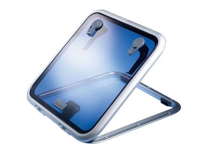

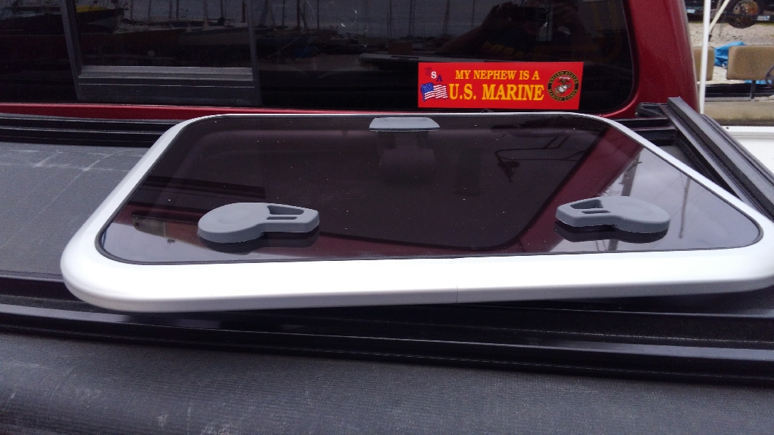

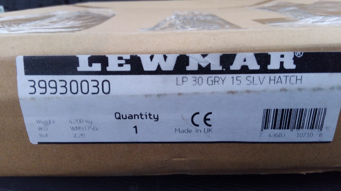

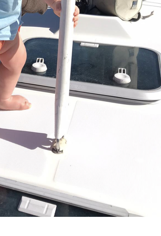

I would agree with @Wesleymi they look to be the Lewmar low profile hatch with the lip frame.
Size 30 Low Profile Hatch Self Supporting
39930030
Image wise there is little to distinguish the low and medium profile hatches.
Size 30 Medium Profile Hatch
39930020
As I understand they have the same outer shape and look. The description identifies the difference as thicker acrylic and deeper frame sections
Product Description
Ideal as a foredeck hatch on larger offshore yachts, the Medium Profile has thicker acrylic and deeper frame sections for greater strength and durability. It features Lewmar’s unique sealing system, allowing for easy acrylic replacement. All while retaining the smooth, modern lines of the Low Profile Hatch.​
A part number would be your best reference. I suspect they use the same gasket. But that is only a SWAG.

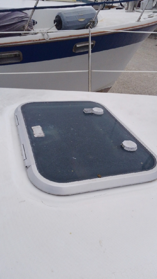

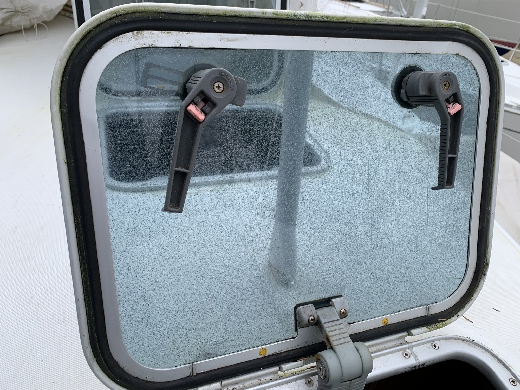

Ahhh looking at this now I wonder if it’s not an older hatch!? ‍♂
hi
So for the record, these are coastline hatches, now discontinued although seals are still available part number: 360595999
