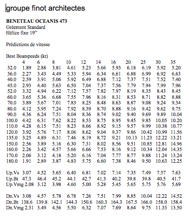

6.1 knots definitely is slow for that boat. If you are measuring your speed with a knot meter, it may not be calibrated correctly. The data in the file below should give you a good idea of you boat's speed potential.
What are the numbers in the first column?
Ted
Jan 26, 2005
1,215
C&C 110 Bay Shore, Long Island, NY
The numbers in the first column are the wind angles.

What kind of speeds do you get when motoring? The speed under sail does seem low, and the polars from Ted agree with that.
