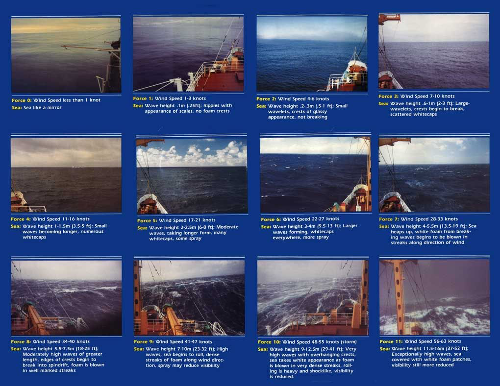

Translating what you see on the water to wind speed is a seamanship skill to develop. The Beaufort Scale is a relevant tool. Here is a guide that might be helpful.
