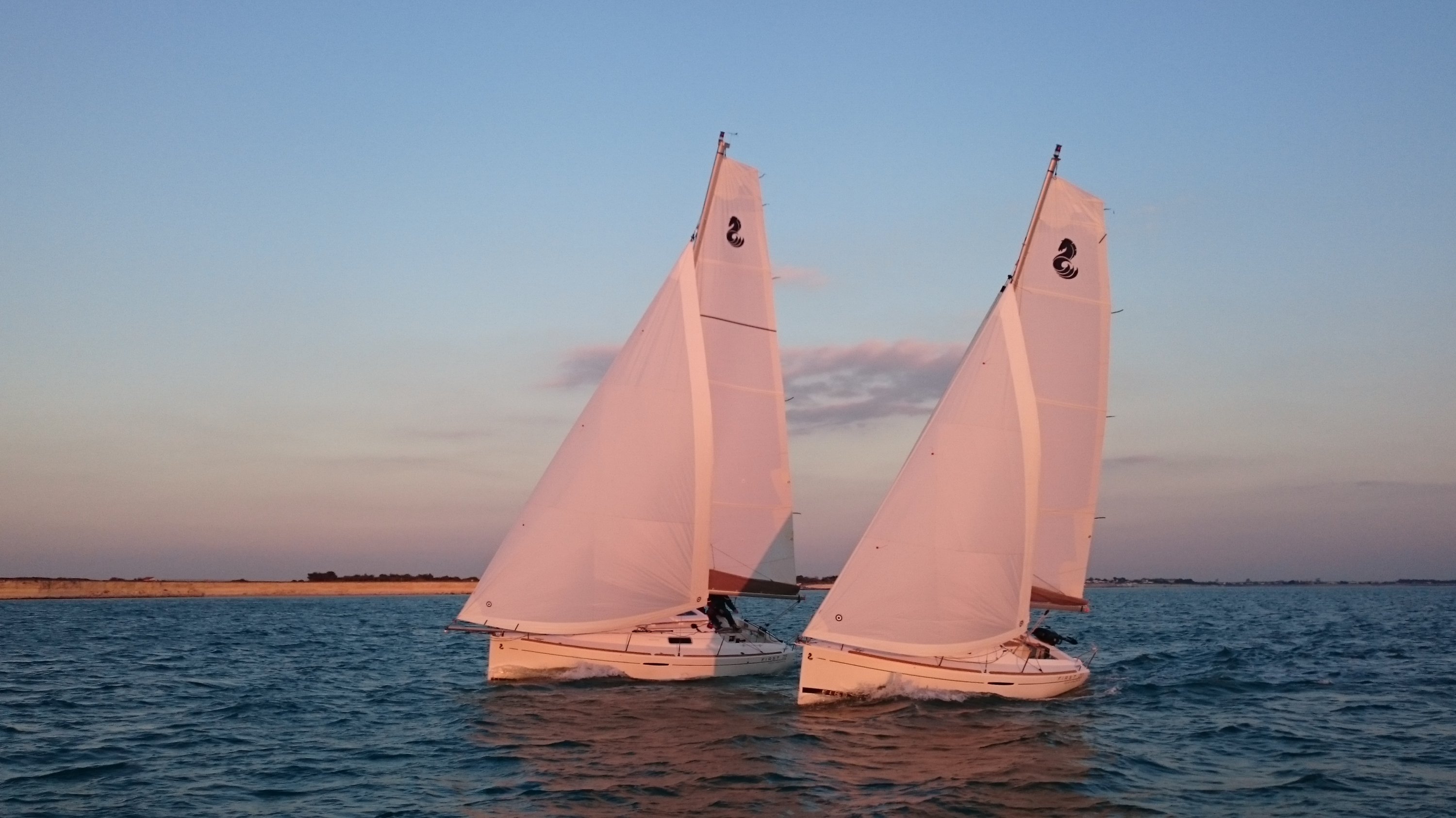

Steve: The current thinking is to fit the boats with a 'reacher' / 'screacher' / "code zero minus'/
This is effectively a large free flying full genoa that sheets to your spinnaker blocks. It is a light air genoa up to about 10-12 true, adding a big does of fun to upwind lightair work and then anytime you are reaching or heavier are running.
Once you are into the upper teens you can sail as low as 145d apparent and be smoking fast with it up. It's weak point is say between 5-15c at low angles..(can be helped with a wisker pole).
We do these all the time..made from a light laminate or radial dacron 5.6oz in your case AND with a cover. As the whole idea is to make the sailing simple, you can leave it up most the time, unless the wind is going to go snotty or if you are going to be away from the boat for sometime. People that use them, favor the ease of handling for the loss of 'true' light air off the wind performance an asymmetric spinnaker will give you and absorb the bigger cost of the furling gear over that of a dousing sock for same reason. If you're sailing in MD...then you just have to think about the type of sailing you do to help with the idea of using one. Check with Fred or Chris at Annapolis Yacht Sales...they can make a pretty good case for these as they have used them.
Attached is a picture of a new Beneteau F21 and F25 showing off this type of sail.

Bob,
Far out, I learn something new!
Questions:
1) People REALLY leave those things up all day? Fascinating!
2) Use the standard spin halyard? Enough luff tension?
3) On the 25s the sail looks small (and a bad lead angle to the clew) was it sized for the pole?
4) I host the Beneteau First 260/25s Facebook page, can I use that image and your text (with your contact details as well?)

Jackdaw,
Yes...the 'technology' came from Cats and maybe volvo round the world boats...early 'screachers' were light weight laminate or nylon...too light for UV covers..it didn't take long for us to figure out everyone would be better served with a real uv cover and a sail that would be strong enough to close haul with in light airs. Cruising cats love these sails and as they don't really sail super low anyway it was a natural. Then came the newer gen. Beneteau's both the OC and sense models which are quite a tick up in hull design/performance and the transition to this type of sail was pretty easy. Some of the Tartans and the blue jacket 40 have picked up on this as a built in.
The sails are not really code zeros as the mid girth is only like 55% of the foot length, compared to the 75% of a code...so we call them screachers on multihulls and reachers on monohulls.
Typically we like to see the halyard as a 2:1 at the top...the more tension on the luff the better it performs as a 'genoa'. Smaller boats maybe not needed.
25 clew height...the sheeting position is a bit further forward than the 21 relative..and as you see it in the picture the sheet is about dividing the clew angle which is what I'd expect with a reaching sail...so the compromise was getting a clew height that makes for a good sail of this sort (higher) but still sheet..so if we go bigger, the clew would get lower and with fixed sheeting point, it would be less of a good reaching sail.
Yes, you can use the image. Beneteau France is starting to equip these two boats with this system instead of the kites, as they found customers just weren't using the spinnakers...which is what we are finding on the bigger boats as well.
Bob

Clever stuff. I agree that using a sturdier cloth is better for this application, and slimming the MG helps it furl much better as well as making the luff easier to keep under control and not fluttering. It might however cause trouble (or help!) with your ratings board.
I'd figure that the 25 is probably the end of a 1:1 halyard for the sail; maybe a bit bigger because as you note it truly not a zero nor intended for the loads you'd expect in that application. Nice design for the purpose!
What endless line furler are you having best luck with? The Pogo we sail on switched from a Facnor to a Karver this season; goodness what an improvement!

Jackdaw,
Beneteau France has a couple of videos of the F20 and F25 with the new sail configuration. Note: these were the prototypes, so I'll say up front that the jib on the 25 was a bit long on the foot (you'll see it' sheeted right to the back of the track) but great shots of them sailing with the screacher/CZ's.
The Mains are our 'spitfire' head fitted with all full battens and coupled with completely new and novel lazy bag system.. this, the screecher and the small jib make both these boats really easy and fun to sail.
Here are the links for the youtube vids:
F25 video::
F20 Video:
To answer your question regarding the furlers...both of these are using the Facnor FX900..simple and seem to work pretty effortlessly. I haven't tried the Karvers at this size.

Bob, that's very very cool, thanks for sharing that!
I wish Bene would have opted for a sprit for the 25 like they did for the 20. We used to have a Sparcraft pole but I took it off; for the amount of time we used it (normally going symmetric) it was just mostly in the way. The sprit would be nicer for codes anyway. We currently tack our reaching sail to the bow fitting with a short dyneema strop. It works but its not great.
The jib track on the 25 is in the same place as the 260 variant, which makes sense as its position is molded into the deck. But the 260 jib size was limited in size/leech profile by the leech first hitting the D1 stay. As the the 25 has no inners, there is more room for a bigger J. But you run out of track!
PS - I shared the vids on the First 260/2 FB page.
