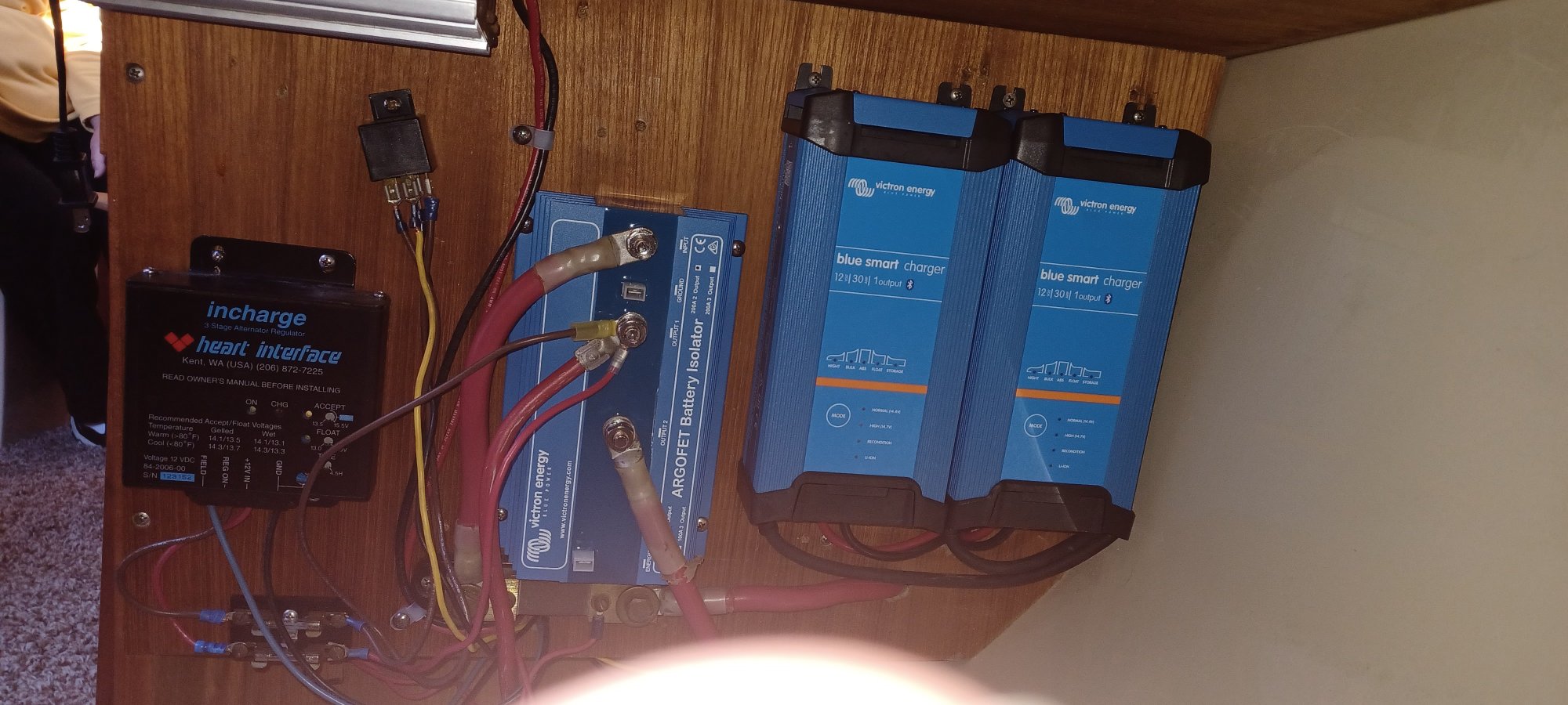

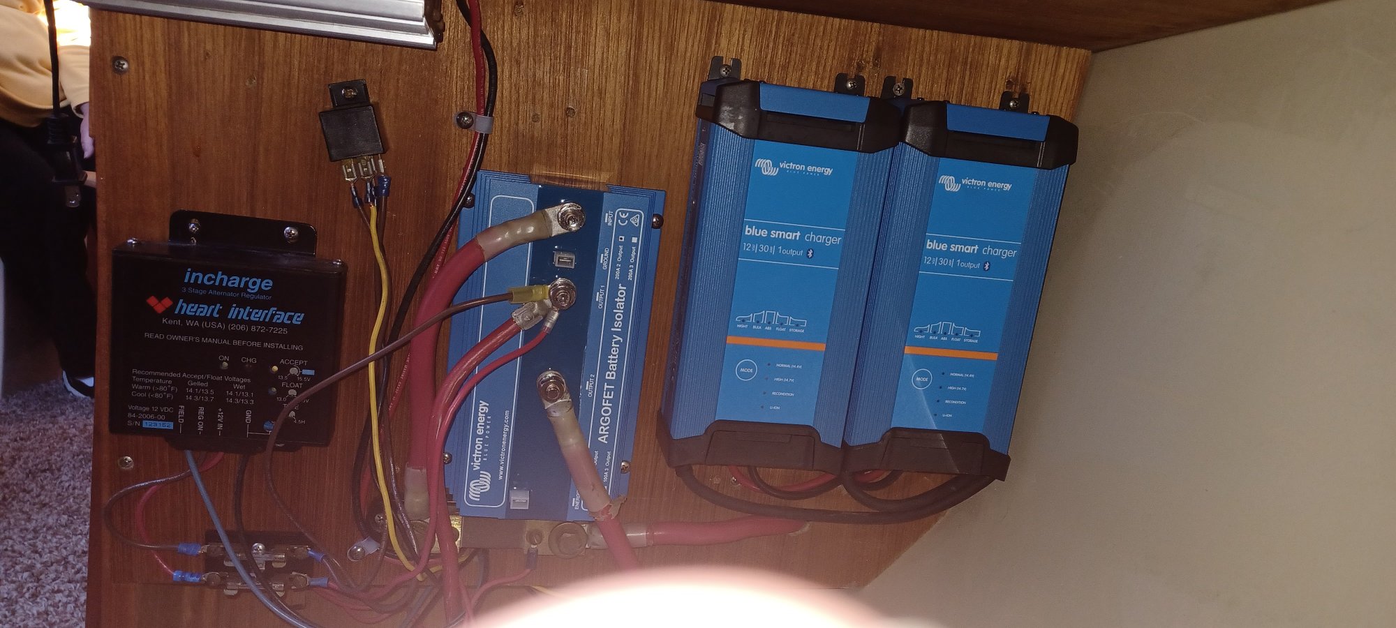

In my opinions, the best bang for the buck currently is the Victron IP22 30A charger. It comes in either a single bank or 3-bank version and sells for about $200. I have two of them installed on my boat for 60A total and they do a fully customizable synchronized charging. It also has the ability to use tail current for final charging the Absorption phase. Compact, powerful and completely silent.

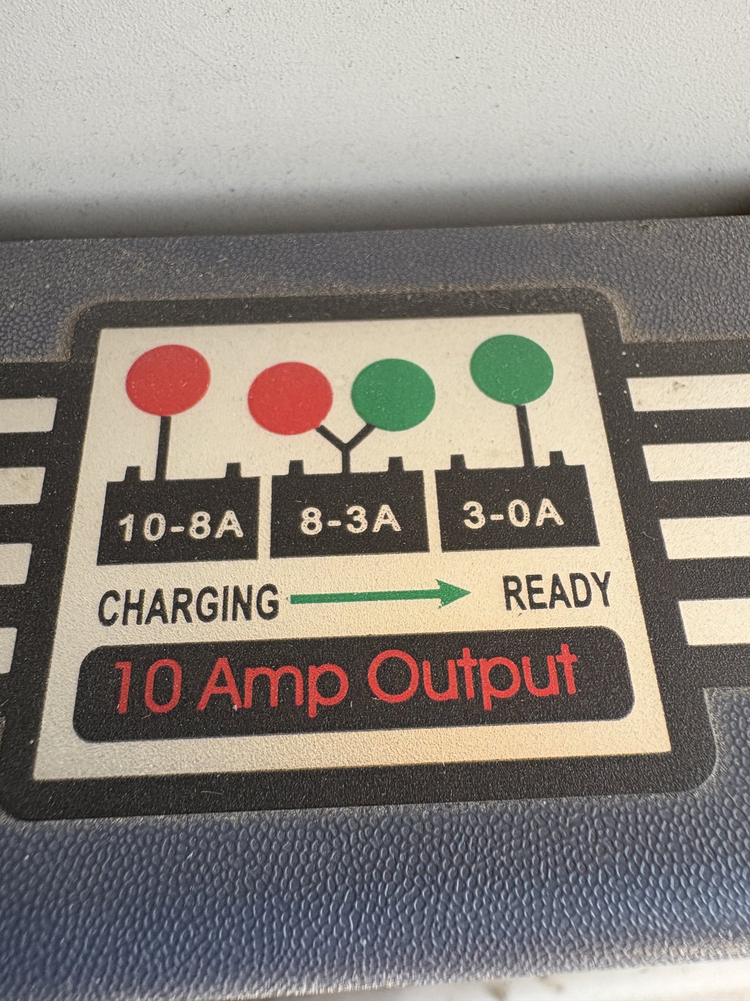

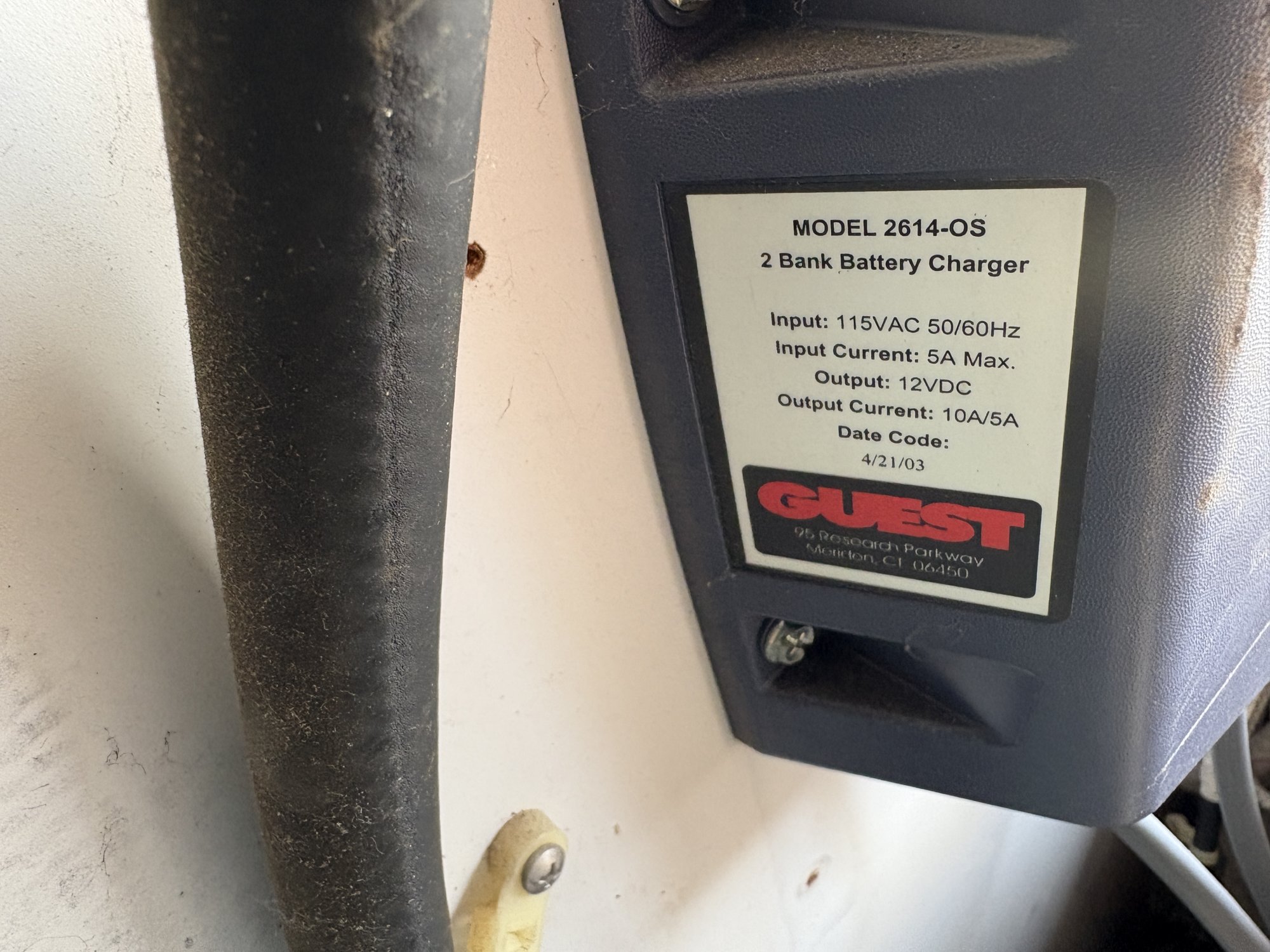

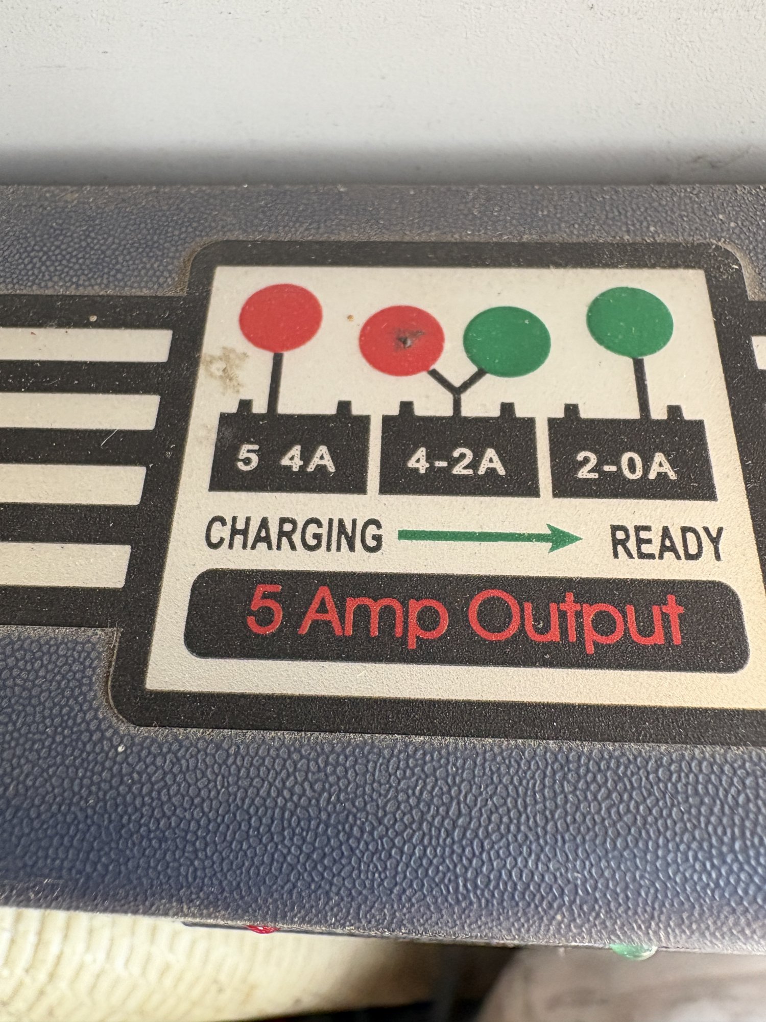

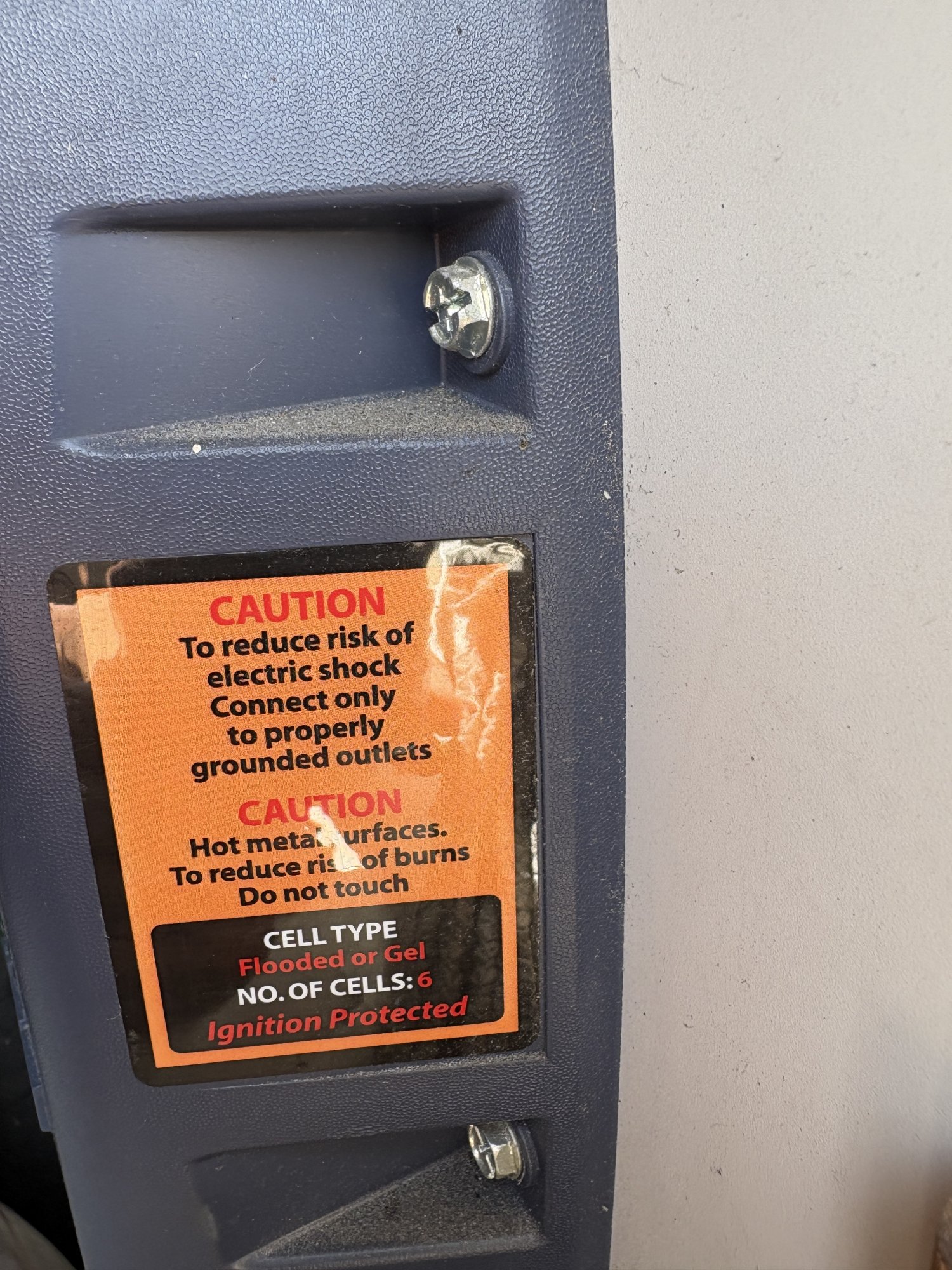

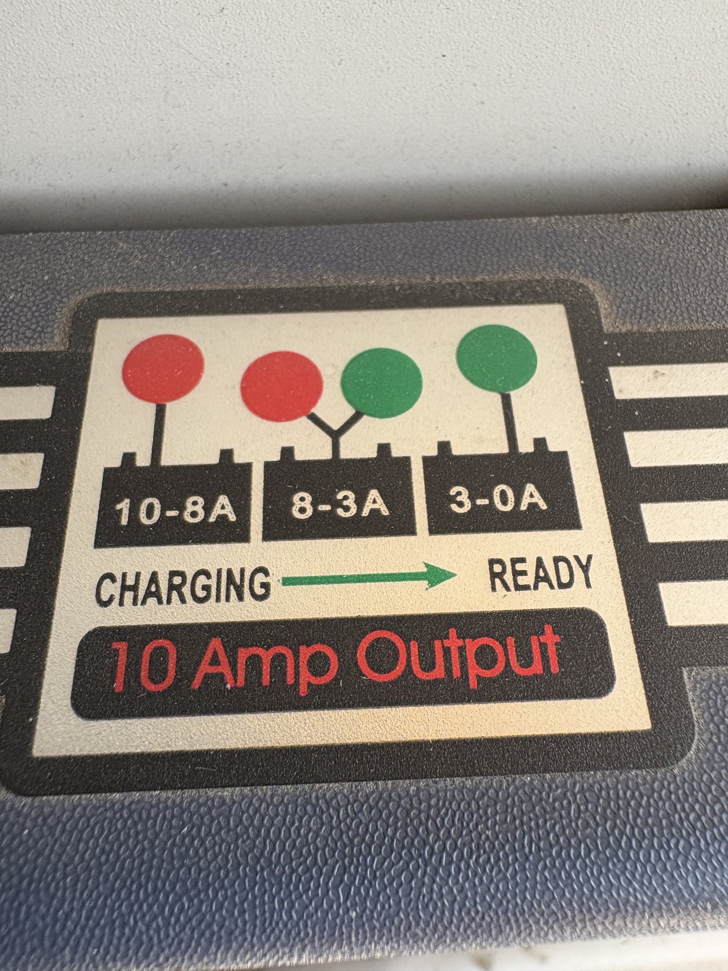

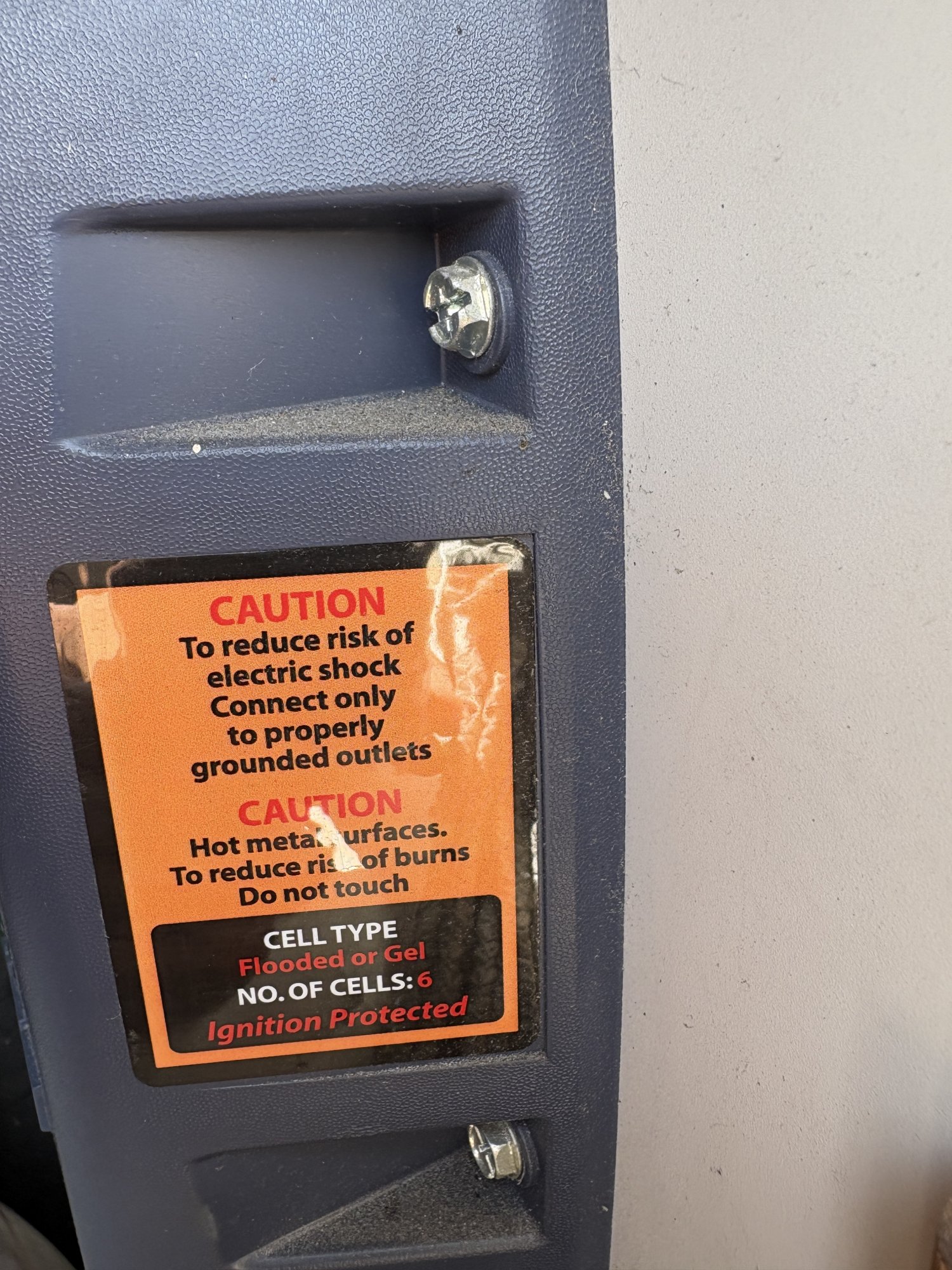

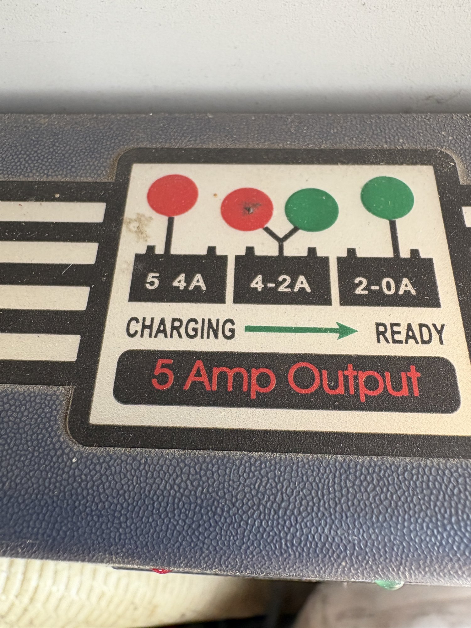

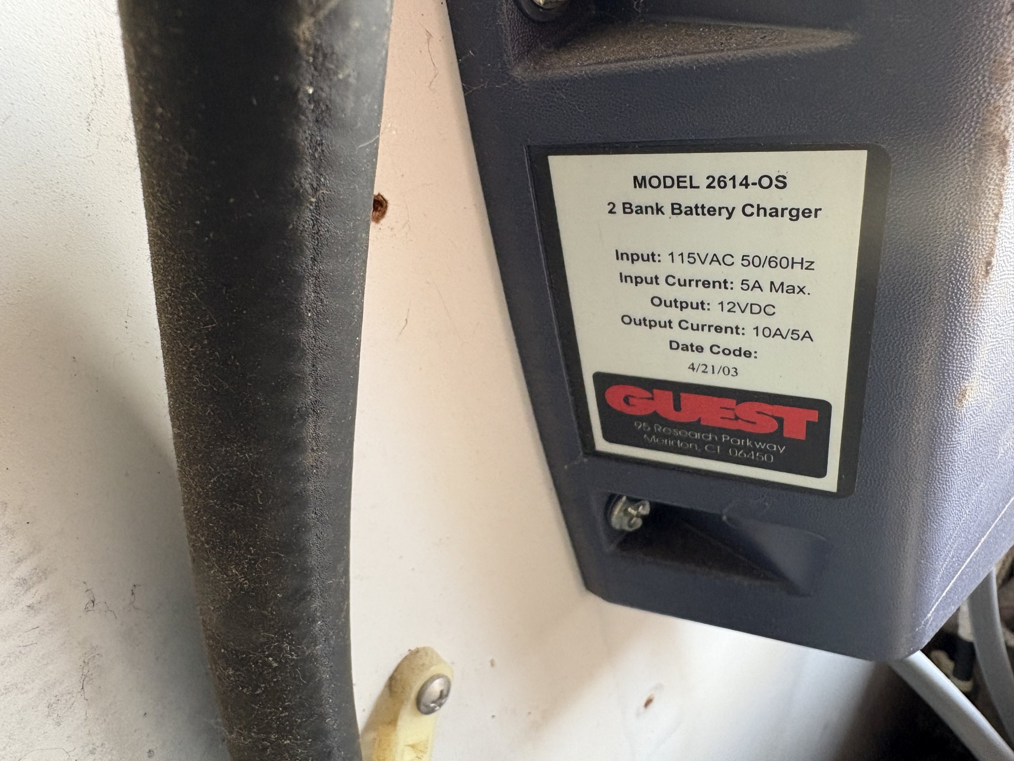

Thanks for all of the comments so far. I was at the boat today and got some info on my old battery charger…
Guest 2614. From 2003. I don’t think that this charger will be good for LFP…
View attachment 232402 Specifically says for lead or gel…View attachment 232401
here are the only charging profiles…
View attachment 232399 View attachment 232400
On a positive note, my Renogy battery monitor says it would work with LFP.
But at this point, I think I am going the easy route and replacing my lead acid batteries in kind and be good for another 4-5 years.
Thanks for the comments and suggestions.
Greg
Here is a link to your charger's manual. Guest 2614A Owner's Manual (Page 11 of 15) | ManualsLib
On page 11 it shows that your absorption voltage is 14.3v and float is 13.3v. Both of these will work for LFP although I prefer to have a lower absorption of 14.1v to reduce the chance of one of the cells hitting the high voltage limit of 3.65v and going into over voltage protection. Many battery manufacturers recommend a charge voltage of between 14.3v and 14.6v but that means that the BMS will go into protection every charge cycle and I personally do not like that method of balancing.
Even though it would work, I would still install the IP22 30A because your 10A charging max will take a long time to recharge.

DC to DC chargers is a way to handle charging of the LFP bank but I struggle with the low current that it allows. I want to maximize the current I get from my engine so have installed a 250A large frame alternator on my 23-HP diesel and control it with a Zeus regulator so that I can limit the max output to 190A to keep my batteries happy and reduce the current at higher rpm to retain enough power for my prop. As a result, I am able to charge at 180A at 1900rmp and still make 5.4kts without over stressing the engine. That lets me recharge a fully depleted 560Ah bank in a bit more than three hours. In the 27-years I have owned my current boat, I have used 1900rpm for well over 90% of my motoring. I only rarely go above that because I just do not like the sound.
Both my LFP house and AGM start are charged from the alternator but are kept isolated from each other by an ArgoFET 200-2. Both batteries are very happily charged with the 14.1v absorption / 13.3v float that I have the Zeus set to.
