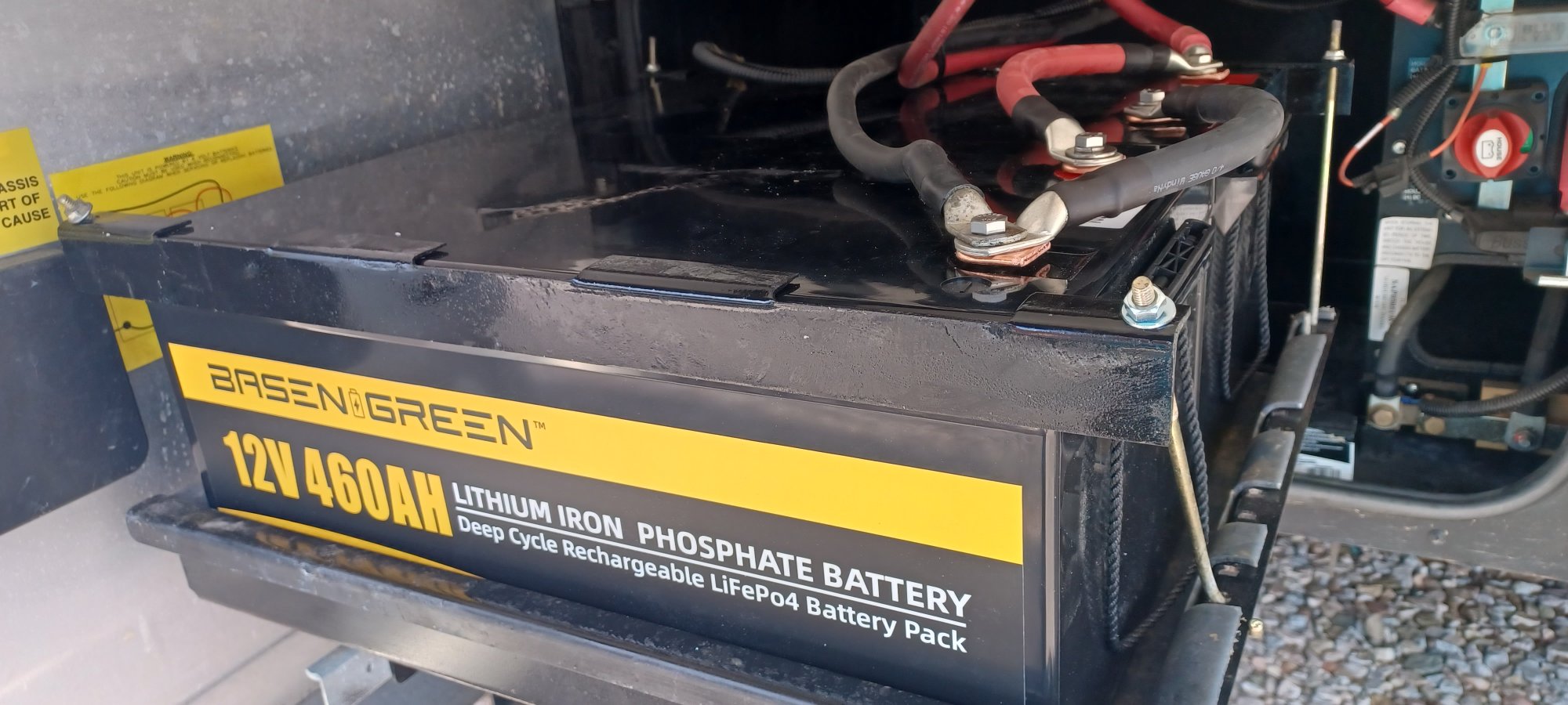

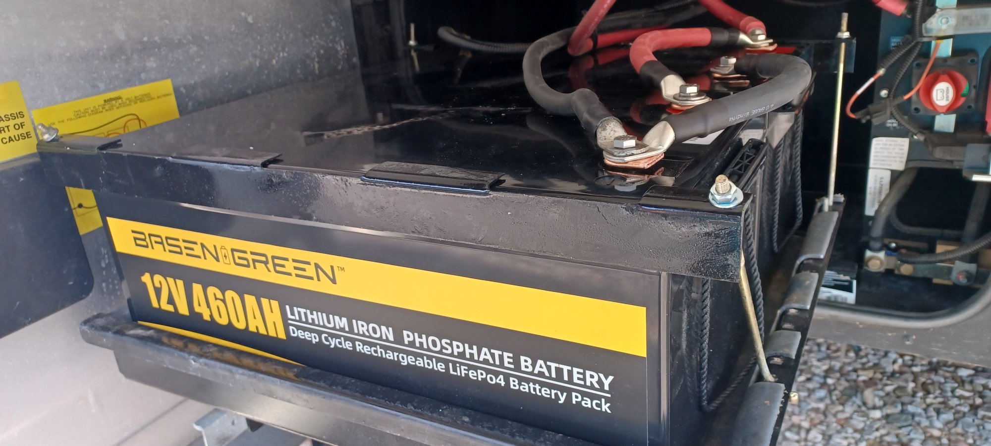

In 2022, I dropped in a couple of 460Ah 8D LFP batteries into my motorhome and have 920Ah total with about 850Ah usable capacity. Total cost including shipping was $2,400. The last time I checked they had dropped in price.
Each one weighed 90-lbs.

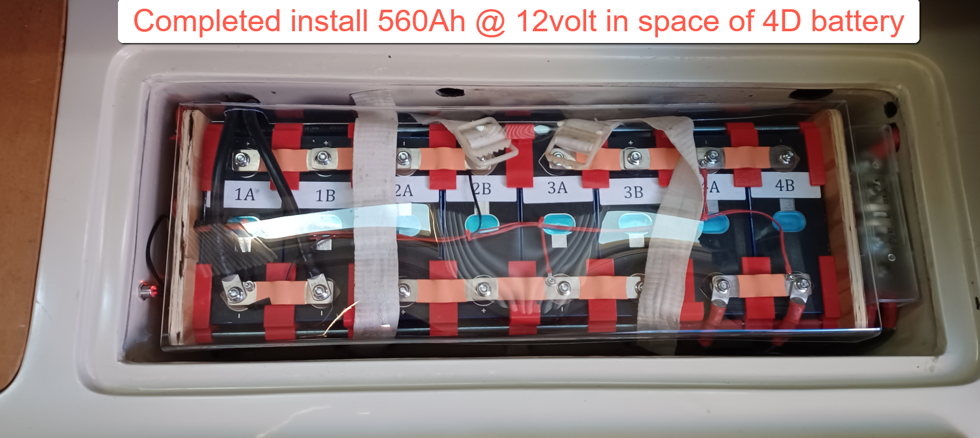

Conversion cost is such a wide-open problem. For me, I was able to drop in my DIY 560Ah battery with no additional stuff into my 1988 C30 so my conversion cost was $1,400. That was the total cost for eight EVE 280k cells @ $150 each ($1,200) plus $110 for the JK BMS and $90 for mics bits and bobs. That gave me 560Ah total capacity in the space that was designed to fit two group 27 batteries. I was fortunate in that 29-years-ago, the previous owner had upgraded the wiring to have an isolated start battery which was on its own master switch and a battery isolator that kept everything seperate but allow the alternator to charge both. He had also installed an externally regulated alternator, so I was all set.
Years prior I had installed a Victron IP22 to replace my old Newmar charger because the Newmar cooked an AGM in less than two years. The IP22 is a great charger that can be fully custom programs to charge any way you want.
I also converted my motorhome from six CG2's with a total of 645Ah or about 322Ah usable to 920Ah of LFP. On it, I did not need to add anything because the factory installed Magnum 2012 has all of the programmability needed to set up the charging. I also do not need to worry about isolating the LFP because Tiffin did that from the factory. I also do not need to worry about limiting the output of the engine alternator because, due to the 90' of wire from the engine to battery and back, it self-limits to 60A current due to the voltage drop. Total cost for conversion was $2,400 for a pair of 460Ah drop-ins.

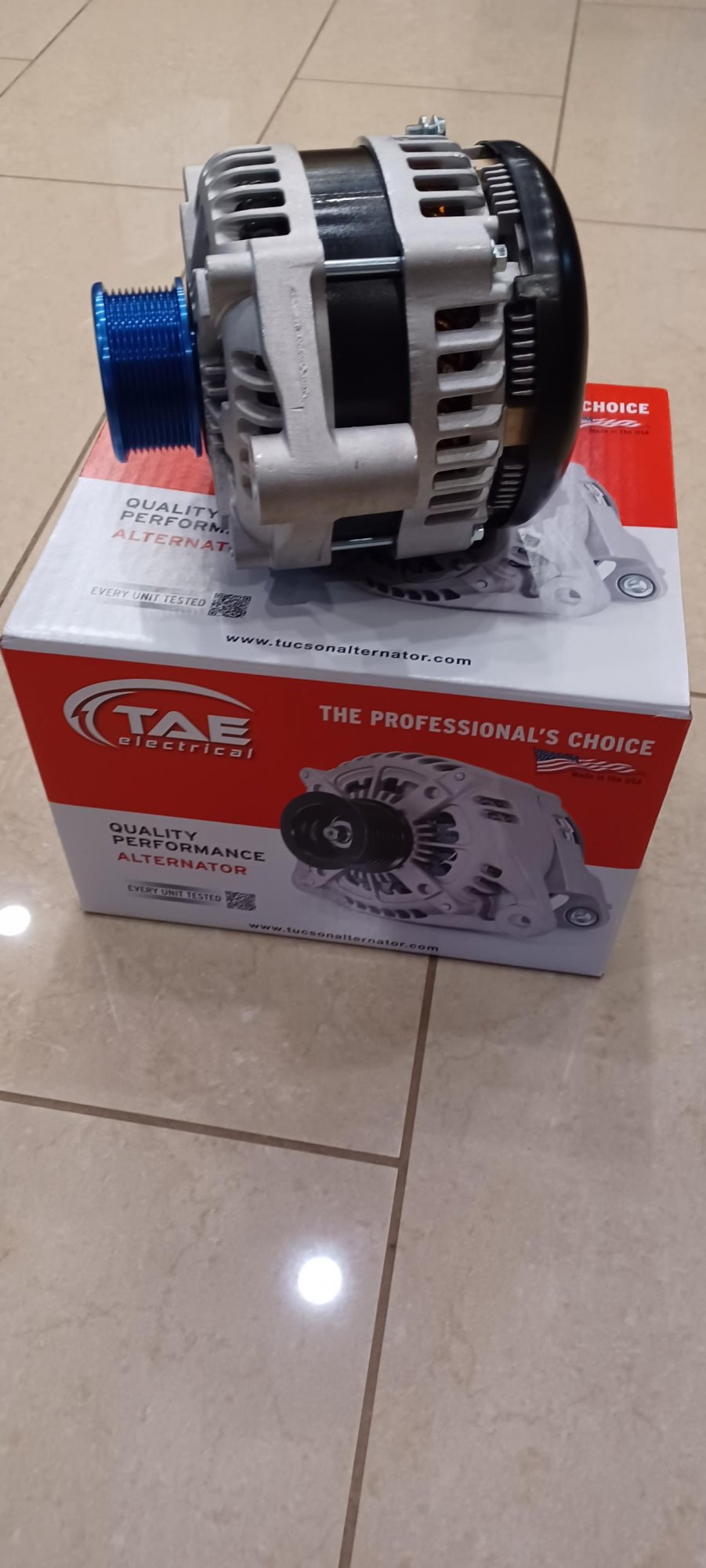

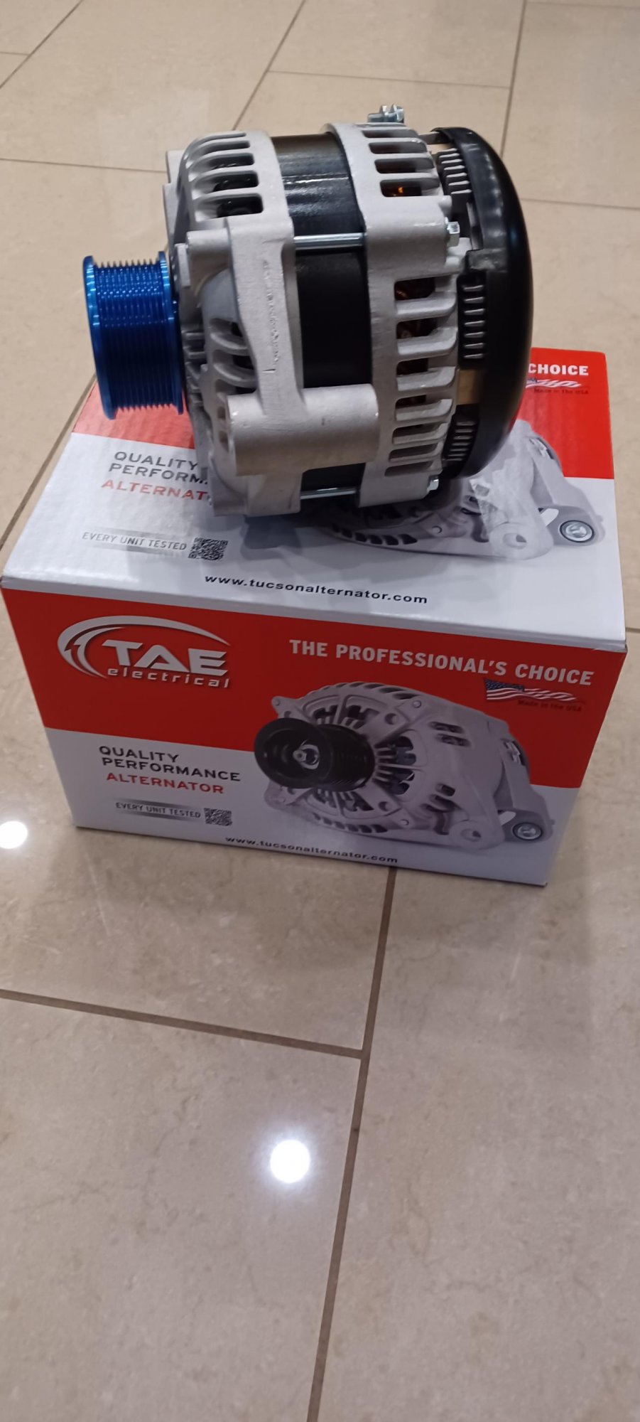

New externally regulated alternator with enough charging amps to take advantage of the LFP capabilities plus belt upgrades, and protection circuit? This is the best option for charging from the engine. My boat came with a 108A Ample Power 108A alternator when I bought it 27-years ago and with external regulation with a regulator that monitors alternator temperature, you can safely and quickly pump as much power as you can make into the LFP. My 108A ran just fine off the stock 3/8" belt.
Alternator & belt upgrade $1200 plus/minus (anyone have a good number for this) I can only speak from my costs. I purchased a 250A large frame Denso Hairpin Stator alternator from Tucson Alternator Exchange who makes high output alternators primarily for the AZ and UT offroad community. Given that they are typically running in rigs in 120º temperatures in the SW deserts, they are built with the highest quality parts to handle the high loads from big winches and huge light bars. This was the lowest output of this build type, and I could have gotten the same case with 400A. I did not get the Pure Power brand of alternator that they sell. Mine was a fully custom build to my specifications and it cost me $375 which I picked up at their shop when I was visiting my daughter. [They do ship world wide but it was nice to meet them.] I also installed a multi-rib belt kit from Balmar which cost $440. I could have run that alternator with my old regulator but it did not have alternator temperature monitoring. for the first years use, I built a simple temperature limiting regulator that turned on at 13.2v and turned of with the battery hit 14.2v. It also would turn off when the alternator temperature got to 90ºC which was very conservative because TAE suggested a cast temp max of 105ºC. The total cost of building my simple regulator was $50 with most components costing less than $10 from Ali Express. That said, this year I am upgrading to the Cadilac of regulators, the Zeus which has set me back $715 on sale. my 35-year-old 23-HP Universal M25XP handles the new alternator just fine. Total cost of alternator, belt kit and simple regulator. $865. Typical output to battery 190A.
Wiring changes to isolate the start battery? $0 for me because it had been done by the previous owner. My C30 came to me with two battery switches, a battery isolator and all primary wires from the alternator to the batteries made with 2/0 wire so I was set for any output up to about 250A.
Anybody have a good guess? ($ start with $500 as a starting point) The AroFET 200-2 sells for about $120. then you need a second battery switch which I see for about $40. Then you will need to add wiring to meet your desired power output.

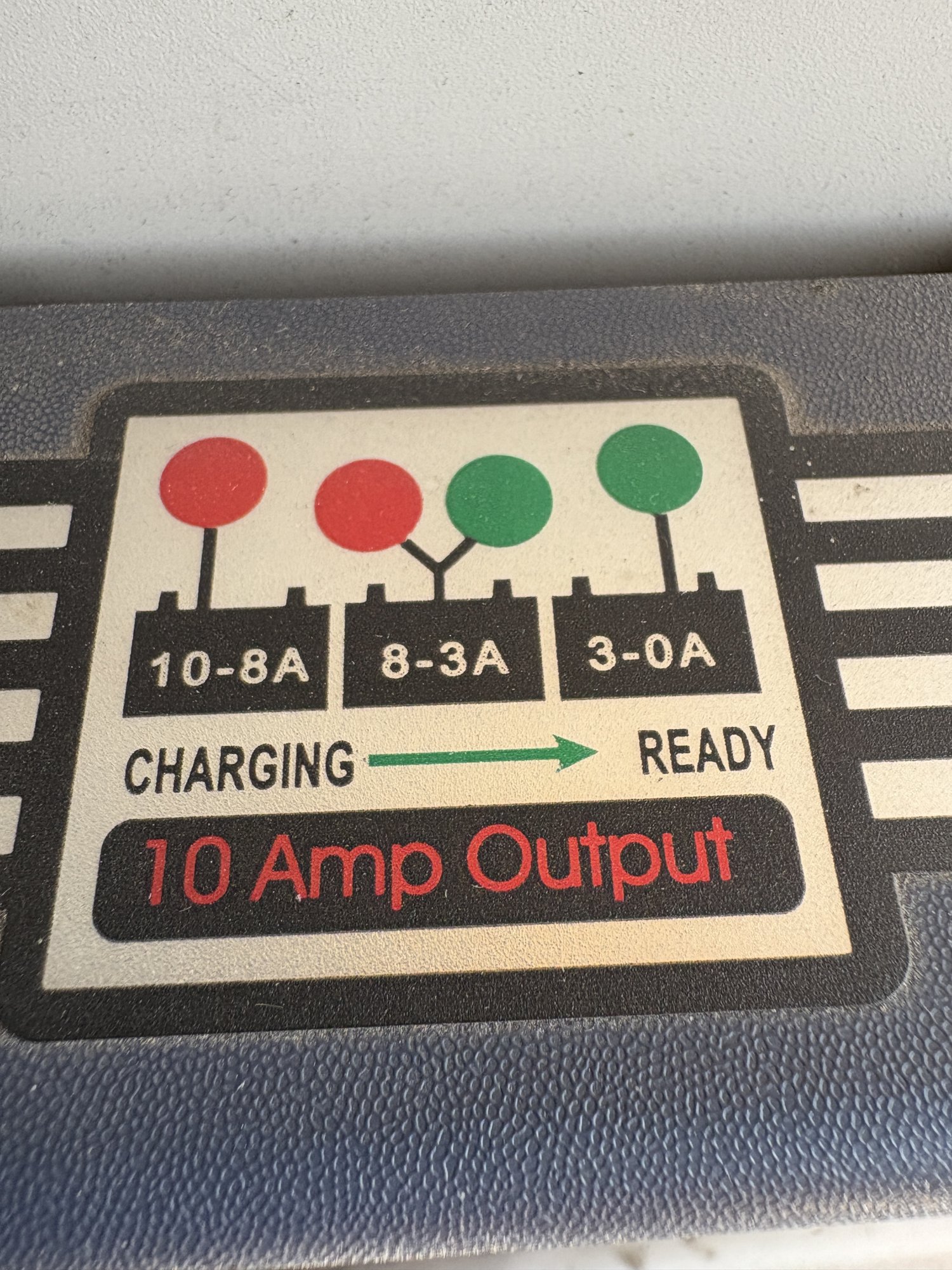

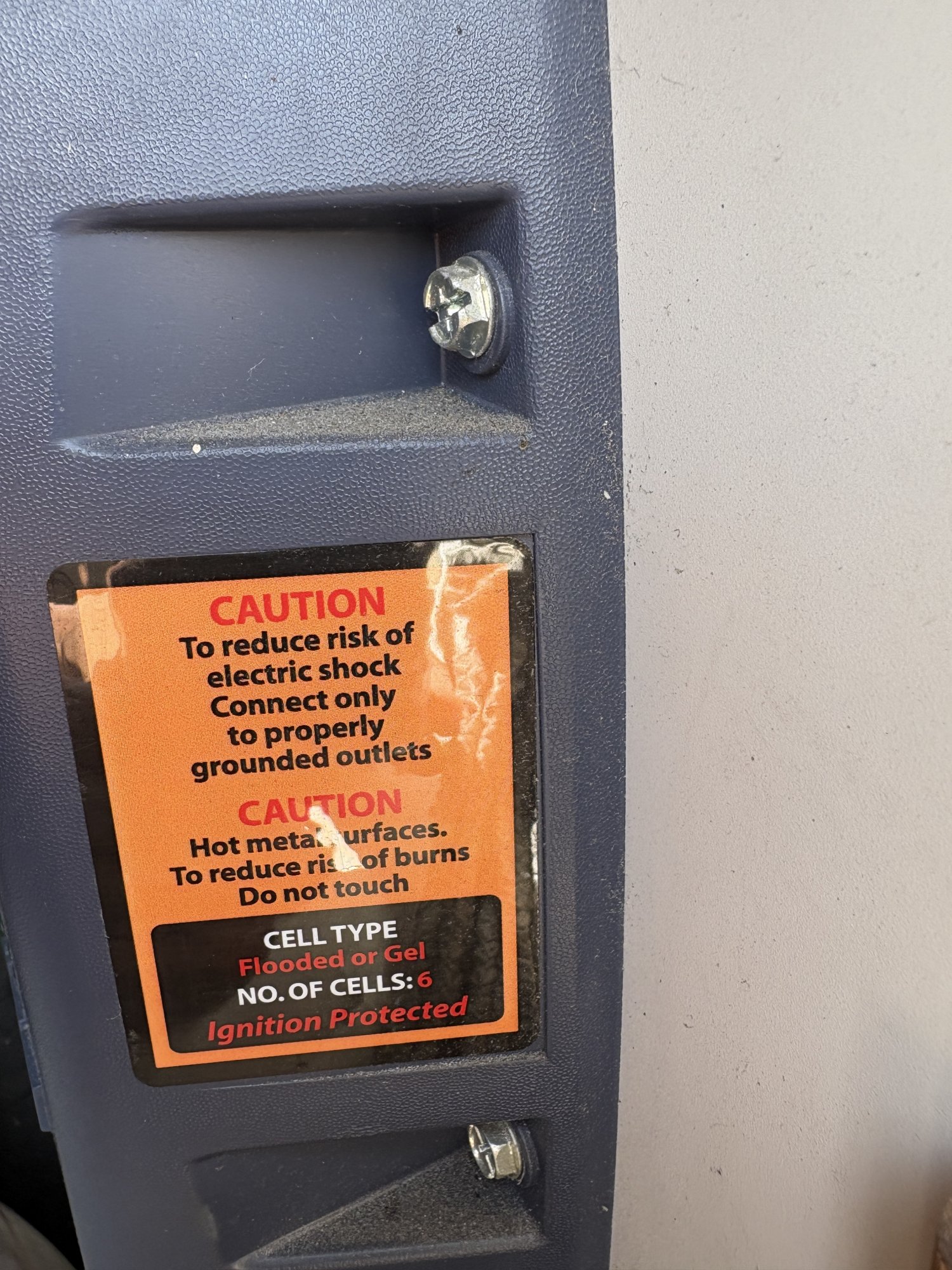

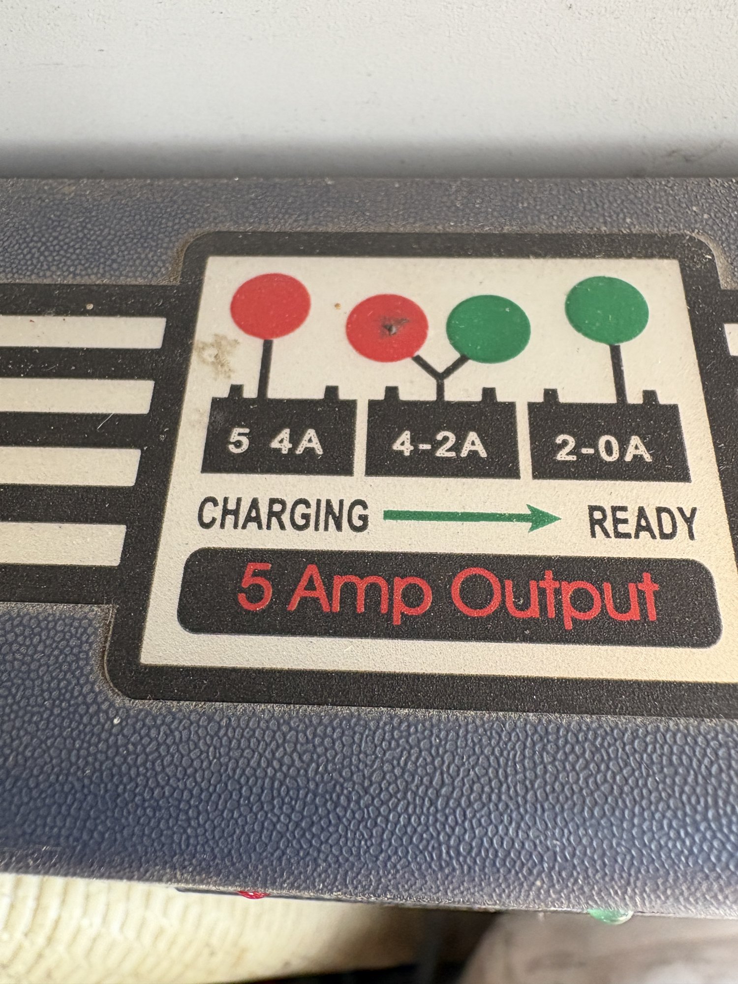

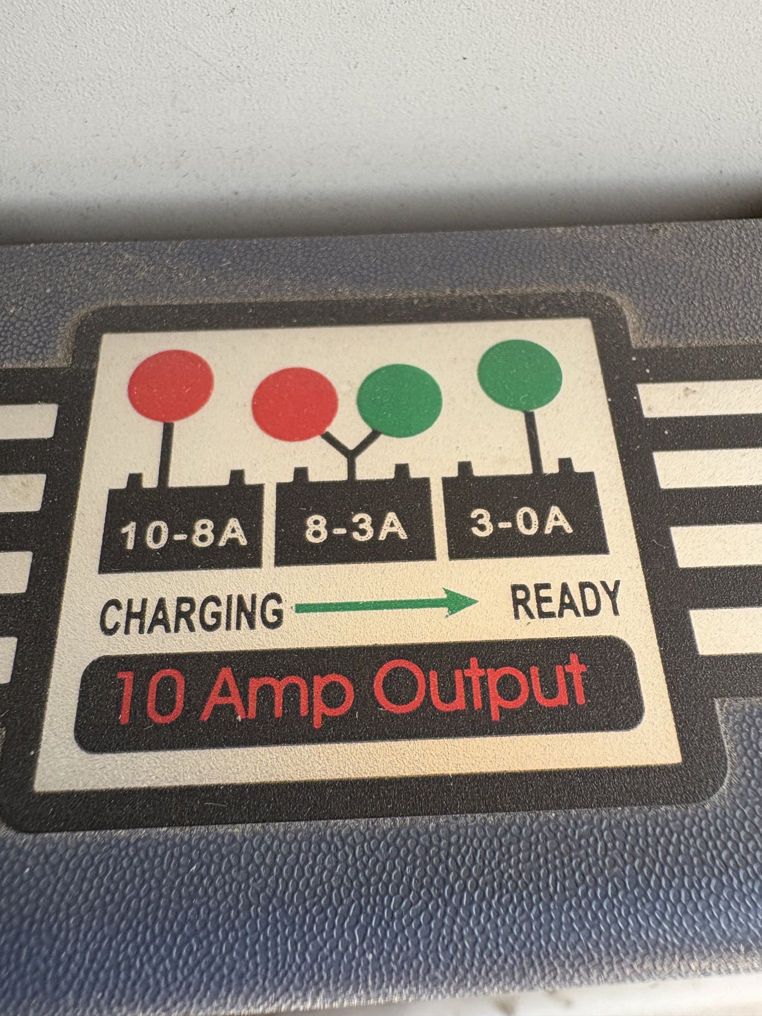

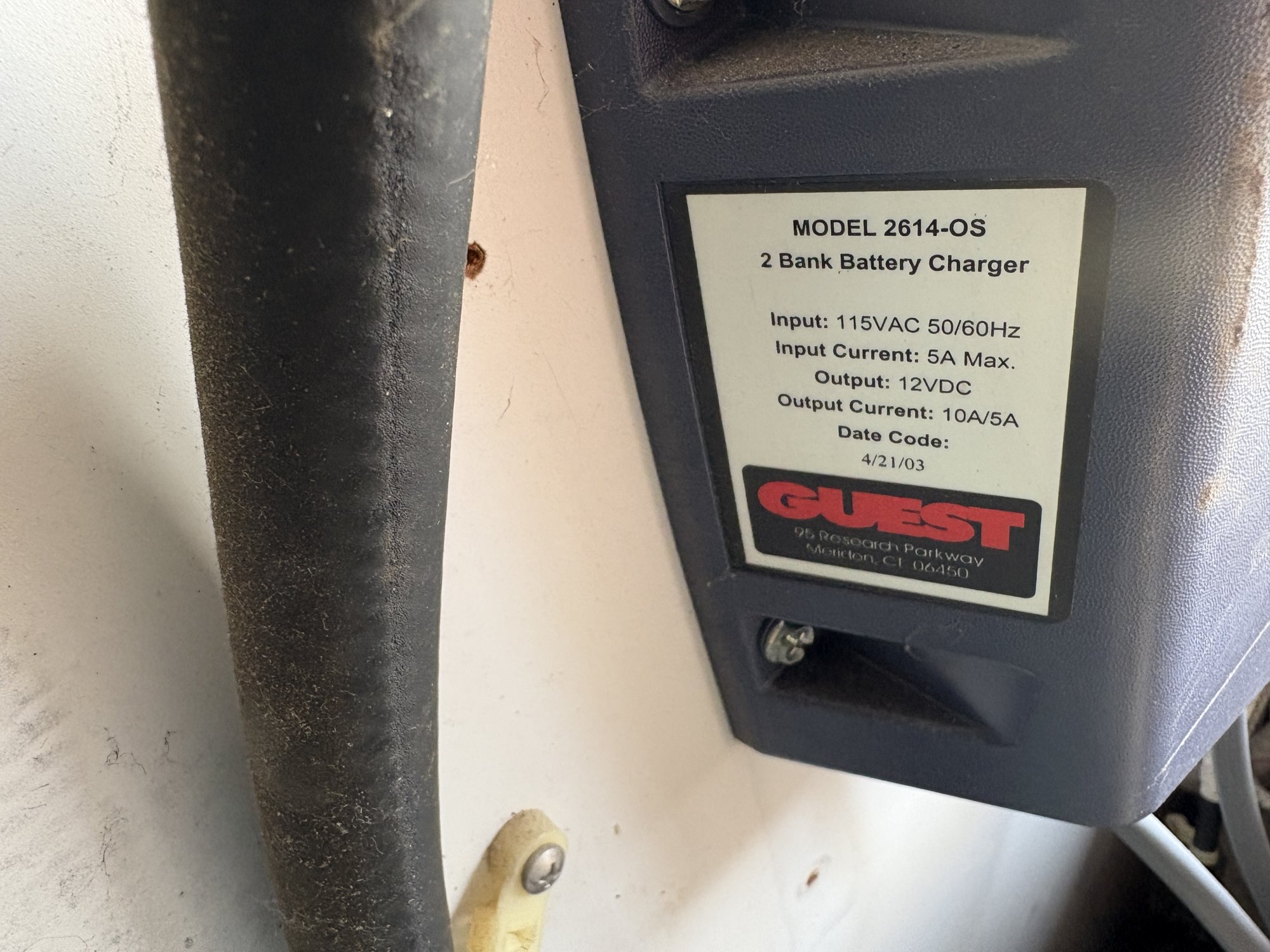

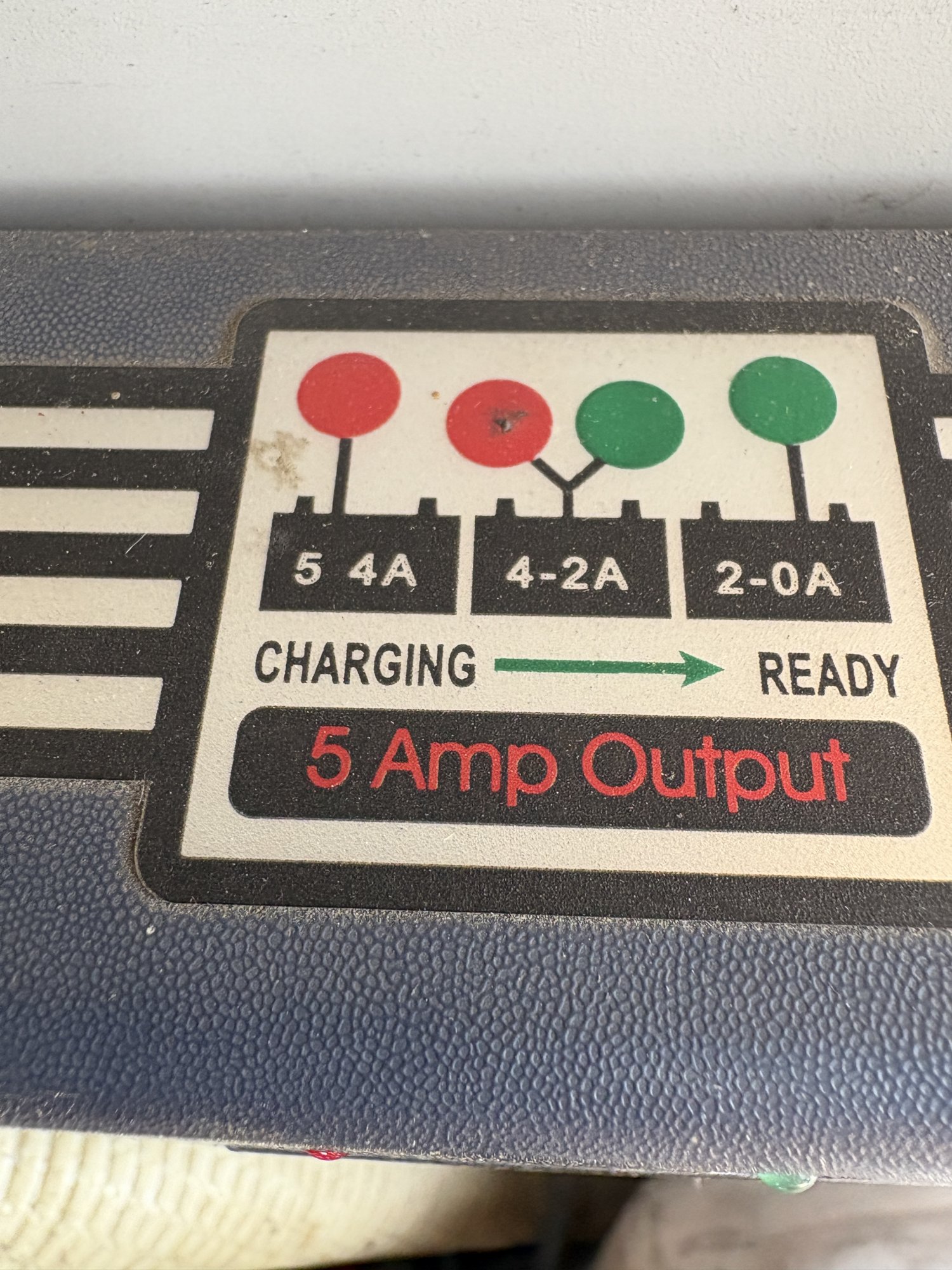

Thanks for all of the comments so far. I was at the boat today and got some info on my old battery charger…
Guest 2614. From 2003. I don’t think that this charger will be good for LFP…
here are the only charging profiles…
On a positive note, my Renogy battery monitor says it would work with LFP.
But at this point, I think I am going the easy route and replacing my lead acid batteries in kind and be good for another 4-5 years.
Thanks for the comments and suggestions.
