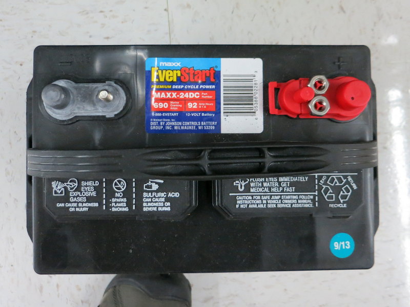

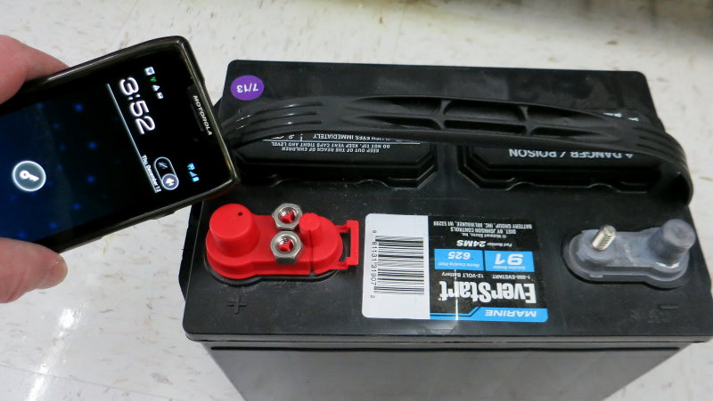

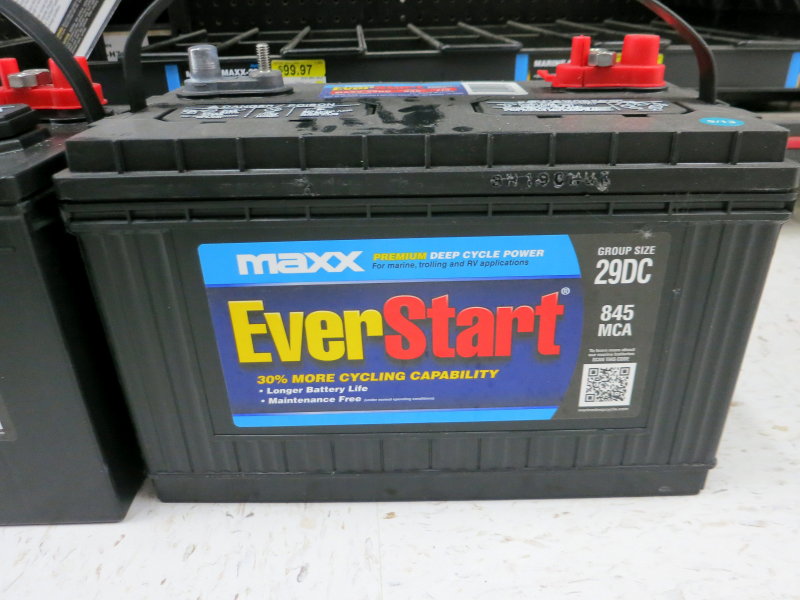

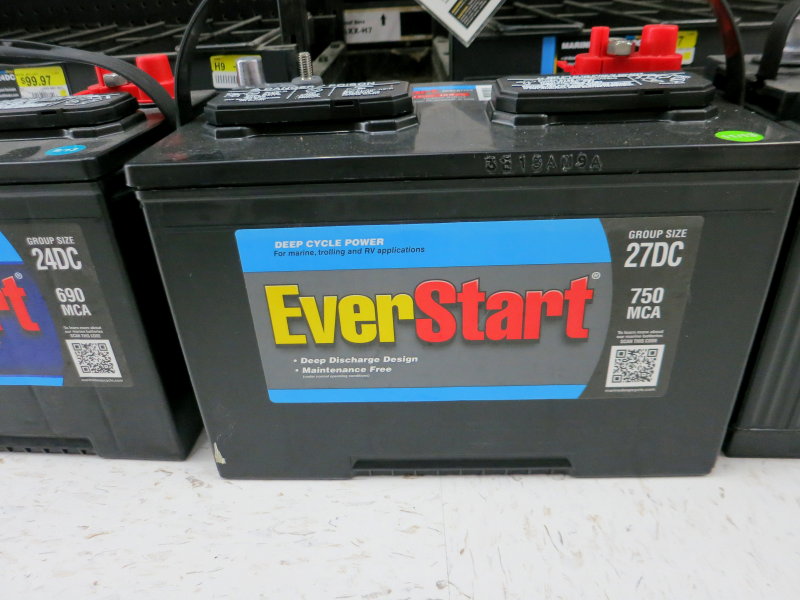

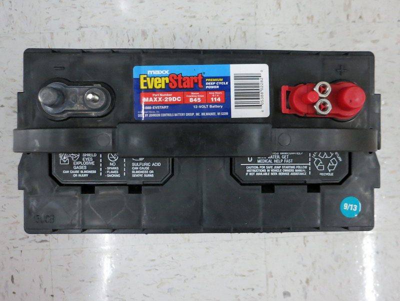

Interestingly enough I got a post notification just as my daughter and I were walking into our local Wal*mart... these photos were taken at approx 3:52 PM today, December 12th at Wal*Mart in Falmouth, ME....
All of these batteries are made by Johnson Controls, & labeled for Wal*Mart. They have the Wal*Mart in-house brand label of EverStart ...
G-24 Marine Starting 7/13 Date Code
G-29/31 Deep Cycle 9/13 Date Code
G-24 Deep Cycle 9/13 Date Code
G-27 Deep Cycle 11/13 Date Code
Close up of post cover design:
Front of a G-27 DC
Front of a G29/31 DC
G-24 Marine Starting 12/13 Date Code
G-24 Marine Deep Cycle with old label 7/13 Date Code
Damn now I have to go all the way back to walmart and get pictures for you and learn how to post them on top of it. I suppose next you'll make me find a marine mechanic institute graduate with a huge snap-on dale Earnhardt commemorative tool box cross threading a wing nut with his 80dollar wing nut wrench.I knew I shouldn't have commented on a thread you started no matter how ridiculous the subject matter. I am glad to see you are common sense when it comes to recommending battery brands to uninformed owners who tend to think the most expensive agm-gel-li batteries must be the best when in reality costo and walmart battery's will 9 out of 10 times be the most efficient battery to use both economicaly and performance wise. Kudos to you for that at least.

I bought two of the group 29DC batteries last week from walmart. (these are not pictured above) They were only $82 with the trade in. I bought the one that did NOT say "premium" (pictured above) because it had more amp hours than the 29dc that was labelled "premium with 30% more cycles". I am trying to put three or four of these in my house bank, but they only had two at the time. I am replacing an old four battery house bank that had battery plus batteries. My onboard charger, original equipment, is at fault for ruining the old batteries. I am currently trying to rebuild energy production and storage system on my boat. Wow there is a lot to learn. That is why I am trolling the forum, reading Don Casey (who sold me on the flooded batteries), Nigel Calder (who seems to favor Gel Cell), and maine sail's DIY site.
Who could explain why the "premium with 30% more cycles" had fewer amp hours than the cheaper version. They were both the 29DC group.,

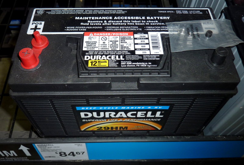

I don't see the amp hour rating on that battery Maine Sail. I can't buy it because in Don Caseys "This old boat" he says to "bypass any battery that does not list an amp hour rating" (i don't have the book with me right now but it is something like that);)
I note that the battery is labeled 29HM, how does that differ from the walmart 29DC?

The Ah capacity is 105Ah at the 20 hour rate. The 29HM is the same battery as a West Marine deep cycle 105.... If you know what you are looking at some batteries that don't display Ah can be a good value if you know where to look for that info... I agree with Casey that "in general" you don't want to buy a battery without a 20 hour rating but some relabelers tend to omit this data even though the batt does have a 20 hour rating.. The Duracell 29HM is also the identical battery to the Deka DC31DT.....
The current Wal*Mart batteries have JUNK specs, in terms of Ah capacity, that are meaningless and no one at Wal*Mart has been able to get me the correct 20 hour rate..
