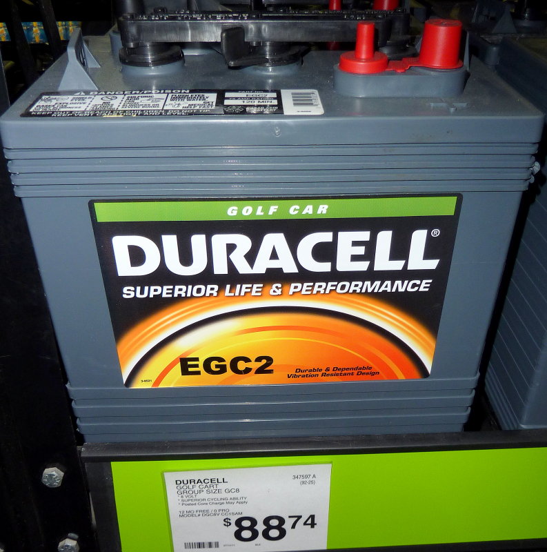

We used to have the Energizer/JCI batteries but I am darn happy we now have the Deka/East Penn batteries.... Not all clubs have the Duracell/Deka/East Penn product and some apparently still have the Energizer/JCI product.. Could be regional?
If it is an EGC2, is gray in color, and looks like this:
It is made by Deka/East Penn, not Johnson Controls Inc..
