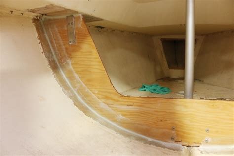

Tabbing is strips of fiberglass cloth that bonds one object to another. Very simple. Your C22 has tabbing between different parts of the hull. You want something stronger than a typical adhesive as you're dealing with a 40lbs object filled with acid, lead and will happily act as a welder when shorted.
I've used 1" wide ratchet straps in the past. I put it on, then cut the long tail off. Take a lighter to the end so it doesnt fray if you'd like. Bungy cords wont stop a battery from flying if you're healed over enough
Tabbing here is done with a simple strip of fiberglass cloth to join the wooden bulkhead to the hull
