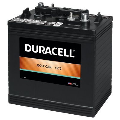

Duracell 6 V Golf Cart batteries, size GC2. Four. I installed them in my boat in Sep 15 and they've been just great.
  • 20 amp hour rate:215
So, in a series/parrallel installation you have 430 Amp-hr available at 12 VDC
Much easier to get in and out than those huge 4D batteries - and true deep discharge.
More info here: Battery Upgrade
Did these as well about 5 years ago. Have never had a problem. I believe they are made by some brand Mainsail recommends (Deka or East Penn?).
