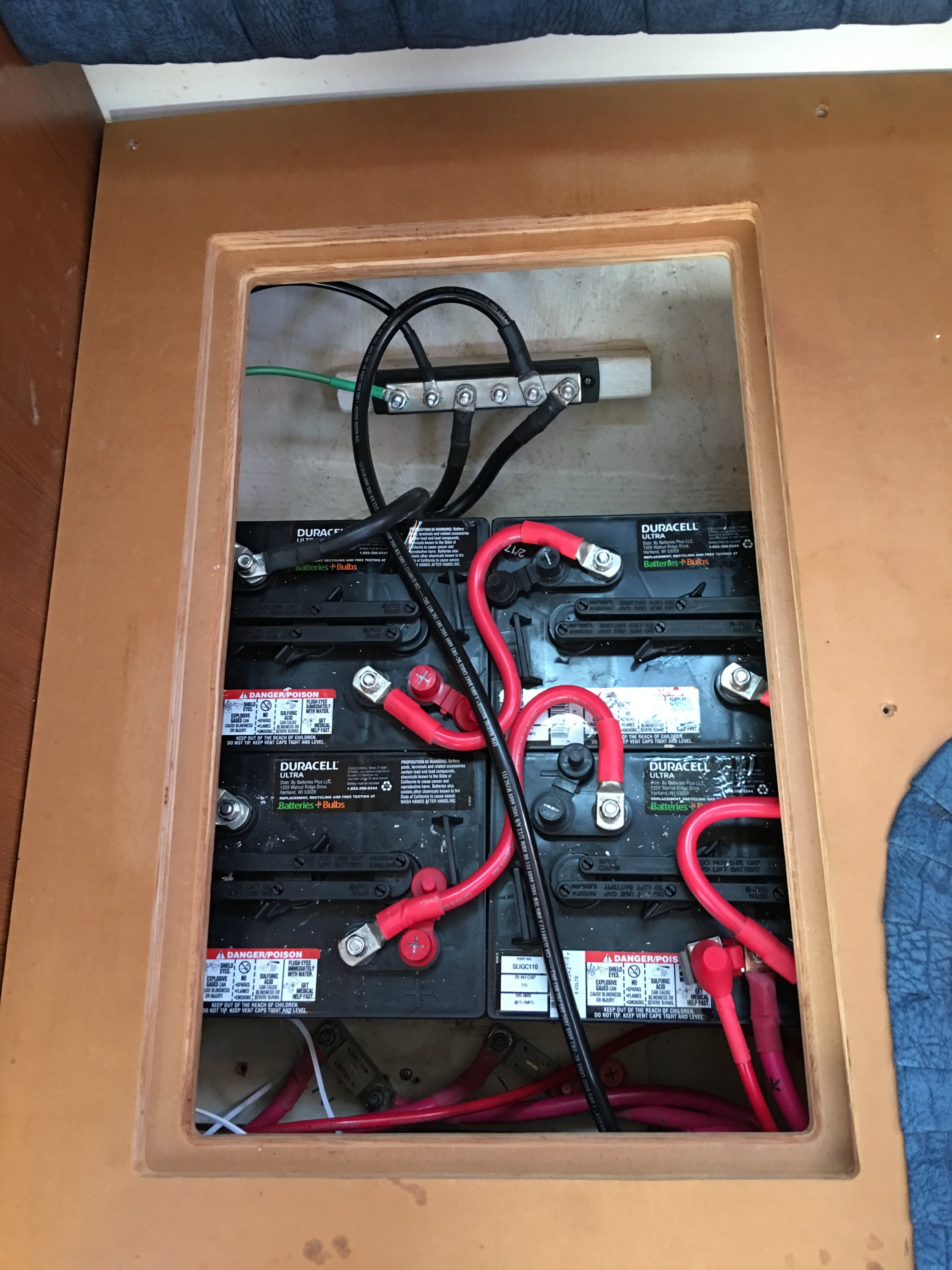

I went with 3/8 bolts on a shunt for cables from the battery to a 250A 5/16 x 6 posts for the bigger ground cables (alternator, charger, engine,DC panel, ACR's) - small wires connect to either a 6 position fuse panel for 24x7 or are grounded at the DC panel.
Having lots of room for bigger cables will reduce the temptation of sneaker wires getting in after the shunt.

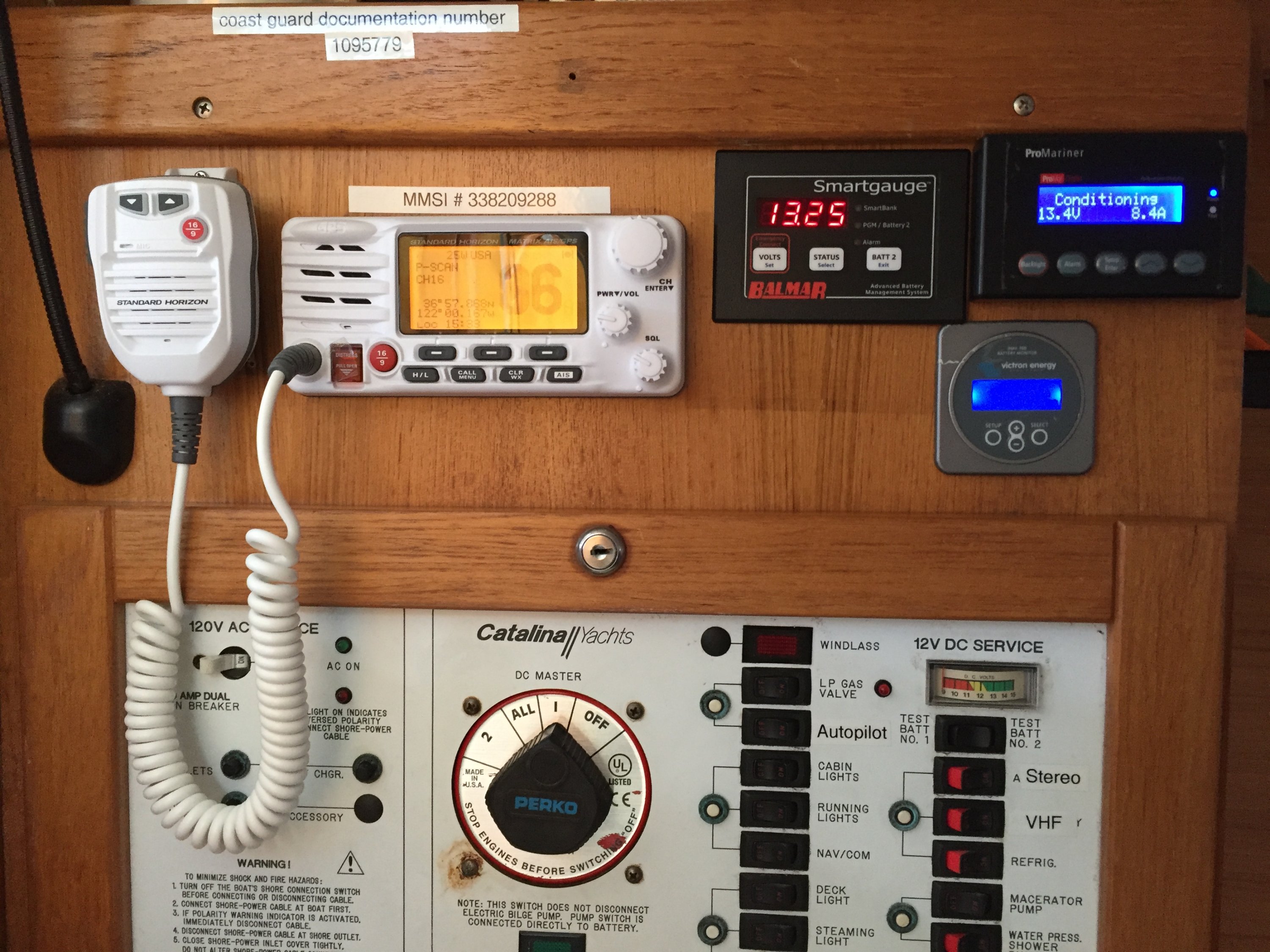

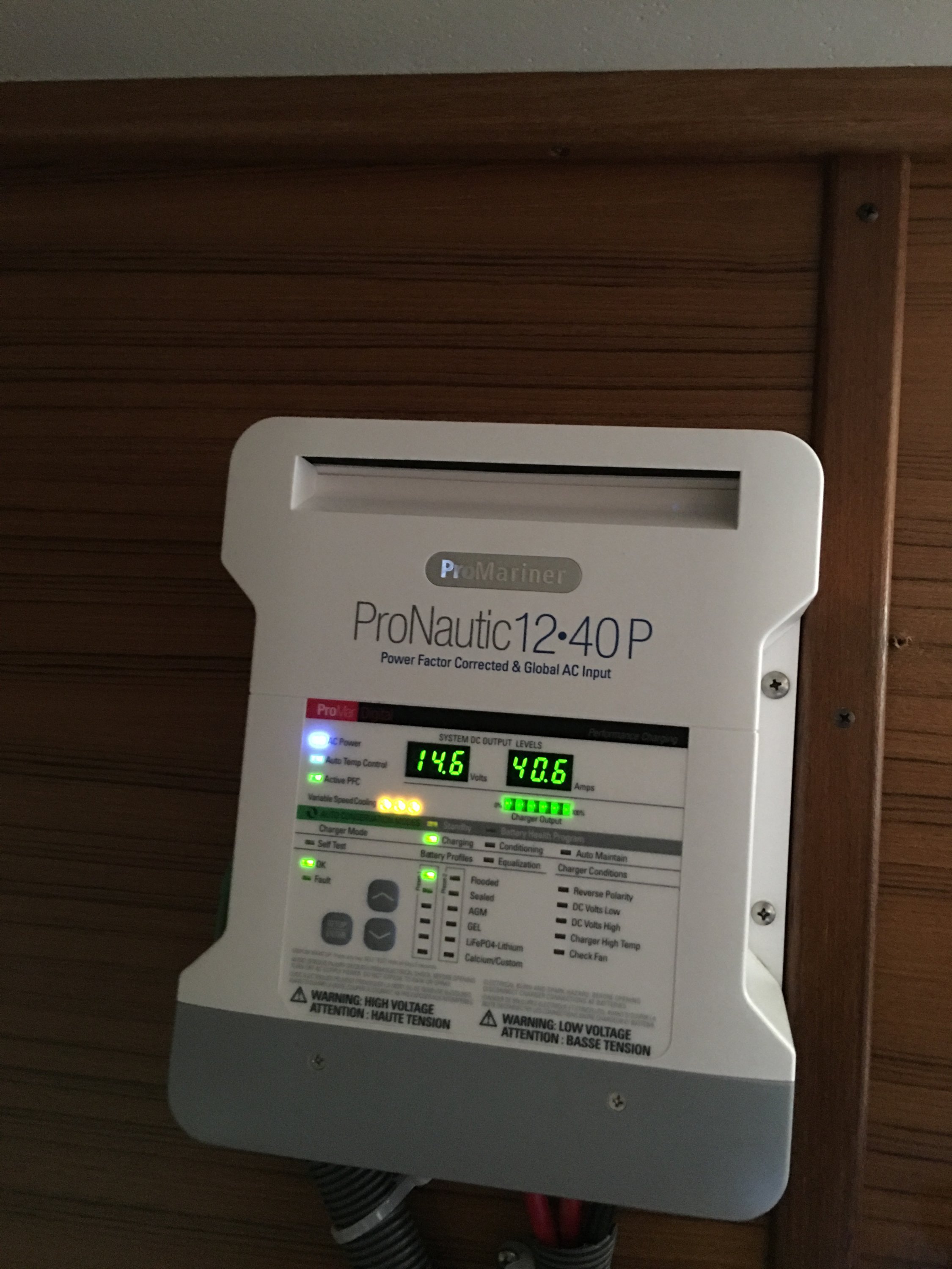

Well... it's finished. Thanks to all who put up with my questions and especially those who overlooked my slow learning pace and kept offering advice. All seems to be working properly and tonight I will not dream of wire size, voltage drop, and house load... thanks again.
Neal

Neal, congratulations! Two questions: are you strapping down the batteries, and is there a tray under them?
Also interesting that your seat is wood. Ours (2000) is fiberglass with a wooden cover/insert.
