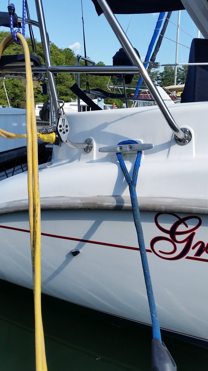

The head vent on the H340 is on the starboard side hull as shown in the attached picture, and is likely the source of the temporary odor when flushing. The holding tank is under the battery compartment. Listen to Peggy to minimize!
