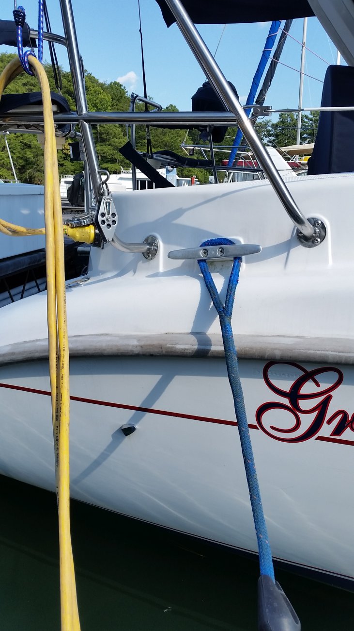

The head vent on the H340 is on the starboard side hull as shown in the attached picture, and is likely the source of the temporary odor when flushing. The holding tank is under the battery compartment. Listen to Peggy to minimize!
That's logical, but if you smell it inside the boat there's an issue someplace. The vent in mine is amidships port side, and if the wind's just right I get a whiff in the cockpit when flushing. Too much or too little wind and I don't notice it. But not inside the boat unless it's somehow coming in a hatch, that would have to be a very occasional occurrence. There's a leak someplace, probably in the vent or pump out, somewhere above the fluid level in the tank. It was below you'd smell it all the time and probably see the leaking fluid.
