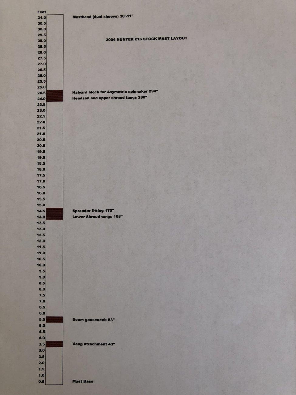

Just curious as to where on the mast are you considering mounting the tangs?

For me, if I go with the running back stays, they’d be mounted 4’ above the upper shroud tangs. About 2’ below the top of the mast.
For you, because you have the stock spinnaker setup, I’d get another set of shroud tangs and a slightly longer through bolt, then just double the tangs up on the bolt. The inner tangs would attach to the upper shroud as before and the outer tang angled slightly aft would be the running back stay connection. $20 and no additional holes in the mast. This setup would be beneficial to upwind performance as well as the running back stay in this location will also be able to control for stay tension. There was a thread or at least a post about someone adding runners to a 216 before. I think it was Paul Walsh who owned the boat A Little Nauti but according to his last post in 2011, he sold the 216 and got an S2 7.9 and has not been active on this site since. He did a few good write ups about getting some good performance out of those boats.

I’ve not seen mast layout dimensions before so thought I would post this for reference.
I wasn’t really thinking about them as a stay - sail tuning aid, just added support when flying the spin, if that is what you mean by ‘stay tension”. I’m used to using a masthead backstay to alter sail shape but I can’t visualize how I could induce any mast bend with the attachment point that far down??

Runners at the location where the forestay meets the mast will help with head stay sag for better upwind performance in heavy air. I know their primary function will be for additional downwind support under spinnaker, but you might pickup some upwind performance as well.

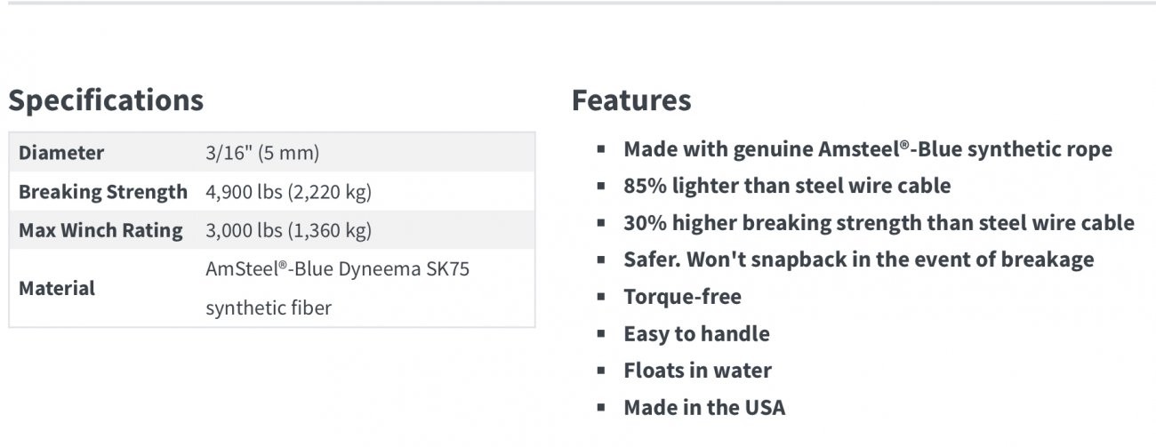

I just ordered 100' of 3/16 amsteel blue rope for my runners. I probably could have gone with a smaller diameter line though.

Doesn’t look like the rope will be the point of failure with those specs. That is a LOT of sail on that 240!!
