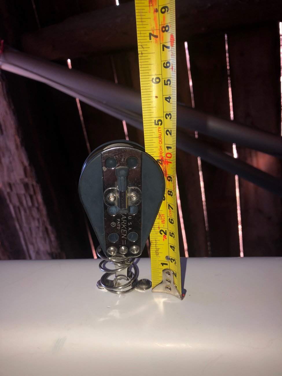

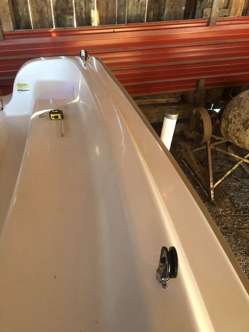

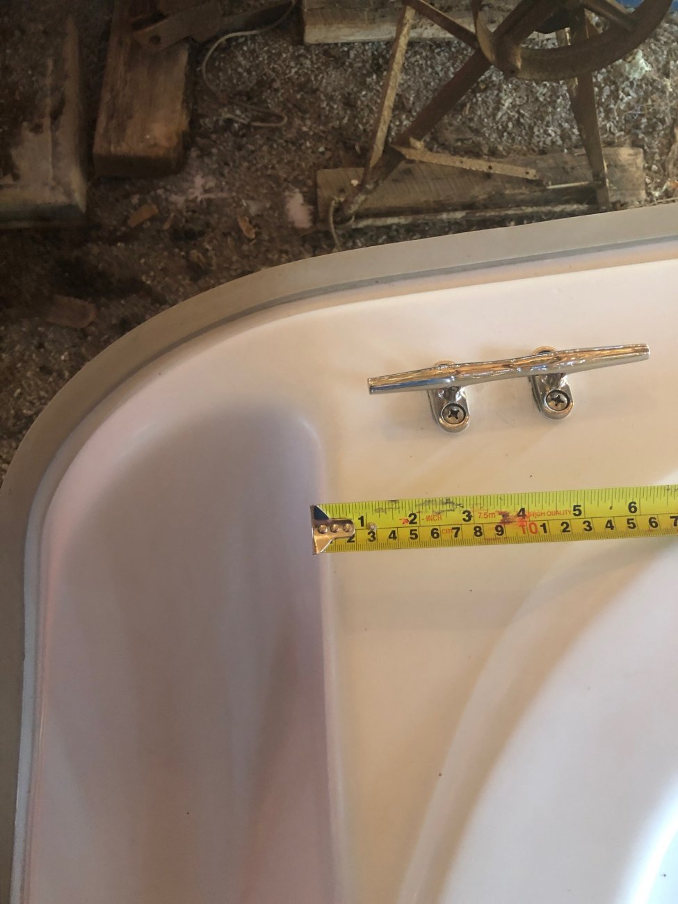

I went to check my boat today and took some measurements of the spinnaker blocks. The photo with the dock cleat is the reference point I used for the measurements.
The aft block centre is 19-1/2 inches from the stern and the forward one is 91-1/2 inches.
I checked under the seating area and there are NO backing plates on my 2004 hull for these blocks or for that matter the docking cleats. I initially assumed they were just secured with screws perhaps through the area where the hull and topdeck were fused together but there may be pieces of wood between the inner layer of glass and the outer layer of Luran (where the foam would be) based on Crazy Dave's comment that wood blocks were used in strategic areas during construction. Hopefully

Thanks Hunter216! I’ll use your measurements to mount my blocks. I’ll drill a small pilot hole and if I get wood shavings I’ll them with screws like yours. If I get foam I’ll go through and use a bolt with a backing plate and perhaps over drill the hole and fill with plexus first to keep everything sealed up tight. It’s going to me a few more months until I get working on my boat so everyone will have to stay tuned for further updates.
