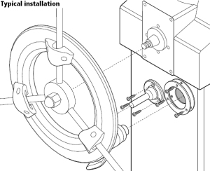

Has anyone installed the newer Raymarine EV-100 wheel autopilot kit in a Hunter 280 or similarly configured mid-size Hunter?
I'm getting ready to do this and I'm wondering about the best locations for the various components (compass, computer, interface & control head). The 280 also requires the Raymarine "box pedestal kit" in part because otherwise there's not enough clearance to mount the motor and clutch on the outside of the 280's box pedestal. So I'd have to drill ~ a 2" hole into the pedestal to insert a "motor tube" that houses the motor and clutch. I'm just not sure if there's sufficient clearance inside the pedestal---e.g., exactly where are the steering wheel cables located? Before I start removing the top of the pedestal (not a small task), thought I'd ask if anyone out there has already done this or knows how the inside of the pedestal is configured. To make sure this can work with an H280 w/out significant modifications.

Greg, thanks so much for sending this, very helpful--and reassuring. Looked at your video and I can't see exactly where the motor tube was inserted into the binnacle--was it closer to the starboard side of the wheel, as shown in the attached pdf from Raymarine? And it looks like your autopilot was connected to your wind transducer--do you recall if that was one of the older Raymarine wind systems--think it's the ST60 series? That's what I have on my H280 and I was wondering whether I'd have to buy a newer transducer to communicate with the autopilot.

Matt I am assuming you have the Bulkhead/Pedestal kit. There are 2 parts that you will be attaching to the pedestal. The hole and the trim piece, and the post (this keeps the frame in place so the wheel belt can rotate the wheel).

Yes that's what I'm planning to get---the box pedestal fit kit. I was just wanting some confirmation before ordering everything that the H280 has the clearance needed inside the binnacle, and nothing vital is in the way. From Greg's set-up, it looks like it's definitely doable.

Yes, the motor tube hole was on the starboard side of the pedestal.

A couple of points, the EV-100 is SeatalkNG only, while ST60 is Seatalk only. Check to see if your MFD can do the conversion otherwise you need to get the Raymarine stand alone converter. Next, since you will have to mount the motor inside the pedestal, I do not think you actually need the center pin. I would just cut a hole in the pedestal for the motor and that will hold the autopilot steady while the wheel is turning. It will make it simpler and neater.
I would want to ask the Raymarine Tech about that. There is a lot of force in the rotation. This would put that force on the motor. It might affect the motor bearing, threaded fitting and gears. Individually they would wear. The bar fitting is solid and it handles all the force used to handle wave and boat forces on the helm/rudder.
Raymarine would be best aware of this issue.

Did your installer use the center pin or secure the motor some other way to the pedestal?
This is a 3-4 difficulty to DIY. Good instructions. You just need to plan out how you want to wire it, and locate the boxes in places where you can get to them but are not in the way.
The sensor magnetic sensitive and needs to be free of nearby iron, electric, or magnetic sources. I understand you can get an iPhone App to help you find a safe space.
You need to fix the wheel. The "center pin" as you call it fixes the back portion of the wheel unit so that it does not spin. This frees the helm wheel to spin and provide steerage.
Not a big deal. You drill 4 holes, tap the holes, screw 4 short screws into the pedestal. No muss no fuss.
