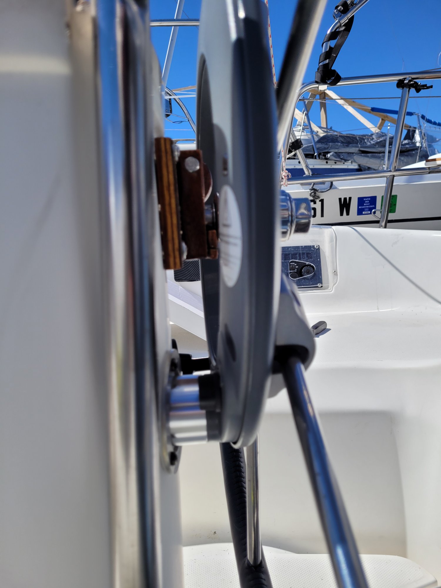

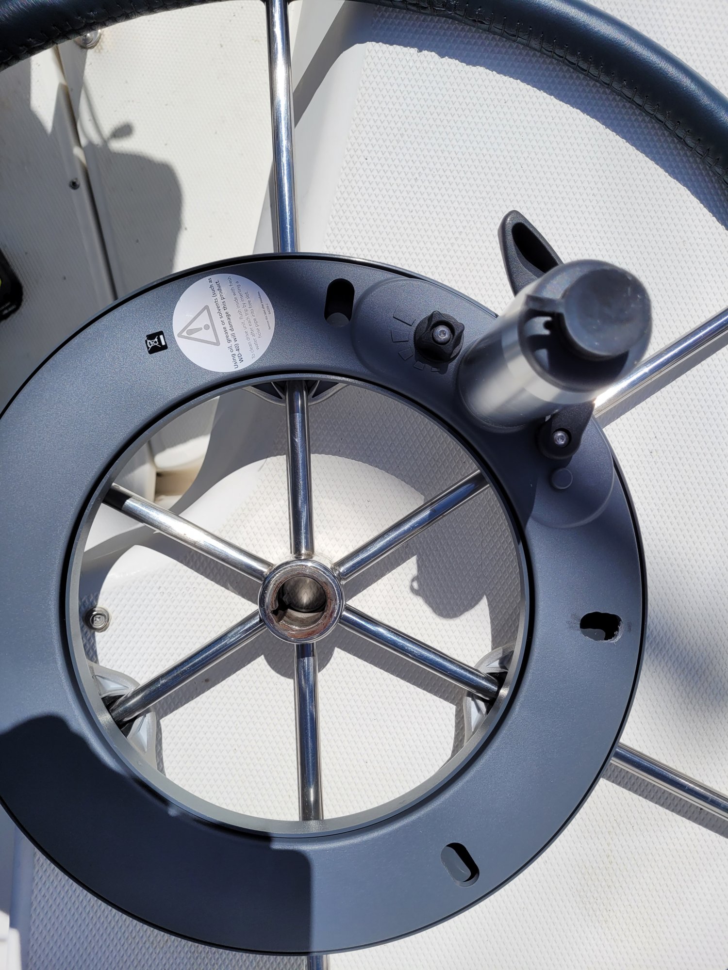

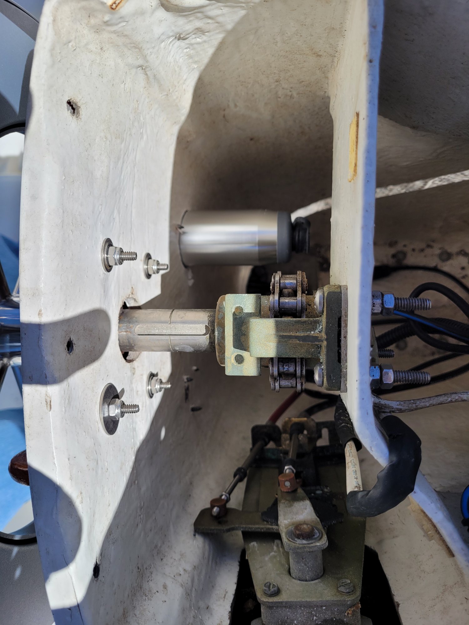

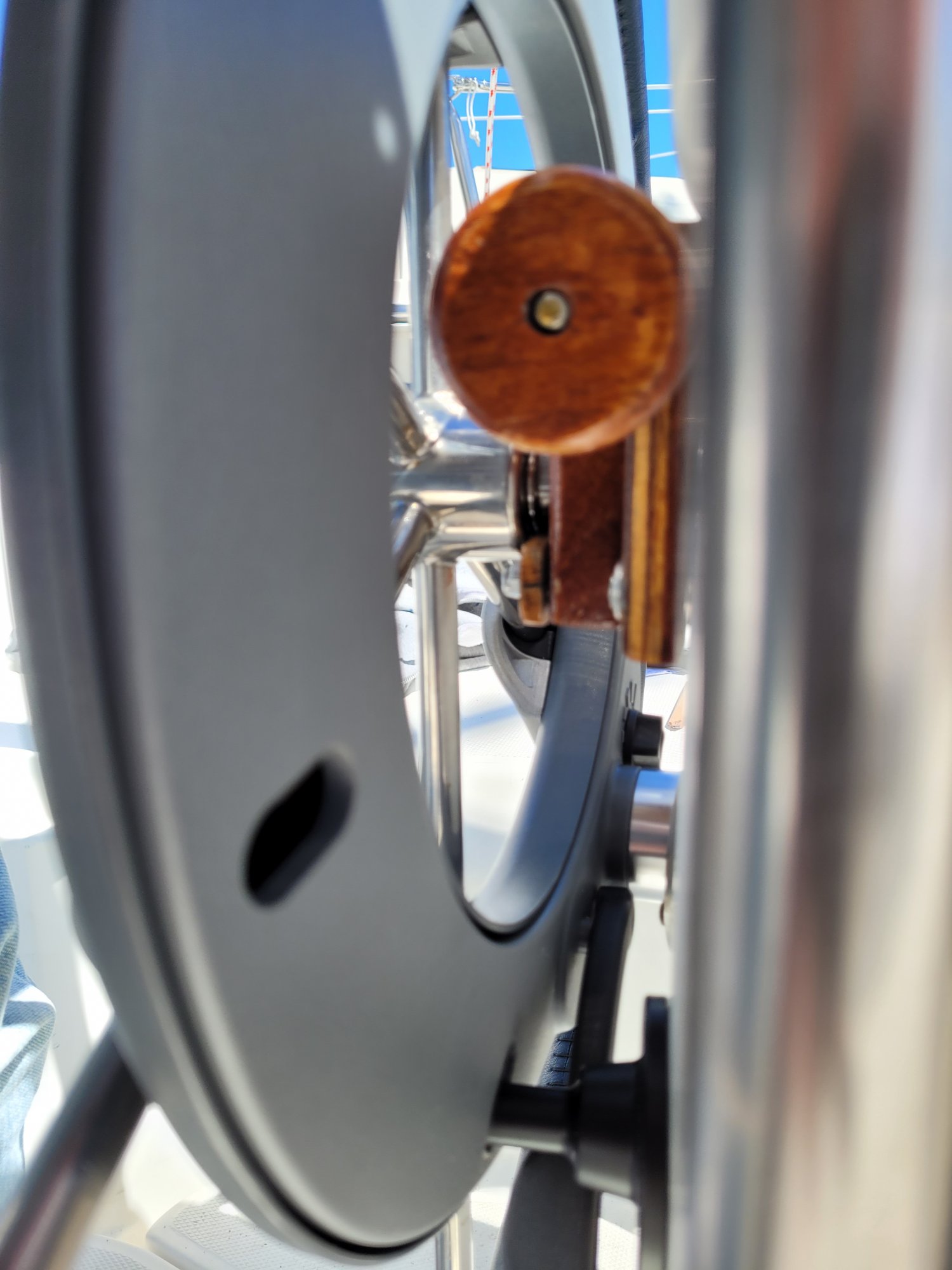

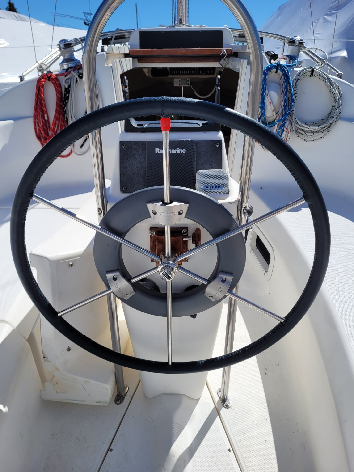

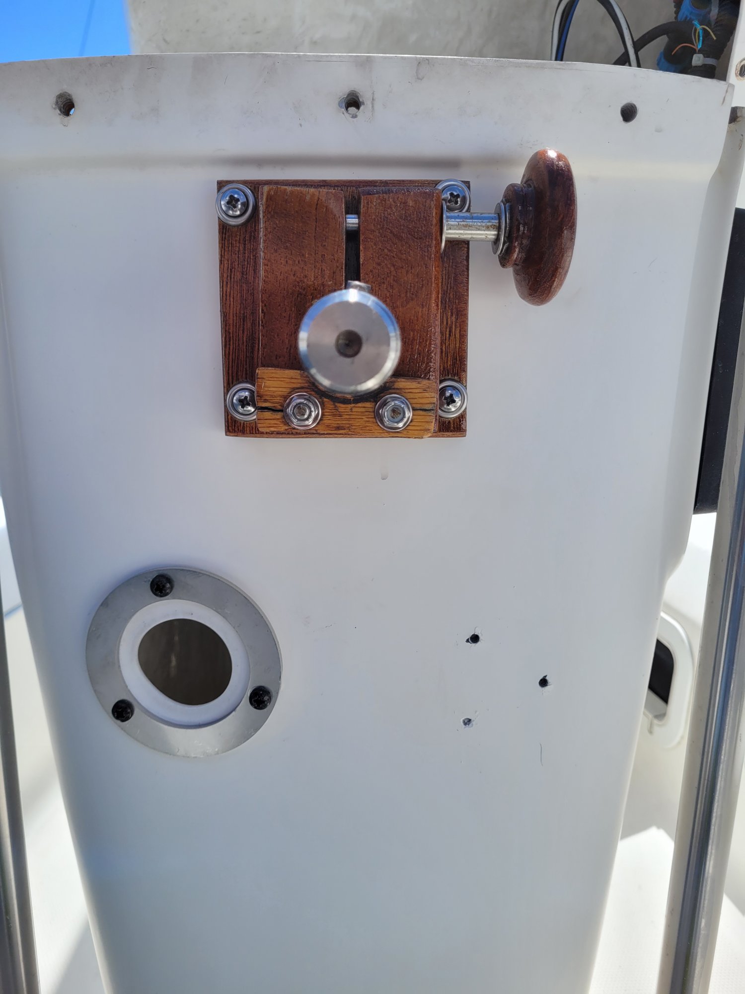

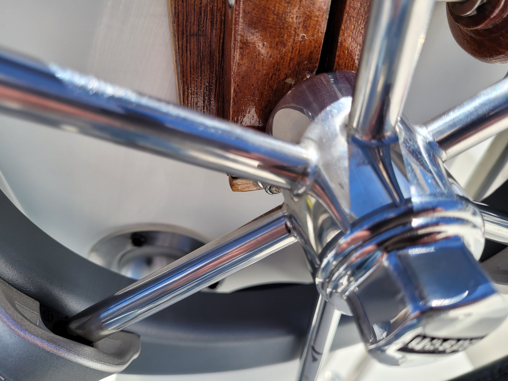

Here is some detailed pictures of the ev-100 wheel unit on my Hunter 280. Placement of the motor drive on the port side simplified everything thank to RHiggins idea of cutting a new pin hole on the plastic of the housing. I mounted the EV-1 unit forward under the V berth near the water tank. The ACU was mounted on the wooden bulkhead in front of the black water tank. System installed and works great!

Very nice! I like:
A) that leather wheel cover
B) the wheel brake
Did you add those yourself?
Apr 15, 2018
12
Hunter 280 280 Portland, Maine
The wheel brake was on the boat, clever design and works great. I replaced the wheel cover over the winter, bought the cover from Boatleather, easy the install and so comfortable. i built a simple jig to hold the wheel while sewing. Nice winter project.

mine was a bit tight when first removing the top of the pedestal. it is just held by the screws around the joint. after removing all the screws tap up with a block of wood gently around the seam. See my earlier post with pictures on my installation. placing the motor on the port side of the pedestal lots of room however you need to make a new hole in the wheel backing plate for the pin. good luck.
