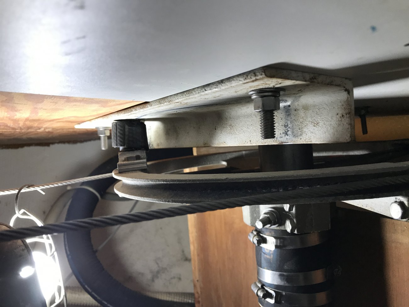

one more photo. This is the stopper angle iron. It's not in this picture, but I had to add 3/4" of wood to the stopper to slightly limit the travel allowed by this, otherwise it would have been more than that allowed by the ram.
And lastly, although I have not completed this step, I do plan to drill a hole through the rudder post and insert a bolt through the post and the tiller arm. Right now, the friction of the screws that hold the tiller arm to the post are sufficient, but don't want to rely on that. Will drill once I'm certain the angles are correct and everything is calibrated. only get one shot at that hole....

Another rudder position mounting on the H-34.. I had to slightly bend the connector rod to clear the wheel, and file the corner of the aluminum travel stop" but it works fine.
