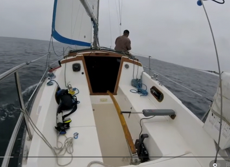

Where can I find the bracket used to attach the ST 2000 to the side of the boat? (coaming) If the part does not exist and I need to make one myself, let me know your ideas on how to make it. (1984 Catalina 27)

What you have pictured appears adequate. You can build a simple bracket with a block of wood, then insert the tiller pilot pin socket into the block. I had the pin socket on the coaming because putting it on the seat was too low... I bought an extension for the push rod to insure full movement. I like your set up better.

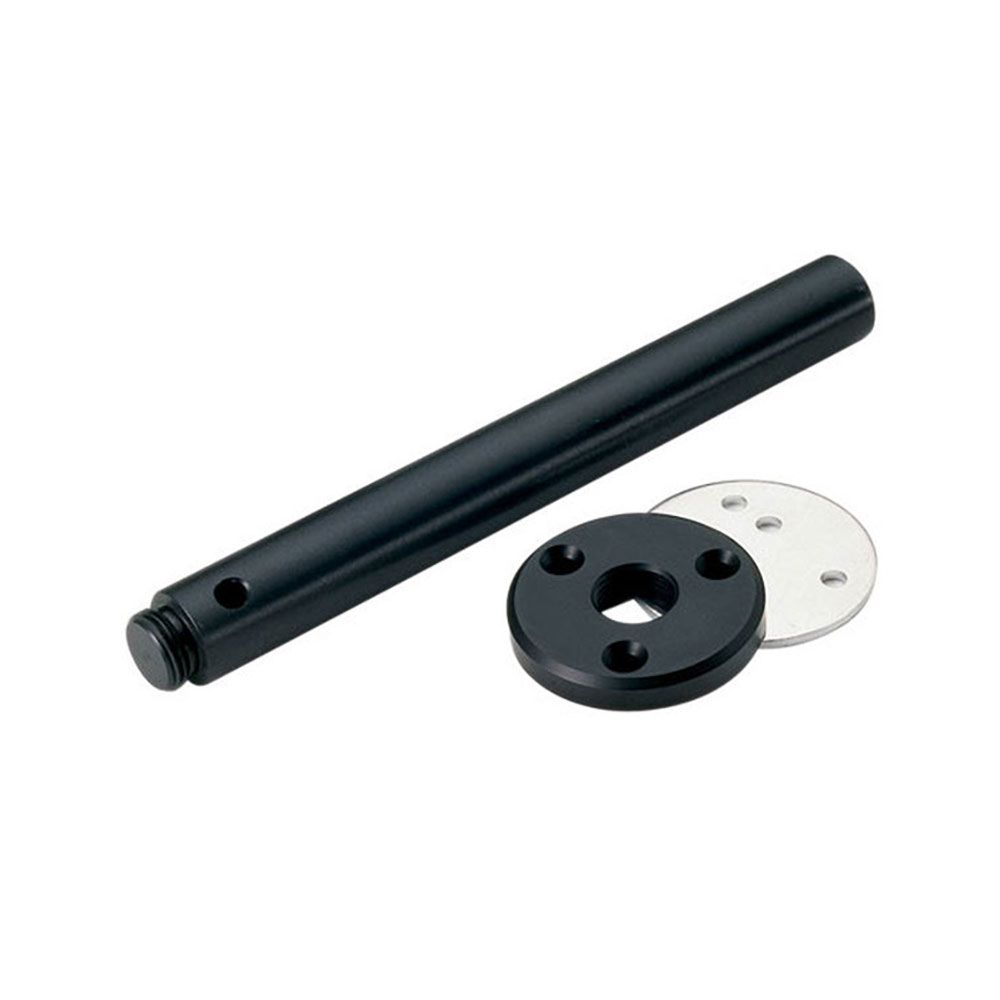

Here's some ready made hardware. I typed in "tiller pilot hardware" and this kept popping up as "cantilever socket". It's available for many brands of tiller pilots. The low profile flange is comfortable if someone is leaning against it
