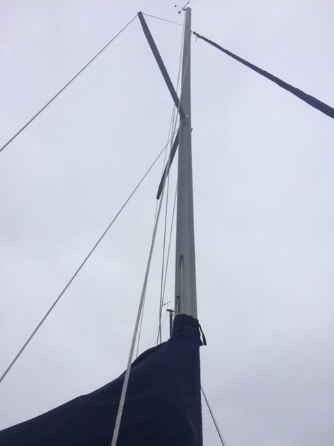

Can you take a side view of your boat with mast up. Also standing in front of the upper or outer shroud without moving your hand and arm, pull inward with your two upper fingers only and tell appx how much you can pull onward the upper shroud.
Thanks
Dave
I do have the mast up right now on the trailer, but I can't get a good side pic. I'll have to check that when I have the opportunity. It's a little hard to gauge. If I understand you correctly, I stood inside the shrouds and pulled on the upper shrouds, toward the mast. I would say I was able to pull 4-6 inches. Seemed even on both port and starboard.

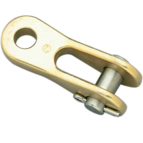

In any case, I was able to pin the headstay while on the bow. I removed a set of extension tangs that previously attached to the U-bolt on the bow, and instead, attached to the point where the tack would connect if there were no furler.
I really was not comfortable with that setup as there is a crack under the rub rail, which I'm sure is a result of that connection point. (see another thread I posted about that)
I removed those tangs and replaced them with a toggle.
In doing so, the pin point is relieved by about 2.5 inches. (hope that makes sense) The shrouds still seem tight. I'm wondering if the rig was overly tight before. I don't think it should be really difficult to pin the headstay, like it was. I'll post pics soon of the final setup.

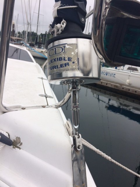

I am curious. Can you post a photo of the rubrail at the bow on the port side. In addition is the strap under the bow pressed inward with the nuts as it appears to be?
Dave, don't get me wrong. I'm not questioning your abilities and expertise, or disagreeing with you. I'm just saying for my lack of test by feel abilities like you, I might be better off with a Loos gauge.
Anyway here are a couple pic's, is this what you asked for?
The last image is of an Eye Jaw Toggle I purchase only chrome plated, of the same length, that will replace the toggle you see in the pic.

That is a good purchase and Jackdaw and others would agree. I will be glad to talk to you about the hand tensioning if you would like to on the phone. let me know if you want my number.
As for the request for the additional pictures, let me explain. The port crack at the lip of the hull to deck joint shows a crack thru the deck portion of the glass extending backwards with a slight crack what appears to be in the 5200 that marries the hull to deck joint together. I looked at the new photo and see dents/cuts in the black inserted portion of the rub rail. I think that may have been caused by a hit from the previous owner but cannot be sure. If it was from the forestay issue, then both sides should be cracked in a sense.
As for the strap under the U bolt nuts underneath, not sure but it may have been overtightend resulting in that hairline crack in what to appears to be only in the gel coat. It looks bad but cannot tell since I am there. May I suggest a slight or small 1/8 inch hole only in the gel coat to keep that crack from extending further and go ahead and repair it. I pretty sure it looks fine but I know your concern. You did say the rig was over tightened by the previous owner.

Here is a Hunter 26 I am working with the new owner to correct this but waiting on two addl. photos of the shroud turnbuckles.View attachment 138426 View attachment 138430
I installed a CDI FF2 furler on my last boat. Looking at the pic of the boat you are working on, I would say the furler is installed incorrectly, if the turnbuckle is below the drum, it should be inside the drum. The link below accesses the CDI FF2 owners manual that clearly shows the turnbuckle inside the drum.

you are absolutely correct on that Doug. I am waiting on photos of the shroud turnbuckles to see if there is any spacing left which to adjust. My biggest concern is the forestay whether or not wires will break and I think they will unless the owner does not follow the correct directions of the manual sent to him in a private email. This is what I come across as an example trying to untie a mess.
