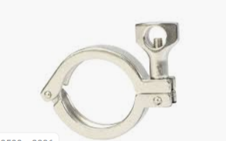

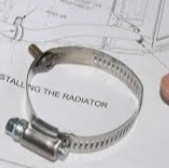

Another important component of this is how to properly attach the furling drum to the bowsprit.Typically the drums have some kind of shackle (snap) on the bottom. The bowsprit on the Hunter 216 is a smooth carbon tube that has two working lines. The extender and the tack line which exits the end of the tube through an end cap.
I’m thinking I need some sort of loop attached to the end of the sprit that I can attach the drum shackle to. If I tie something on it could slip but I don’t want to drill any holes in the tube either. Big hose clamp might work but might tear the sail etc so has to be rope I think.

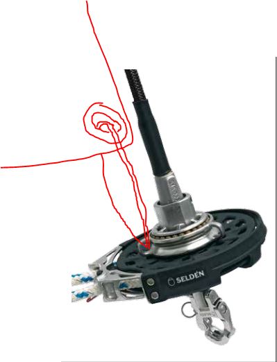

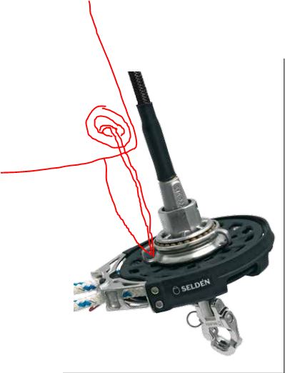

Our Selden GX TD Furler is setup with the tack of the sail connected to the top of the drum and the drum shackle is connect to the bowsprit end, I would suggest a similar setup. When we take ours down after use the whole thing goes in the bag, sheet barber poled around the sail, sail, and TD furler. Easy up and easy down.
Likes: Hunter216

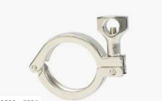

You are on it like the one below on the left or a hose clamp like the one on the right with a high strength rope with a loop.
View attachment 169608View attachment 169609
I’m reconsidering my non hose clamp approach as they are relatively inexpensive and I can always tape over any sharp edges to protect the sail. Hmmm the old analysis paralysis thing is kicking in!
