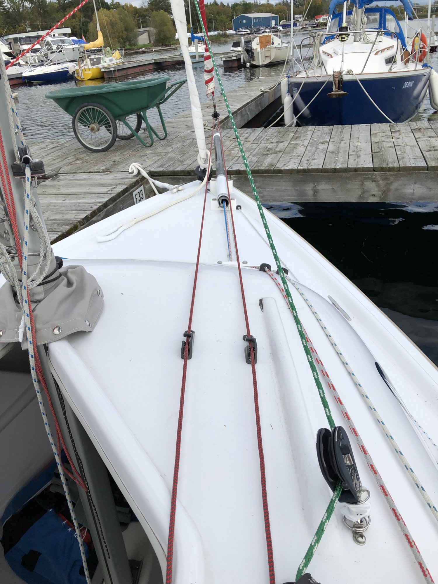

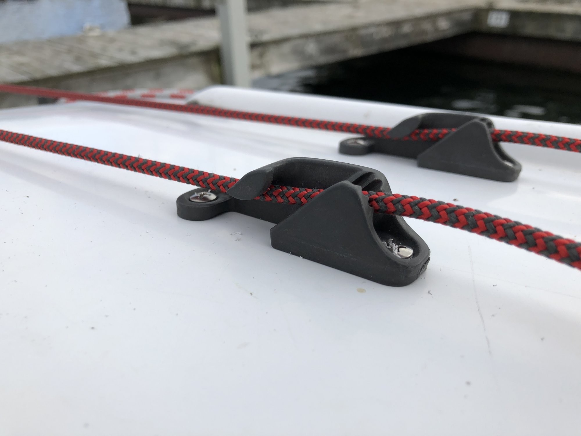

I have used the furler a few more times and am getting a better feel for how much to play the continuous line - sheet tension - point of sail factors to get a nice deployment and douse. I added two cleats to secure both “sides” of the continuous line to help control things. I have yet to decide how best to keep tension in the continuous line. To date I have just used a removable sheave block to keep it taught, the downside is I have very few places I can tie off to so I have a length of rope going all the way aft to the dock cleat. I’ve got all winter to model that little problem out!!
Photos of the new cleats. Note how the line loads from the side to allow easy removal of the continuous line.
