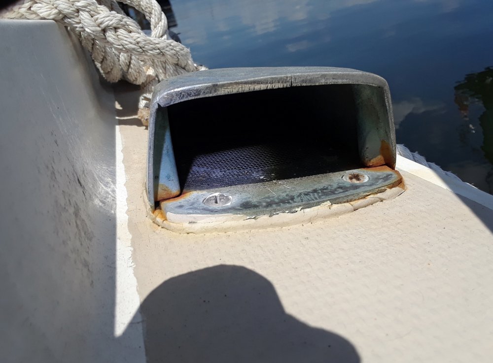

How about a easy way to keep bugs out of the port lazarette and fuel storage area, Just put a piece of fiberglass window screen between the forward vent (i did same on aft facing one around the fuel line too) when I rebed the vent last time.
Pix is a little hard to take, but you can see the screen.

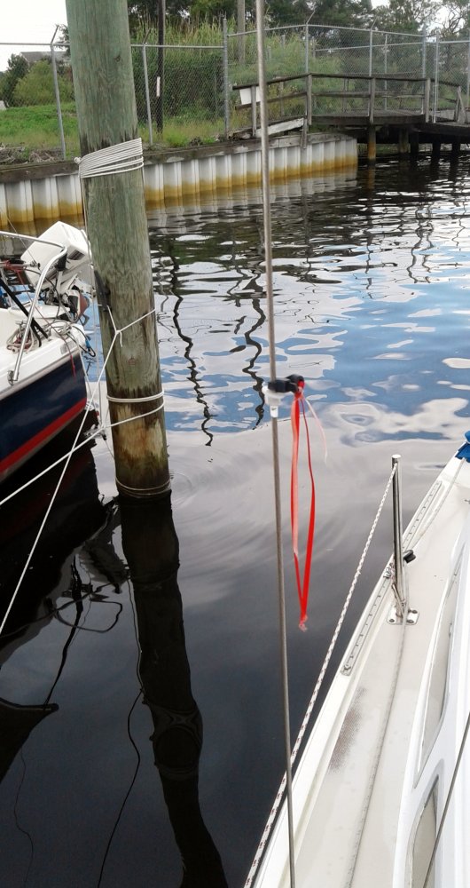

I also got tired of expensive wind gages on the shroud from Davis etc busting my beer budget for sailing so came up with cheap version using zipties and red nylon floss from Walmart sewing section.You get like 10 yards for 88 cents or so.

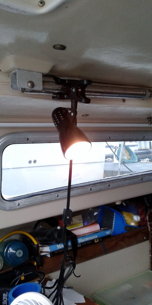

Here is my cheap ac powered lamp , clips on pop top bar, plugs into onboard power strip (later project to be posted) about 6 bucks at walmart , comes with bulb.

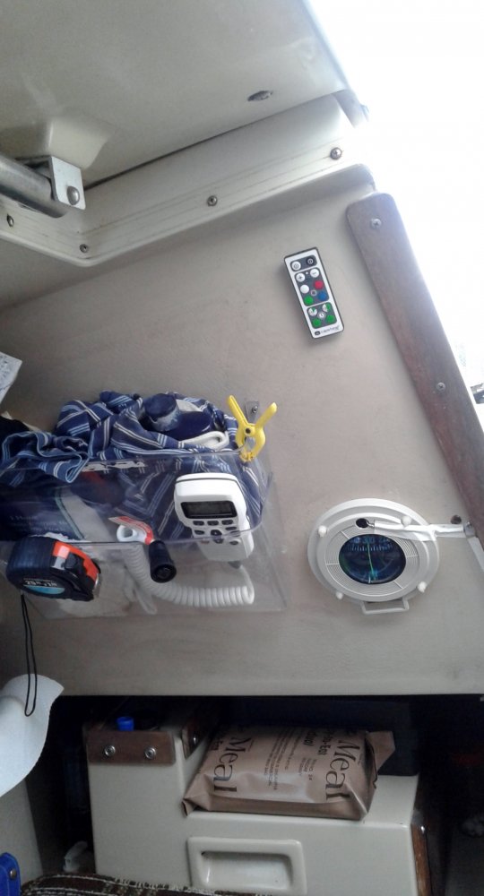

Nice way to generate storage area on starboard back of bulkhead above galley and back of compass. Couple of cheap folder holders of clear plastic from a thrift store, couple of screws and Voila (french term =OMG) its done.

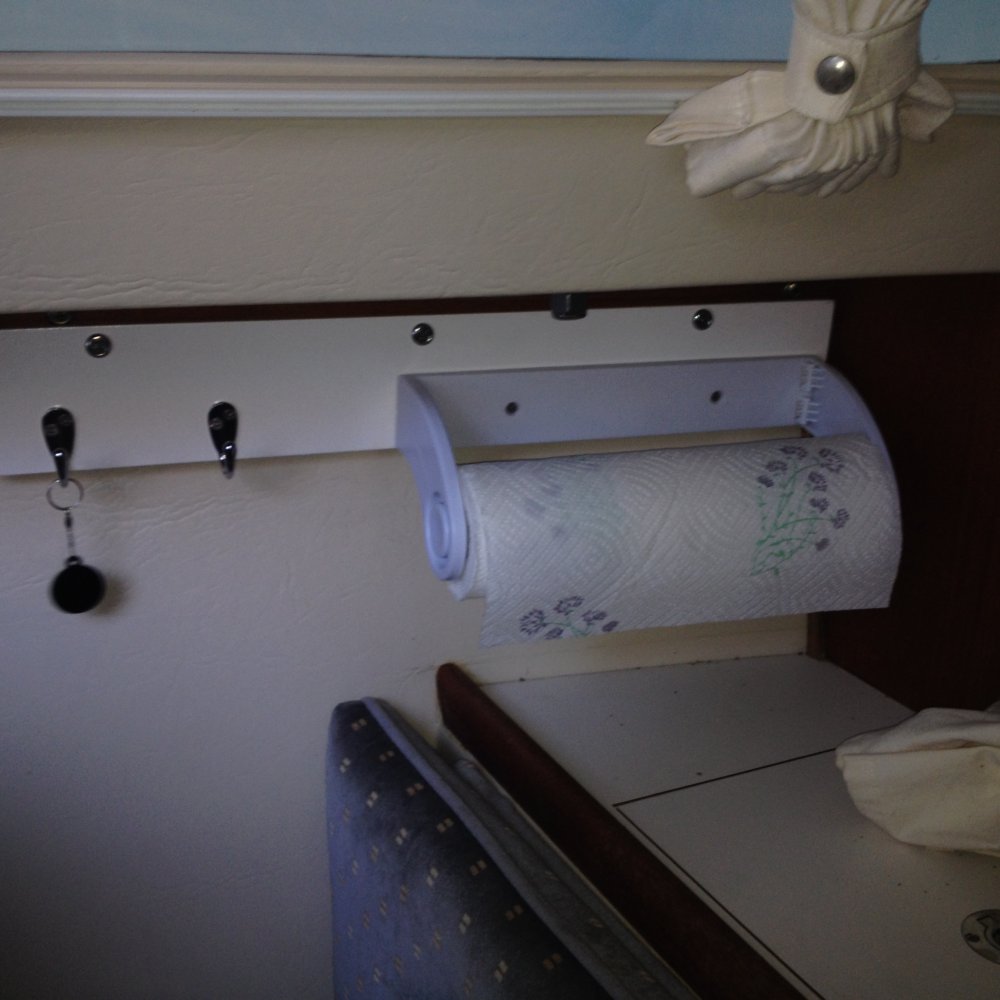

I'm sure you've seen one before...but a simple paper towel holder with a couple of coat hooks for keys, hats etc.

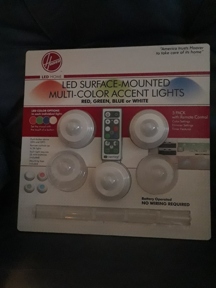

No but you can choose blue, green, white or red and dim them too. wait for it. Only 19.95 for 4 lites.

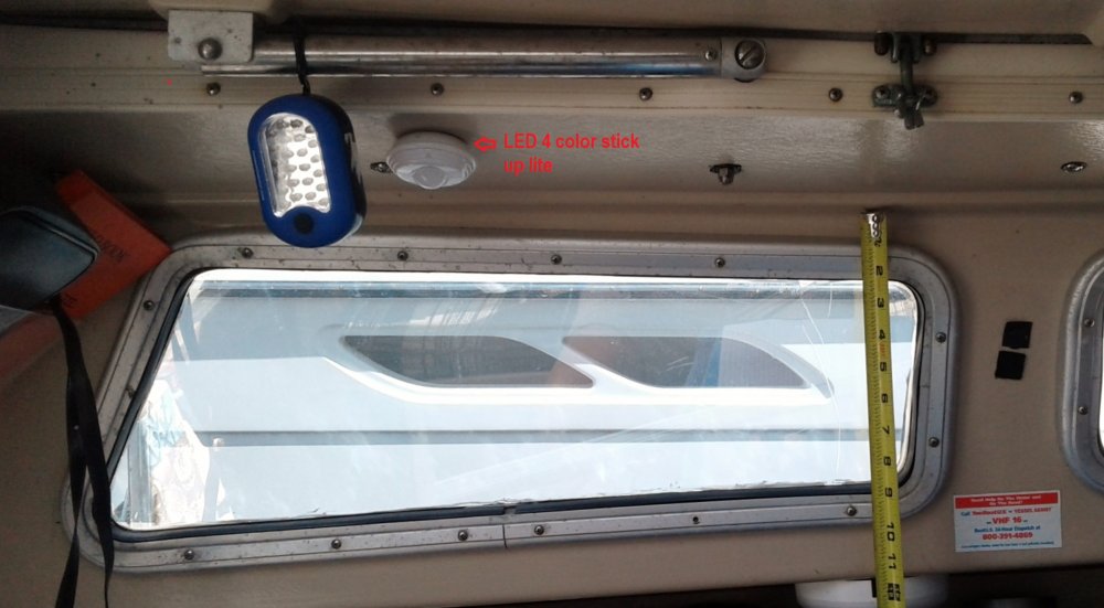

Ok So here is the explanation for the remote on the bulkhead. Found a 4 lite LED stick up set in Sam's Club, has batteries included, 4 lites, stick up pads and a remote. The remote can change the color to white, blue, green or red and dim them as well. Only real trick is wipe down the mount surface with acetone to get a good stick. If problem area I used a pair of stick on velcro pads in one spot. Backup is since the light unscrews from its back plate with a twist you can even put a small short screw in to hold it up. I put one over galley, one over nav station, one over forward dinette compartment on port and last one over my hear area on stbd setee, nice lite for reading. Each can be turned on individually too by just tapping until right color is on. Location of remote lets me reach in at night and put all lights on low red with a click.

No , just add on that does not need me to find the master switch and turn on the boat. Can run down to dock (quick in and out to sail!) pop hatch, hit remote and see everything in cabin, check for leaks etc. Also quick way to put red lites on in cabin at night if needed without draining main battery already being used for nav lites and maybe depthfinder.

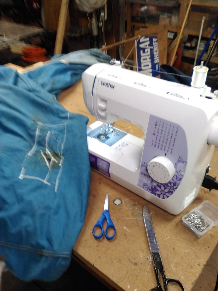

BTW , this is the most useful tool on land to do things for my boat, and refurbed it only cost 49 bucks from Walmart.

how thick of material can that sew ?
I borrowed a commercial machine, but am considering getting my own. Lot's of thrift stores seem to have well built old ones.

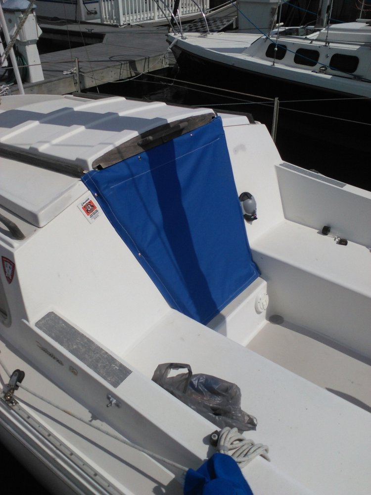

I have done 4 layers of vinyl coated canvas, like two folded over seams intersecting at a corner and such. Use nylon thread and take it slow. But no problems to date, made a cover to snap on over companionway during rain without having to get out the crib boards.
