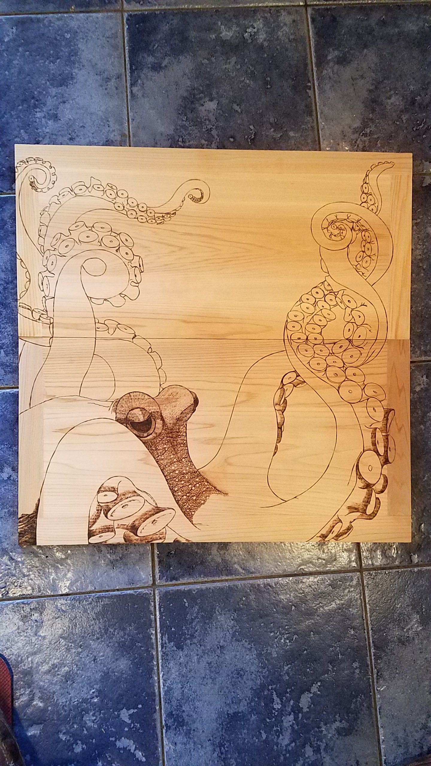

You might be interested in seeing a set I'm working on right now. I'm happy with how it's coming out so far.

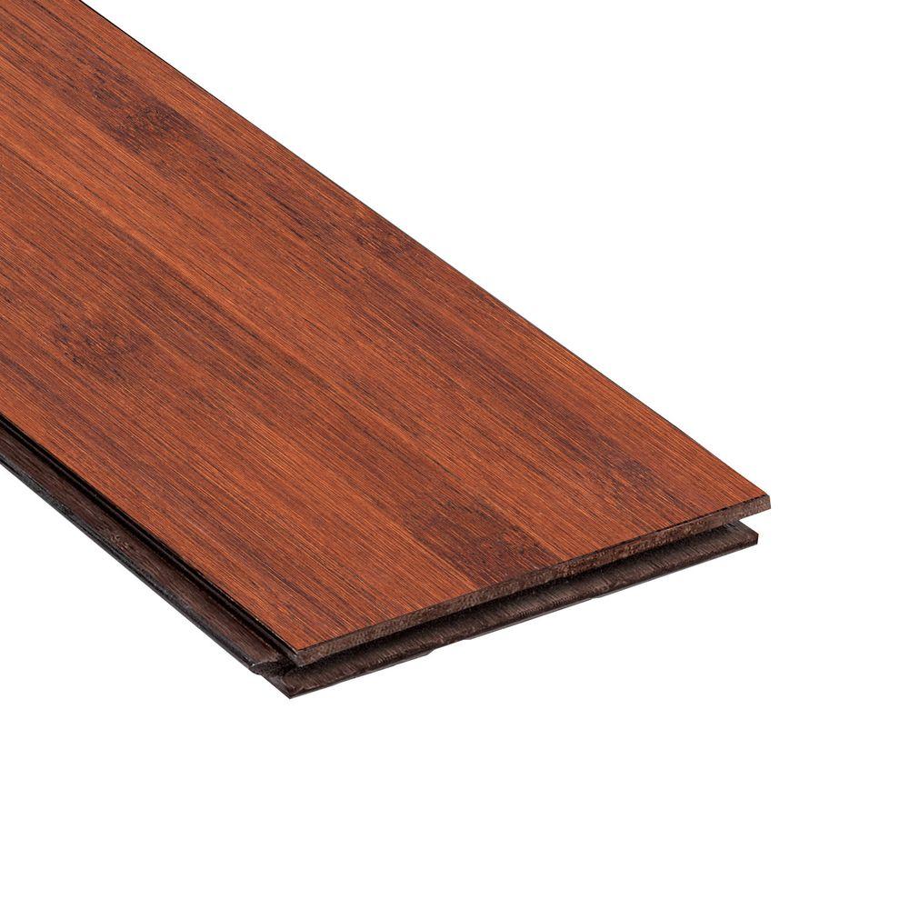

Now I am back to the possibility of laminating several sections of solid bamboo flooring together to get the right thickness. Glue it up three planks deep, and then cut and route to the correct shape. Maybe add some nice art like that shown in this thread.

Bamboo sounds good. I'll bet it is good light colored wood for pyrography.
