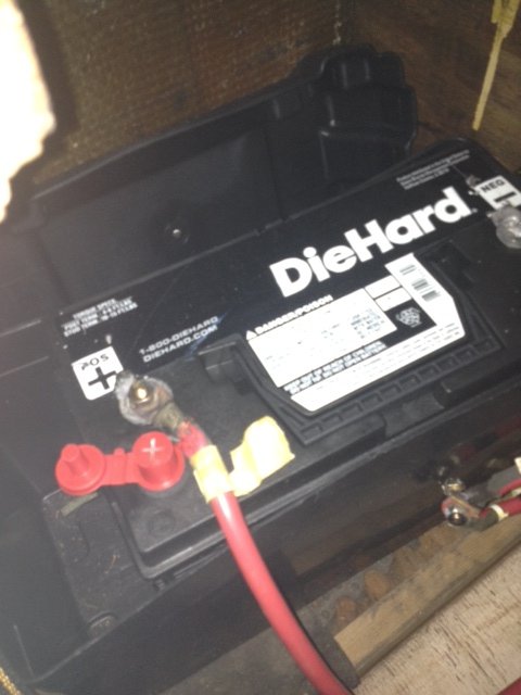

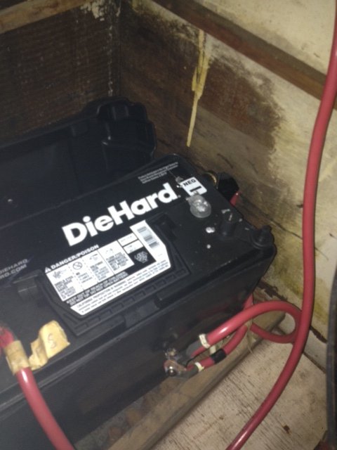

After getting to take a closer look, there is a brand new Yanmar diesel (less than 50 hours), an electrical system that was entirely rewired probably 10 years ago with all red wires (you can’t tell what is the positive or negative wires without tracing it back), original brass seacocks throughout the boat (almost all of which are frozen open), practically brand new sails (all 4 of them from Doyle and still crisp) and 10 or more years old electronics (2 loran systems, SSB & VHF radios with dials not digital displays, an old Garmin GPS and a Raytheon radar). The plumbing system seems to have been redone at some point but I saw a lot of “dead ends” which are breeding grounds for bacteria. The water pressure pump is broken (not winterized properly); there is a hand pump at the galley sink but none onboard knew what it was for until I showed them. The cabin top was designed to be slightly concaved and there are drain plugs that would allow collected rain water to go directly into both of the 50 gallon water tanks (one on each side). All of the running rigging is at least 15 years old and it has been sitting out uncovered for the 4-6 years the boat was on the hard. All of the halyards are rope to wire splices (most of them don’t look good to me). Based on soundings of the hull there does not appear to be any delamination (solid glass hull, no core) but there is delamination on the rudder. There used to be solar panels but they were stolen last summer. Now mind you, this is my list after only spending about 2 hours on the boat.

Here are the things I know that were never addressed before the boat went in the water: the engine was never run, the electrical system was never fully inspected or tested (they installed the Humming Bird unit, tried it and saw that it was not working correctly and they had cabin lights), none of the existing electronics were working, the water tanks were never flushed or inspected, the blackwater system was never tested or inspected, and all of the running and standing rigging was never inspected or changed.

I went on the boat because Mike could not find the shore power connection and wanted to charge the batteries. I found that the AC side of the electrical had been disconnected from any connection for shore power (the bare wires were in one of the cabinets). They also had water pouring in through the strainer that was not connected to the engine. The bilge pump was off and the bilge was almost filled with water. I tried to close the seacock and it was frozen. We connected the hose to the water pump and found out that the top of the strainer could not be all the way secured due to a broken bolt. We were able to get it to hold but the bolt needed to be replaced to really fix it.
Since we had the water connected, they wanted to start the engine. I guess they tried to bet a mechanic to come and look at the engine. However, they didn’t look for someone until Sunday and were surprised they didn’t get anyone to call them back. We looked at the electrical set up and it seemed strange because it had one battery switch that was the typical “1-2-All-Off” switch. The other was “1-Accessory(from a label maker)-Off”. The “1” was connected to the starter and the “Accessory” was connected to the windless. The typical switch was connected to the house bank of 3 batteries in parallel (“2”) and a new group 27 deep cycle starter battery (“1”) they installed new that morning. We changed both switches to 1 and we heard popping and sizzling then smelled smoke. The terminals on the starter battery had literally melted off. (See Photos) My guess is someone crossed a positive line with a negative, which would be easy to do since they were all red with no way to tell them apart easily.
