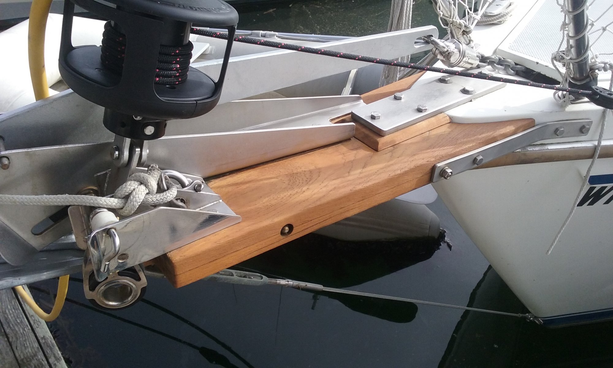

I ran across this article a while back. I'm not endorsing... just passing this along
I have also tried every finish (other than Cetol which I hate the look of) and have failed with all of them until I tried Semco Teak Sealer. It does not build up and a single wiped on coat twice a year keeps the teak looking good and beading water. It basically looks and feels like unfinished freshly sanded teak after you wipe it down with acetone. [It does not have the natural oily feel of freshly sanded teak.]
I have been using it for the past 3 years and it still looks great.
