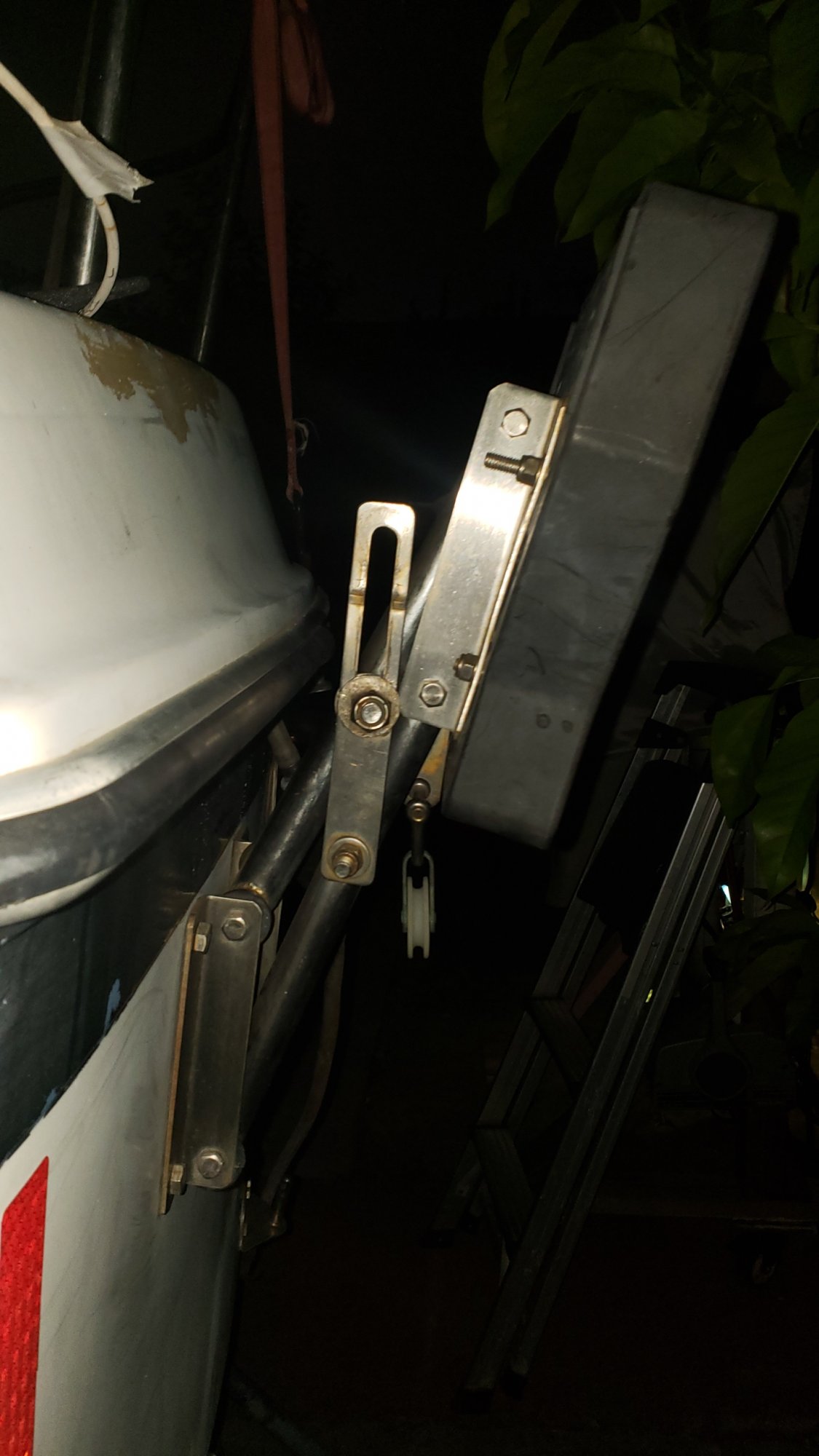

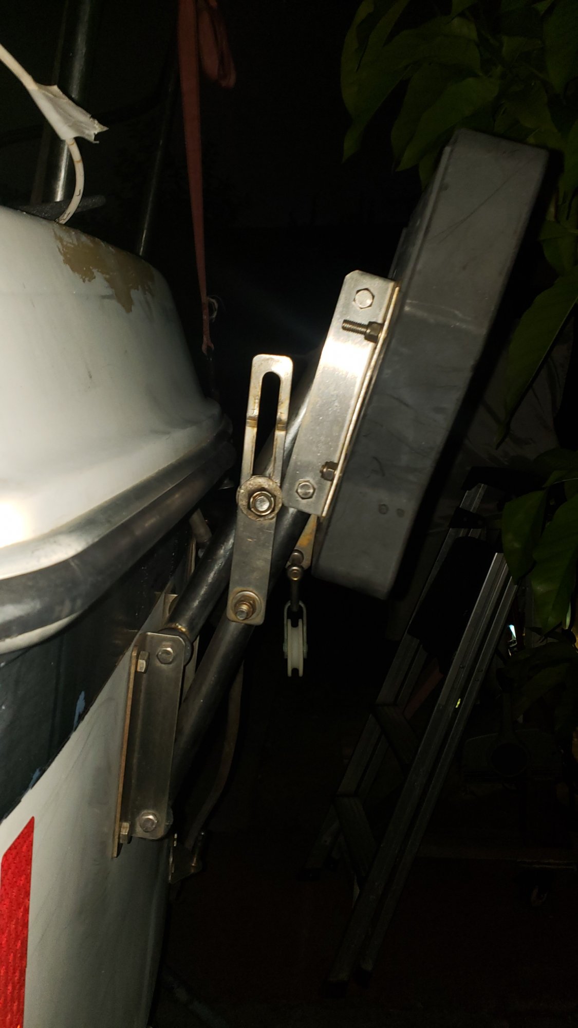

Boat will be in a slip, with a Suzuki 2hp, it is not too bad to pull It up after use. But if I upgrade to a 6hp fouur stroke then I'll be more challenging. Anyway to improve the lifting process? Don't want to spend 300 to buy a new one with the handle yet.
Oct 19, 2017
8,193
You could add a couple of bungies to help with the lifting. Use a block and tackle from the boom when you want a little pulling advantage.

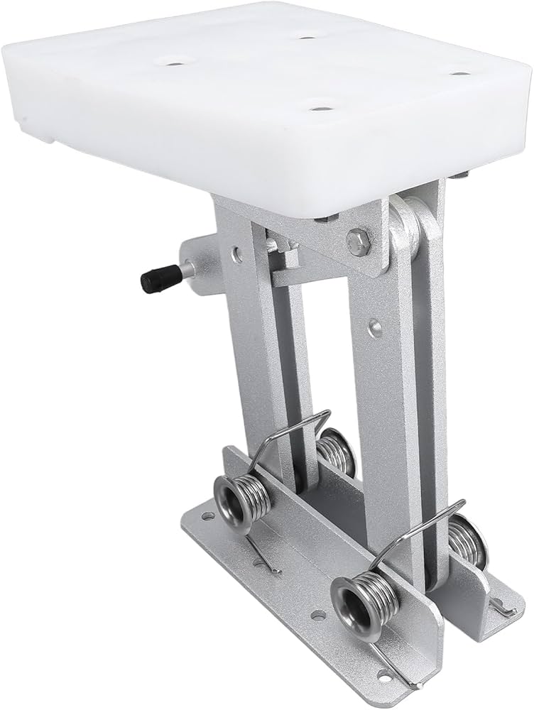

Add springs:
-Will
Likes: Indysailor
24,926
That looks like a mount design that has springs to set it in the up position. The small block (pulley) hanging beneath the mount would be used to pull the motor down. A lightweight motor would be normal. You would want a method to hold (lock) the motor in the down position.

I personally would be very leery of putting a 6hp 4 stroke on that bracket. Said motor will weight 60lbs (long shaft), and being single cylinder 4 stroke, generate significant vibrations. In looking through various outboard brackets, the lighter versions carry restrictions on 4 stroke weights, hp, or ban them altogether. The photo of that mount show me a light weight bracket not capable of supporting the motor you propose. Which makes me wonder how much the mount bolts are backed up inside the transom.

As a rule 4 strokes weigh considerably more than their 2 stroke brethren . We have a 4 stroke ,2 and a half horse Yamaha . Weighs very little .upgrading to a 6 horse the weigh goes from 24 -30 pounds to sixty at least .
I'd look for a used lift . Lot's to be found for $50.00 or less .
I went from a 6 horse ,2 stroke to an 8 horse four stroke . I'm now at 100 pounds !
New lift , new interior support brackets on the inside of the transom .
