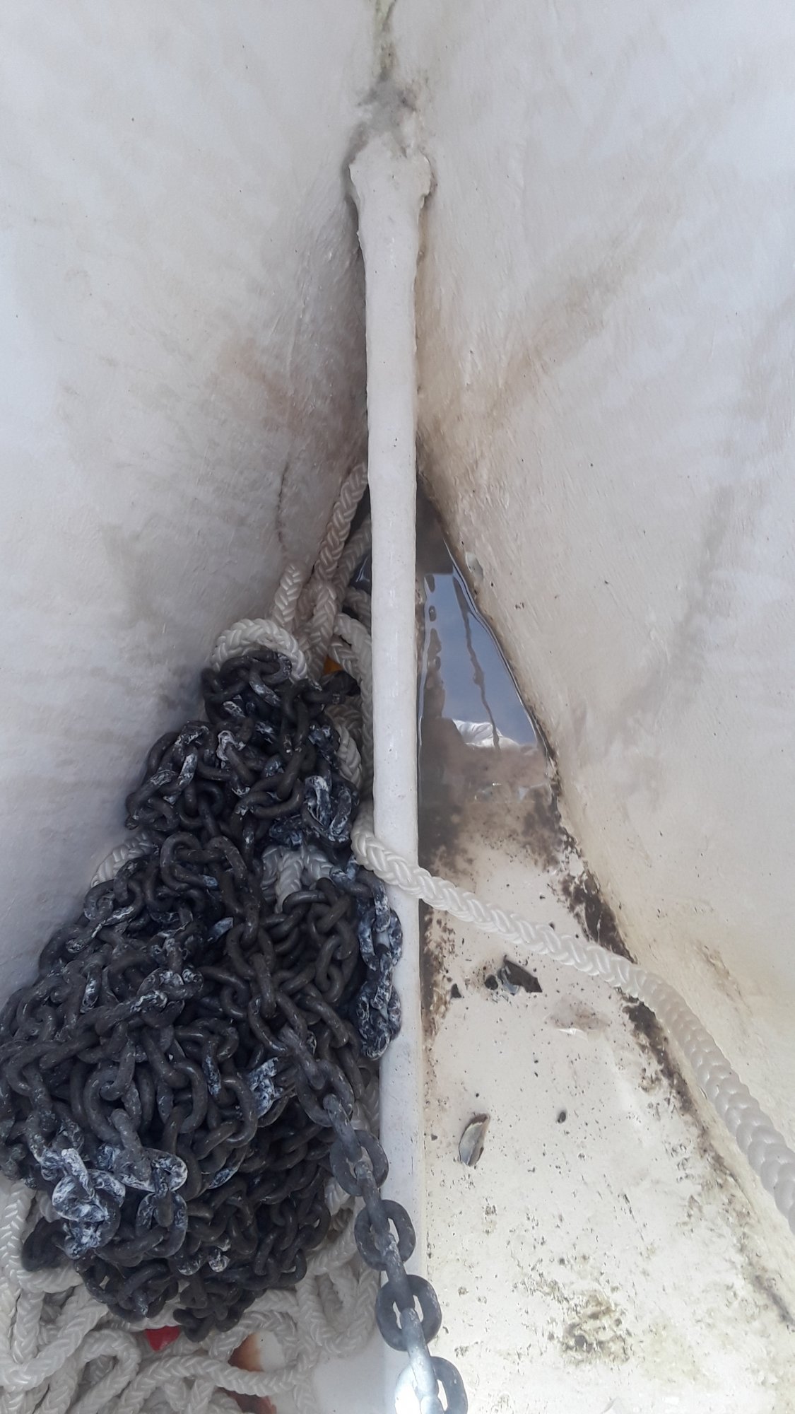

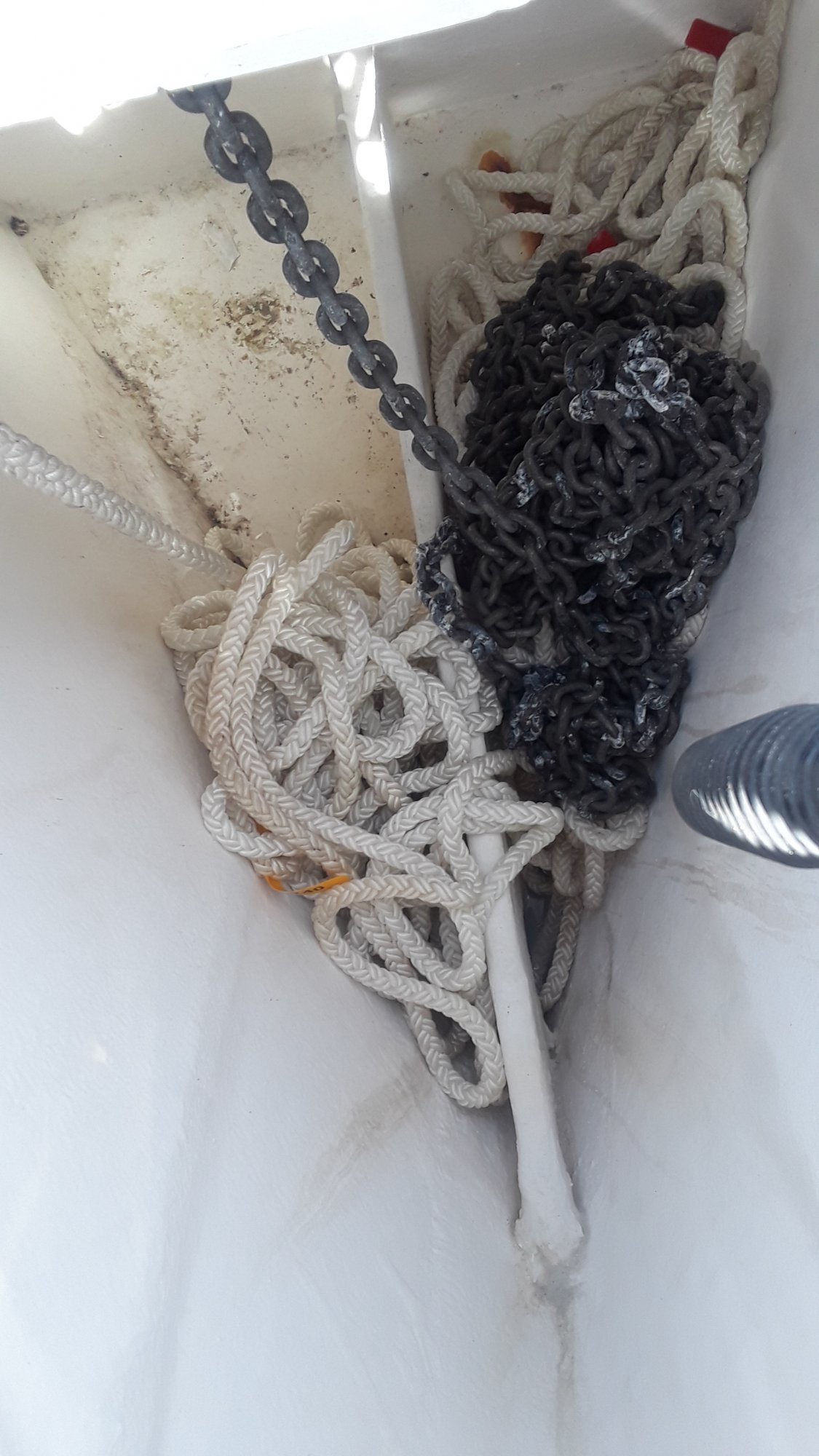

Did you really mean forward anchor locker? If so, my 2005 Hunter 46 anchor locker through hull drains are about 1 in higher than the floor near the bow. Cannot understand why Hunter installed these at this elevation/location, which does not allow the locker to be free drain. Fortunately the locker floor is sloped towards the bow. Anchor Locker 1 photo, looking away from the bow, shows no standing water. Anchor Locker 2 photo, looking towards the bow, shows standing water below the through hull drain close to the bow. Do you have the same issue?
I contacted my fiberglass guy and he is going to modify the anchor floor on each side of the partition with fiberglass OR install a through hull drain on each side of the boat to allow all the water to free drain out. Any other suggestions welcome.
