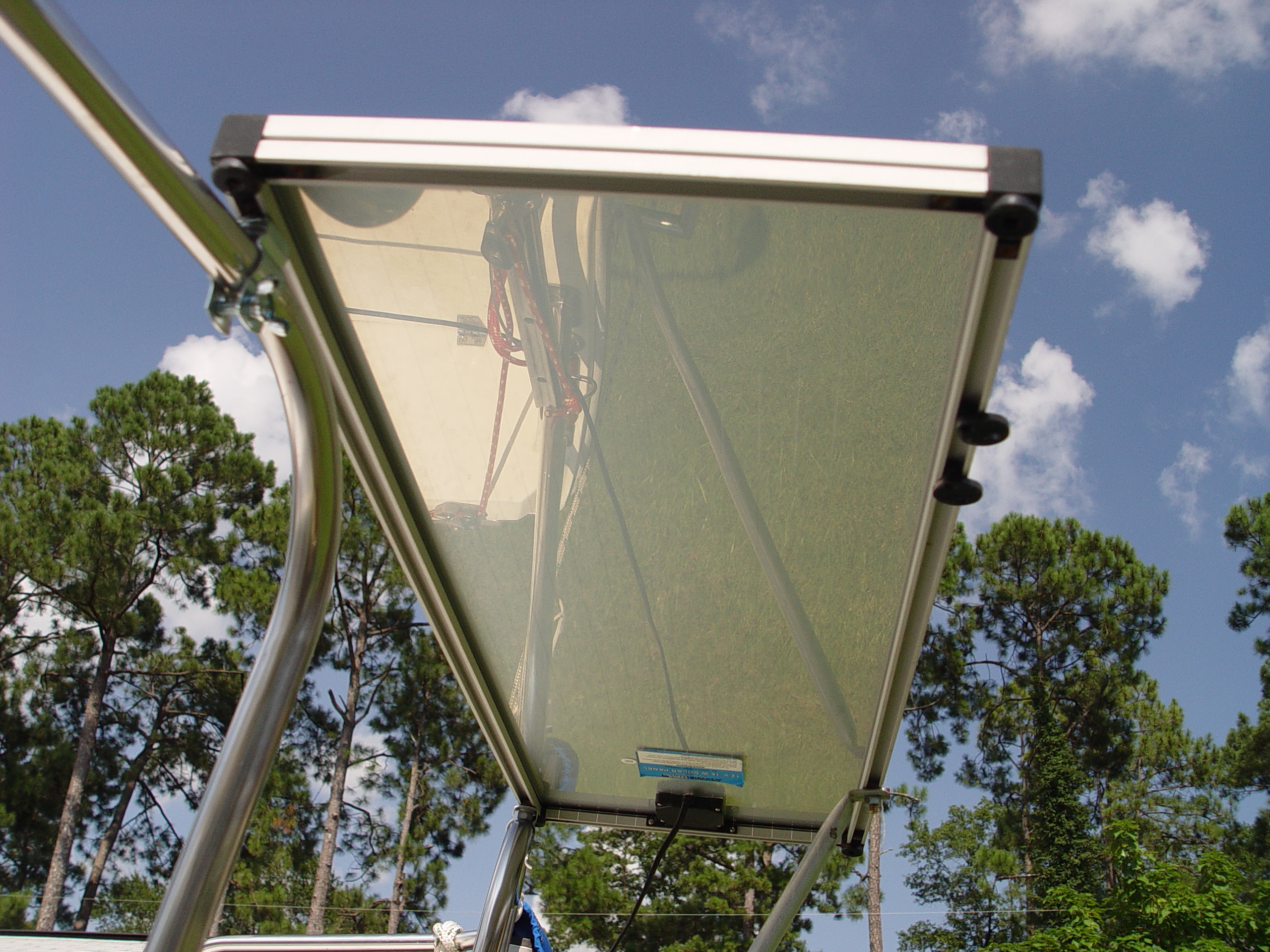

@ShotgunSlim In an old thread, you posted some photos of your panel mounted on the stern pulpit. How is that location working out for you ? Do you leave it mounted ?
(it seems we can't post to real old threads)
Dec 5, 2011
551
Catalina Catalina 22 13632 Phenix City
It works great when I put the panel on the boat. It keeps the battery topped off, doesn't get in the way and hasn't fallen off the boat while sailing yet. It even makes a pretty good table for light items when hanging out in the cockpit after sailing. Honestly though, I have only been out once where I had the panel on the boat, most of my sailing is day sailing at this point but I hope to go to the lake for a couple of days soon.

No experience with the Coleman, but you might (or might not!) like this mounting method I came up with. It's cheap, looks decent, stays completely out of the way, and the panel can be articulated up and down about 135 degrees, so it can be aimed anywhere to starboard or even slightly to port if you extend the legs fully. I had a 15 watt Harbor Freight panel on it, which I just upgraded to a 30 watt Renogy and a better controller.

Gene, is that ziptied to the upper rail ? Velcro Strap ?
Slim. I'm liking the "table" idea. A panel for the top that has fiddles comes to mind. Not only make it a better table,but protect the top from damage when stored below if required.

@Gene Neill , I may just do a combination of your and @ShotgunSlim 's mounting.
My BBQ is currently mounted where your panel is.
I love the adjustable angle setup and the ability to tilt it out of the way, but I also like the stern position and use a as a table options.
Heavy zip ties would work for the hinge. I think I may have some heavy duty UV resistant ones lying around.
