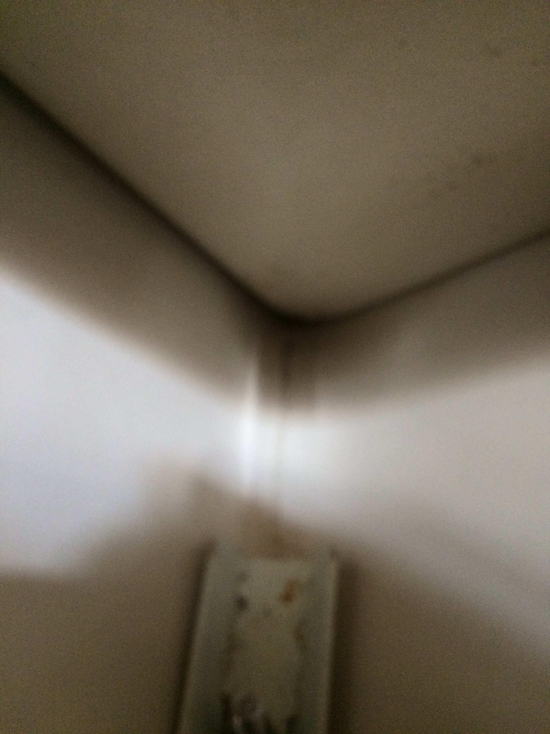

Lousy pic , but that's under neath locker, the metal bracket is the backing plate for the trailer cable hook up

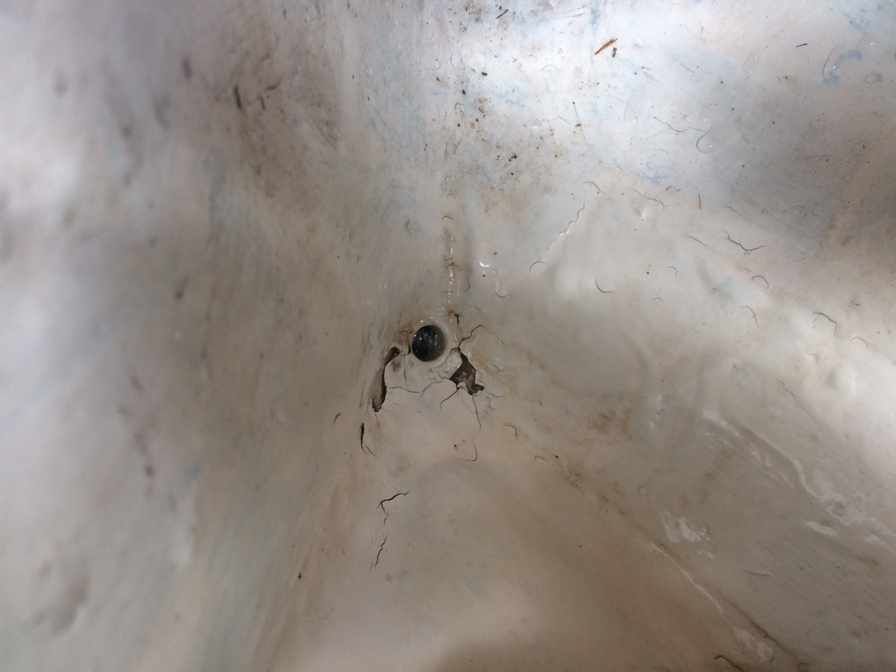

There is retro upgrade repair ,because it is not the lowest spot , that involves drilling hole out bigger and lining with new tube , not sure that's source of leak .

The hole was there for a reason. If the leaks are from the cracks around it, then I'd fill those with epoxy.
In the meantime, I would get a small cork or stopper AMD plug the hole. Then I'd get some paper towels, tape them in place and see if you can see if it's the forestay, deck hull joint or whatever that is the source of the leak. If it only the hole, then I'd deal with as I suggested above.
I would not be using sealant to gunk that up.
If the hole isn't at the low spot, that's correctable. But under sail your bow may drop down and you may need the drain in a different location -- the low spot may move.

So the anchor locker drains to the bilge? Not a good idea. Drain it out through the hull, one high, one low. You have cracks and leaks in your locker fiberglass laminate. The fix is epoxy. Don't glop a bunch of 3M whatever on as a patch because it will compromise the eventual proper fix - epoxy.
