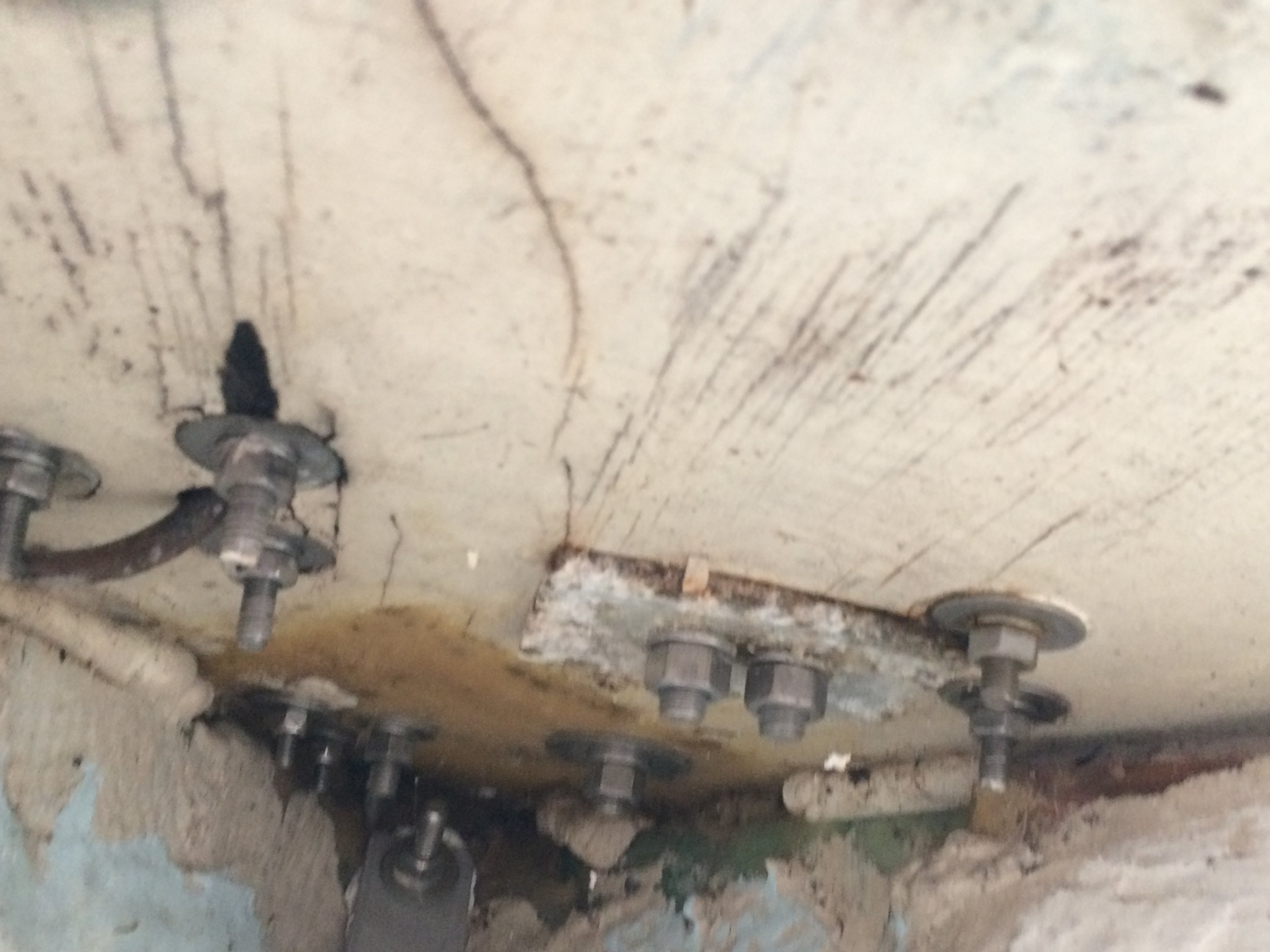

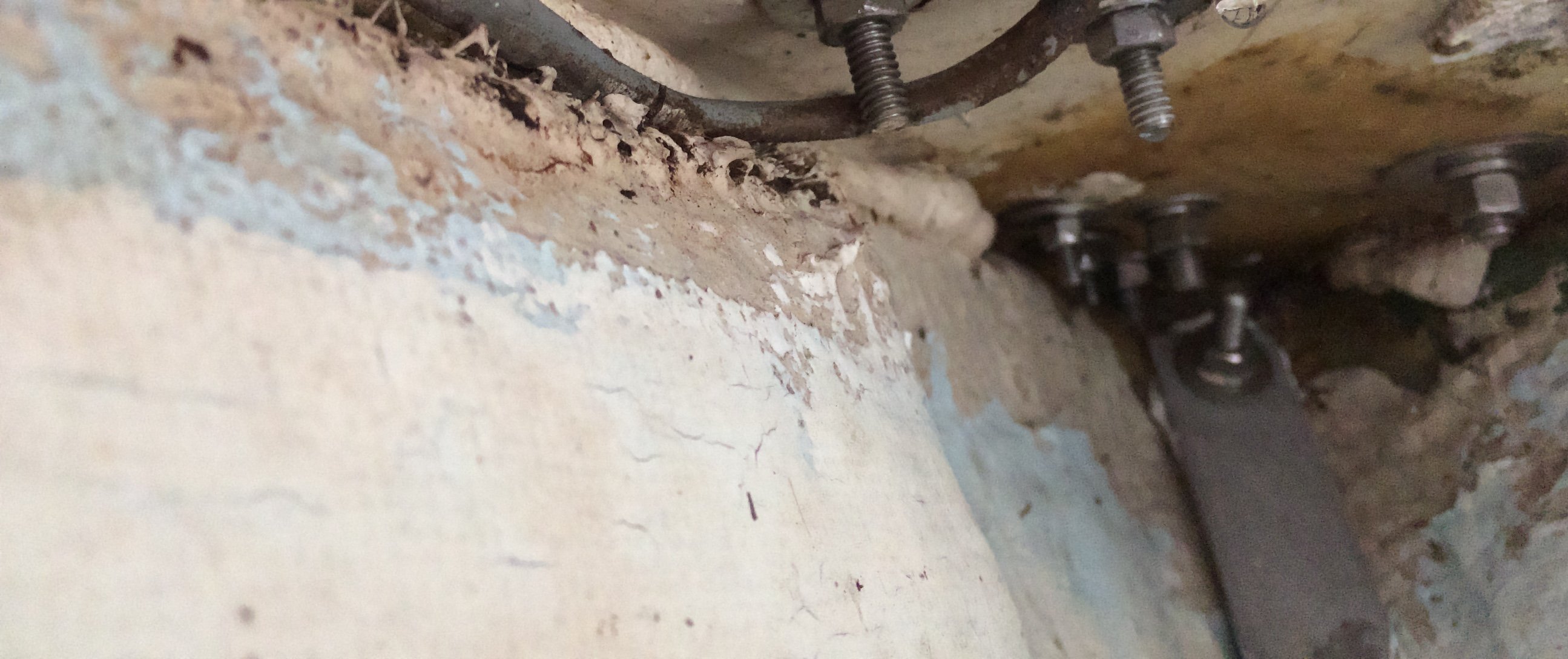

Took a few more pics yesterday to have a better look it appears to be around the drain hole . Although not a nice looking area it was all dry and solid .

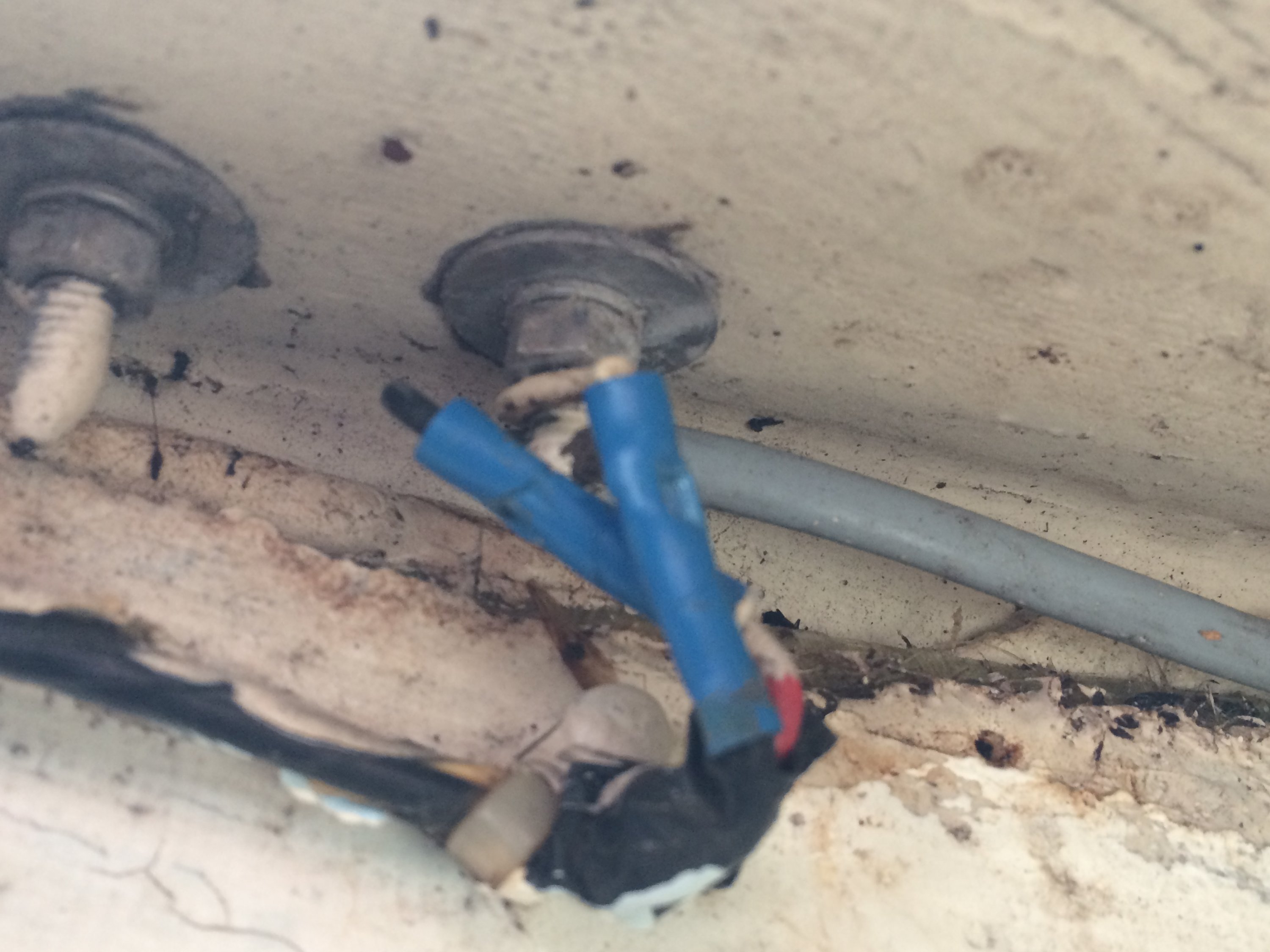

What is the clipped blue wire above.
I'd brush out the cracks and crevices of loose pieces, clean it with acetone (maybe alcohol), and epoxy it smooth with a trowel. The hole to drain, we've discussed above.

Thanks , "clipped blue wire " runs up pulpit to bow lights , I'm going to try to get a heat shrink on it .

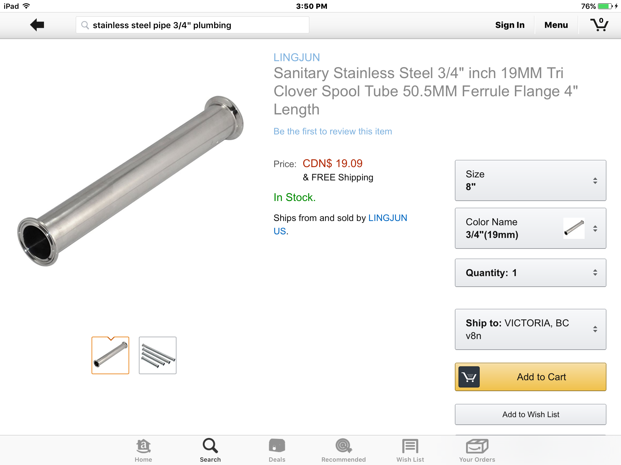

Saw this on Amazon this morning thinking it would work well , just cut off exit end

Looking at this pic it seems you have a drain hole and then damage to your well. I would plug the drain hole with a plug well greased up and then spread West Epoxy, thickened with one of their fillers into damaged area. When the West sets, remove the greased plug and I think you will be good to go.

Water may be flushing through your cracks fast enough not cause damage underneath. I would fill the damage in the well as I stated before. If that cures the problem you are done. If not, you have eliminated a possible source.
