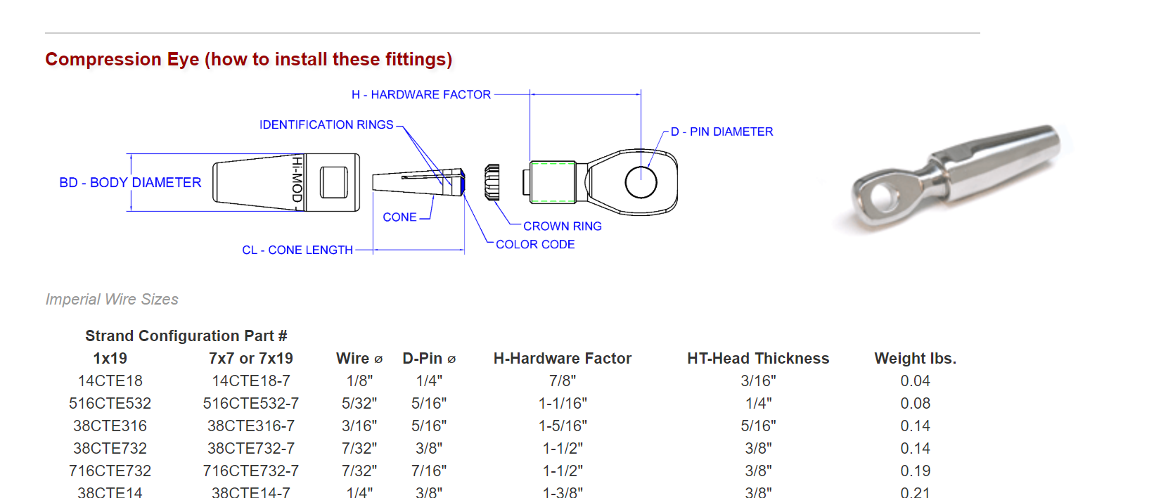

I've actually contemplated (for 5 seconds) a $5,000.00 compact roller swager (yeah right-- maybe I'll start a second career as a C-22 rigger-- BUT in the process I stumbled across these mechanical (bonus; removable for repair/inspection) fittings in 316.
Anyone played with these? I'm going in......
Hi-MOD Fittings by Hayn Marine

That is a nice do it yourself solution. Did a google on them and just about everyone carries them so looks to be a proven product.
I don’t have a reference point on cost vs having new ones made up in a shop though but it sounds like you already made that assessment.

figure at about 60 bucks per fitting it's worth a shot-- I can always go back to crimping but this appears so much cleaner -- and can actually be sealed with locktite blue. Rated at full breaking strength of the wire....

I've had a Hayn Hi-Mod on the top of my forestay for a couple seasons now. I needed to shorten the stay by a few inches (I had messed up the top of the cable; thankfully, I also needed to raise the lower end a bit to keep the furler clear of the anchor). The Hi-Mod made it an easy fix without removing the stay from the furler foil.
I'm always hesitant to place much weight on, someone saying, "mine hasn't broken" :) But I've had no complaints. And you're right that they're spec'd for full cable strength, and that it seems lots of full-time cruisers are using them. I don't remember why I chose Hayn over Norseman or Sta-Lok. Maybe because of @Maine Sail's recommendation at SailNet Community - Hi Mod fittings.
I think you can beat $60 each for the 1/8" model. E.g. ~$45 at Hayn Marine Hi-Mod Compression Eye Fittings (SBO is out of stock of 1/8" at the moment, but I bet they'll get some more in). The instructions call for a specific cleaner and Lok-tite. So doing it cost me $60+ to do one, and I now have some cleaner I'll probably never use again and Lok-tite that I might. But if you're doing a bunch, that $20 will cover all of them.
