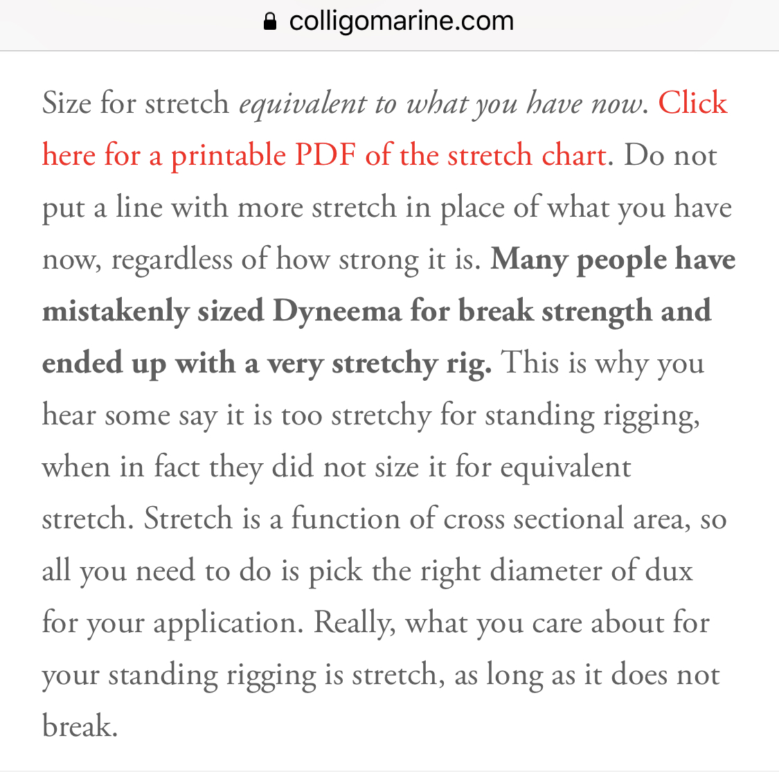

You must spec it for minimal creep rather than breaking strength,
The following is from the Colligo Marine website that specifically endorses your point.
From my reading it’s also important to use specific heat stretched formulations of synthetic material for your standing rigging as not all synthetic blends are suitable for this task.

Yes, size dyneema for creep, not stength, that is usually 1mm larger in size than the orginal wire and tends to be at or above 2 times stronger in tensile than the wire was. Always use heat annealed Dyneema or you will have headaches for quite awhile. I used 3mm STS HSR on my C22 which is esentially the same zize as the 1/8 wire, but if you put calipers on the 3mm STS HSR it is actually 4mm (which explains why the published tensile strength from NE Ropes greatly exceeds the specs for all other 3mm Dyneema from other manufacturers). Anyway, I believe that the creep from the sail loads on a C22 would be so minimal that the creep would have a hard time catching up with the available tensioning distance of the turnbuckles. I really can't calculate that to any point of assurance without knowing what the actual loads will be and at what interval. I've already spliced by forestay and my backstay in 5mm just because I could. There is also the option of stepping up the turnbuckle size to 5/16 just get a bit more tensioning travel. I haven't fully tested any of this yet, I've been far too busy rigging bigger boats. Please note, on all customer boats to date I have used Deadeyes alone with generous lashings or turnbuckles with lashings, I have never suggested a direct shroud to turnbuckle connection and niether would any other responsible rigger. My THEORY is that small boats and racing dinghys can get away with it.
