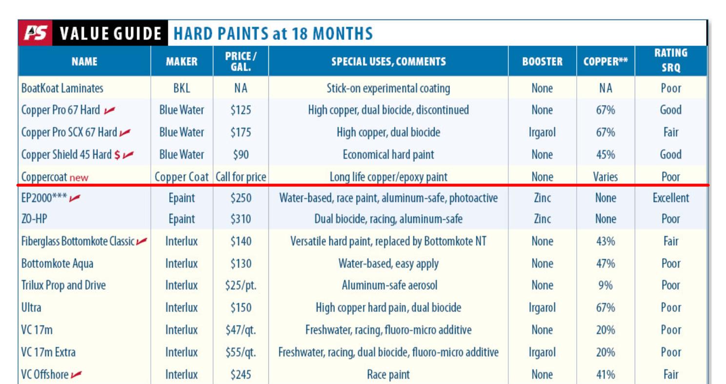

You may want to look at Coppercoat. I haven't used it personally, so I can't say if it will meet your needs, but some claim it is the solution for a hard, multi-year bottom paint. As always, try and get an opinion from someone who is using the product in your waters.

Thanks Jim, I am giving that some thought as I prefer to haul out every 3 years vs two while having the bottom scrubbed once as needed.

Good information, I'll be taking a look at Blue Water products and Epaint 2000.
