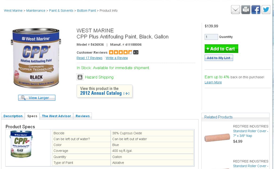

Disclaimer: Behaves well in our waters here. May act as fish food in your waters.
IMHO, the most critical thing about applying this paint is to use two coats. Prior to this, I was a Micron CSC fan at more than double the price. Always a single coat and then watched for the black warning coat to appear every two years. The manager of our (now defunct) Waste Marine advised two coats of CPP and the rest is history.
That's a single-season paint in most places, even with 2-3 coats. 8 months is realistic.

It's more than pretty good. It's impossible. There is no bottom paint you can buy that provides 6 or 7 years of anti fouling.
In your opinion, whatever that's worth.

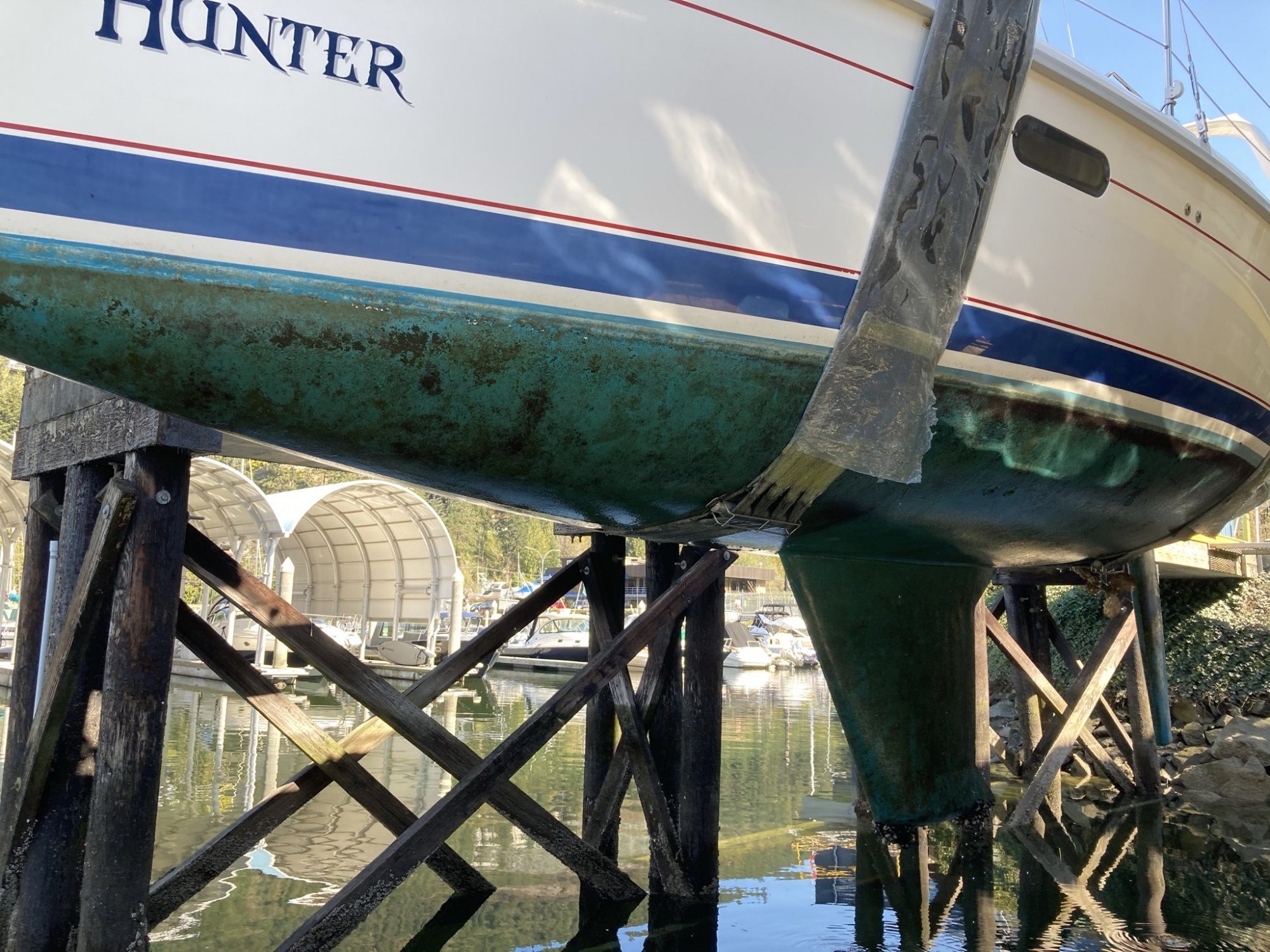

Check my invoices from July 03, 2014 to May 01, 2019. The big 2013 invoice for bottom painting could not be found. All half lifts with the exception of the last one (May 01, 2019) which showed a full haul out for the bottom painting plus compounding the exposed hull.
Many variables affect the life expectancy of bottom paint. My hull is covered with only a light film of slime at each half haul out. Here is a picture of the 2021 haul out:
It is not cleaned in the water between haul outs and can't say I've ever heard of anyone around here needing periodic cleaning in the water.
How do you dream up this rubbish ? Yes, it's a single season paint in MOST places like every other paint. But not in this area. And "8 months is realistic". Give your head a shake. Hauling every 8 months ?
Listen carefully "THE LIFE EXPECTANCY OF A BOTTOM PAINT DEPENDS ON LOCATION". And the Pacific Northwest seems to be a great location for copper based ablative bottom paint.
