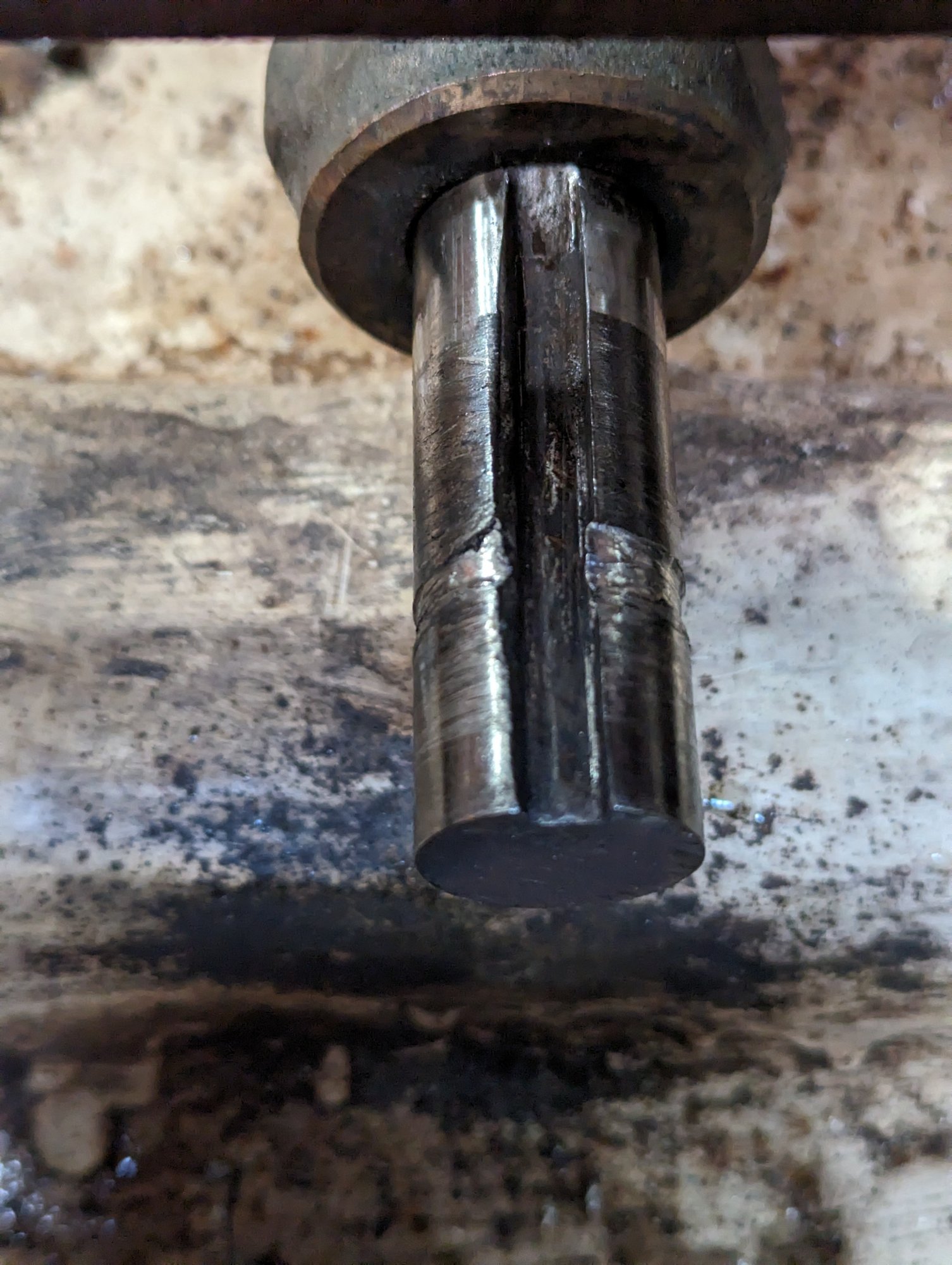

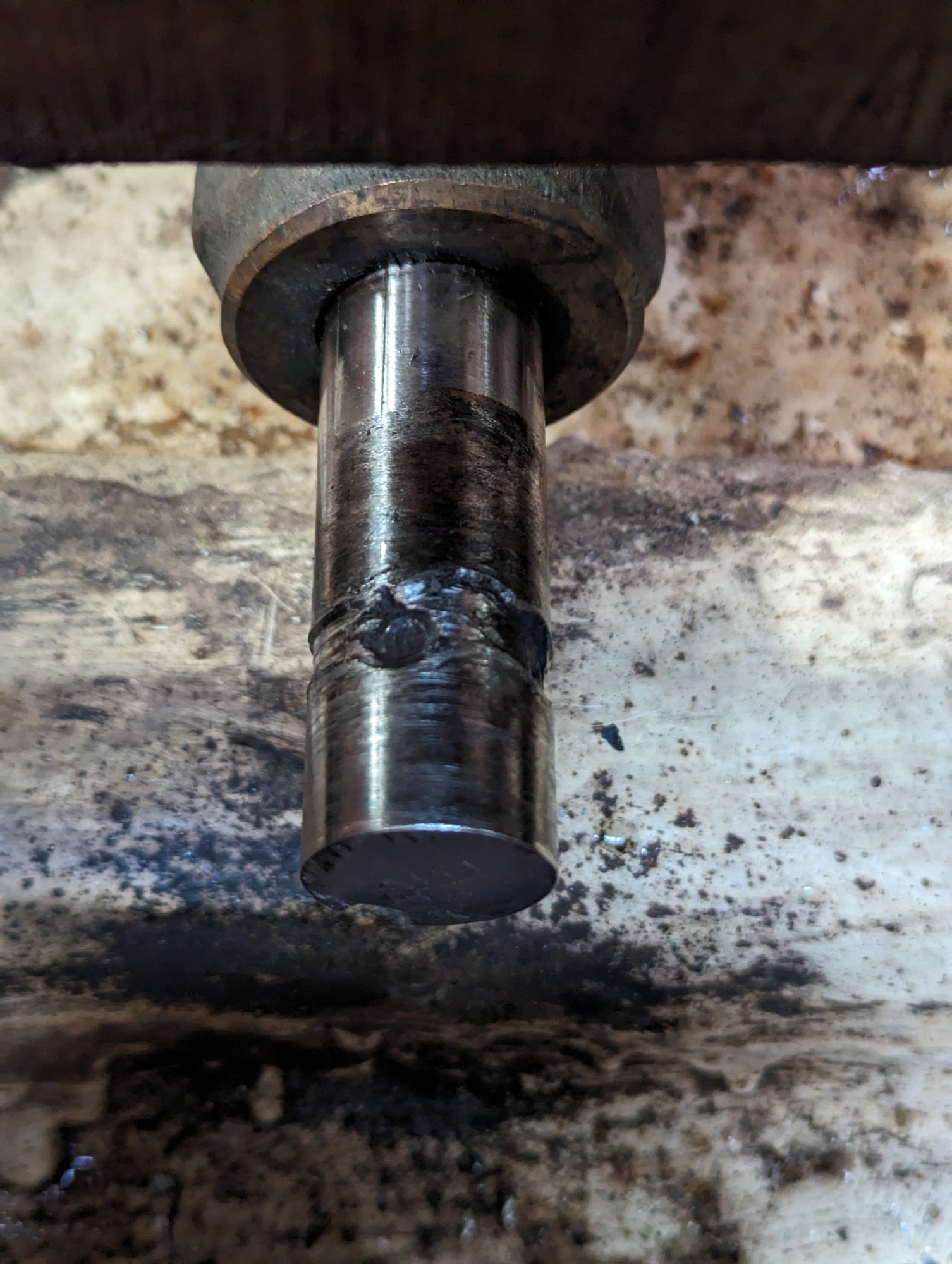

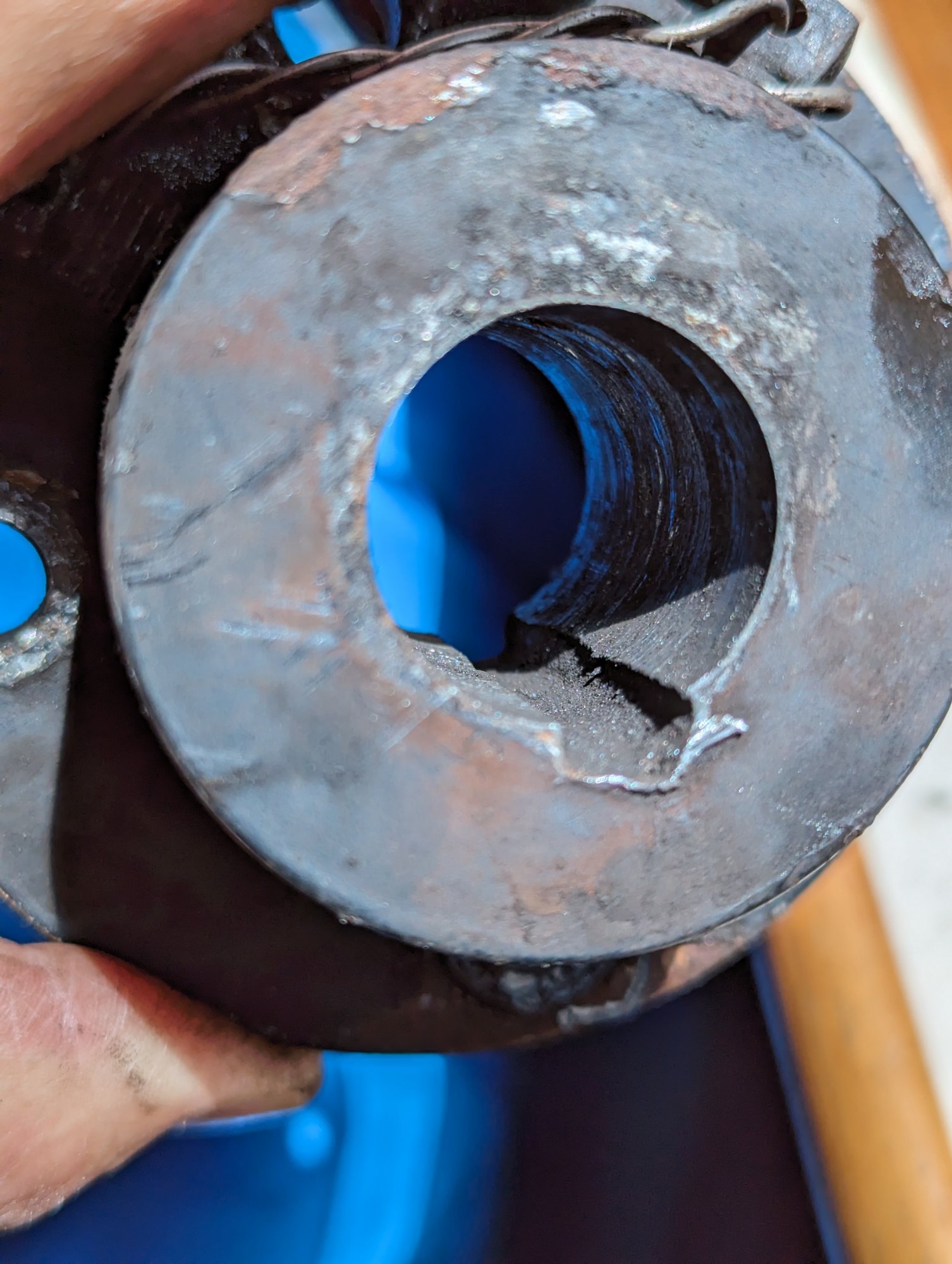

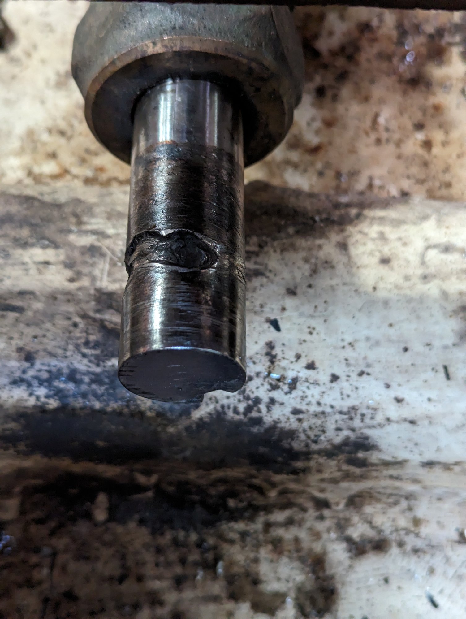

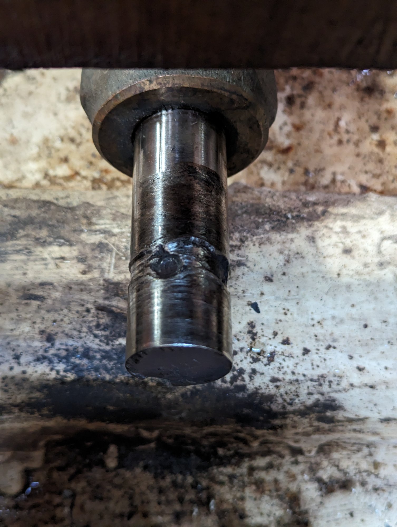

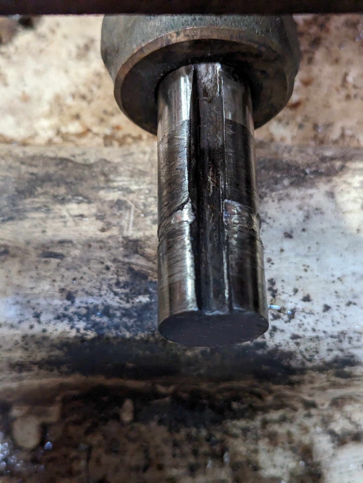

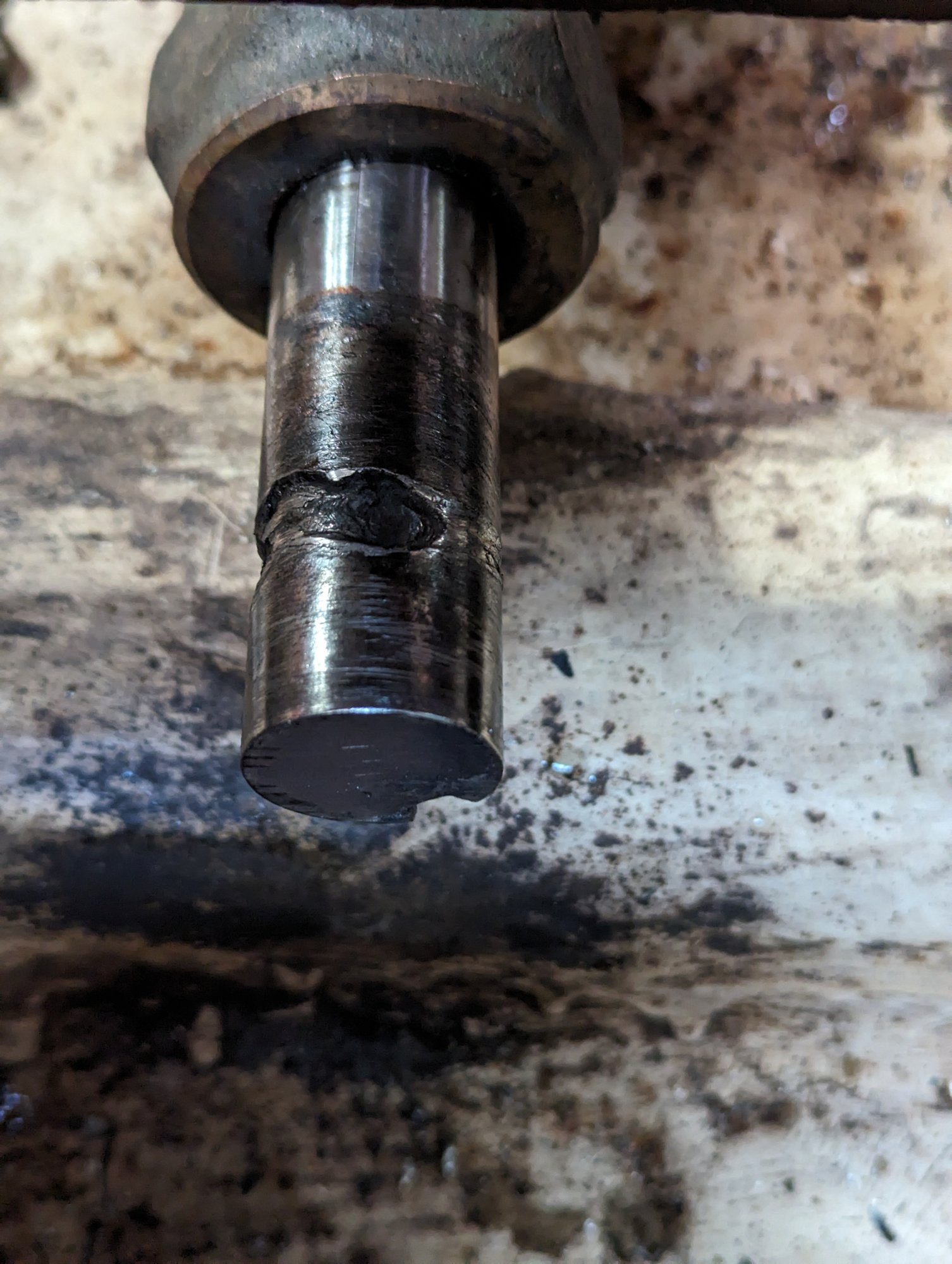

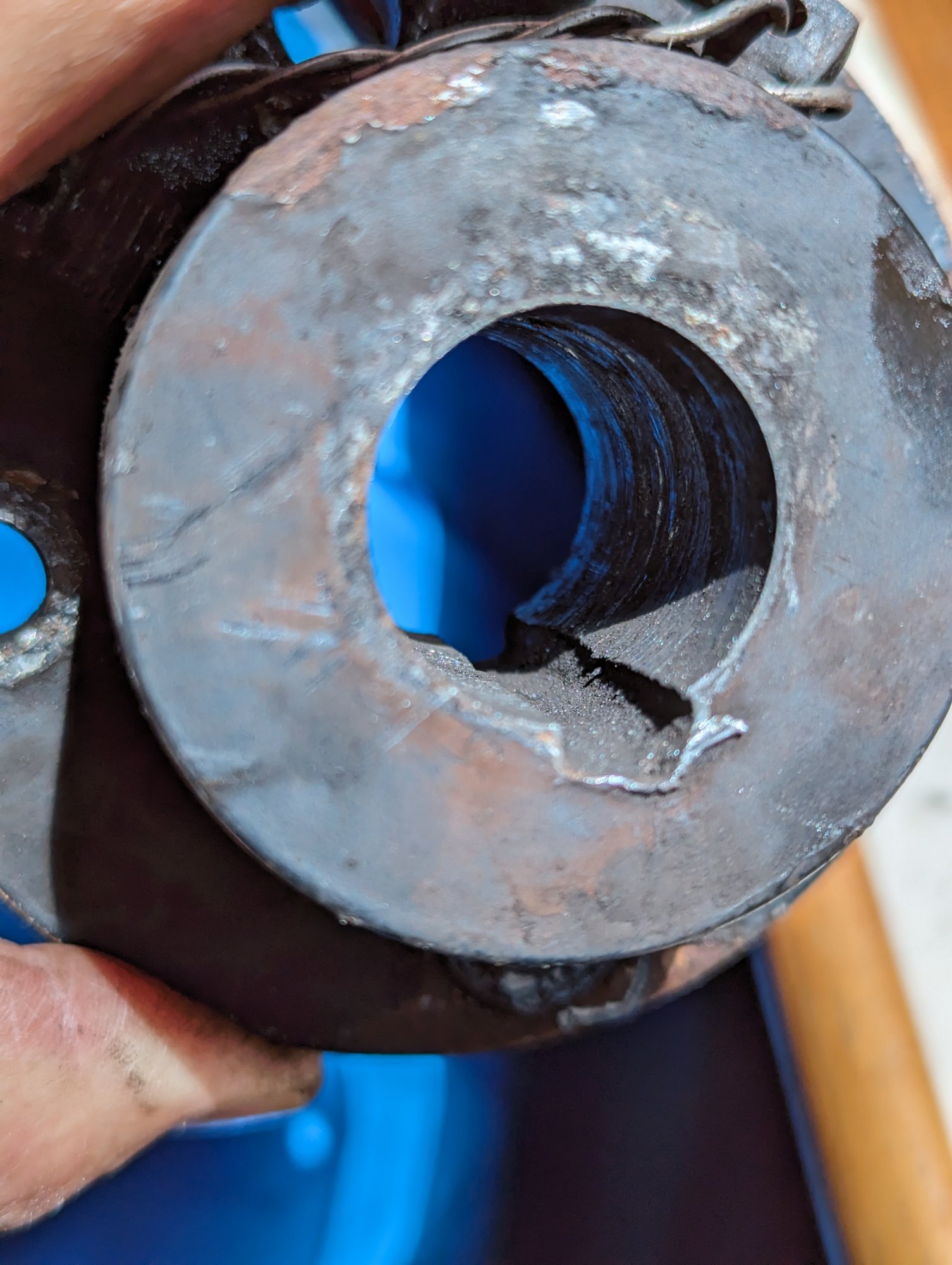

For anyone still following this thread, my recent event may provide new stories. Immediately post-launch after winter this year, I took my 2002 Hunter 386 went through open water for 2 hours to get to my club. Got there, put it in reverse, and the prop stopped spinning. Had to get shepherded into my slip. Hoped it was just low tranny oil. Turns out that the previous owner had removed the key between the coupler and the shaft 8 years ago, and simply torqued down the set screws to hold it. Lasted 7 years and maybe 200 hours with me. Now, I am going to install a split coupler but have no plan to machine the faces. The end of the prop shaft has some serious scarring, but the coupler will clamp down on it, at least for the season.
13,451
The deep scarring from the set screw is a concern, however, not visible to the naked eye is the wear on the shaft from the constant movement of the coupling against the shaft. I'm not convinced that you will be able to clamp done on the shaft with sufficient pressure to have a reliable coupling, especially without a key in the keyway.

Is there a reason you cannot put a key in the key way?
Do you plan to replace the shaft at the end of this season?

From the photos it looks like the Key groove is gnarled
Agree….but even part of a key in there is better than no key. Those divots from the set screws look pretty bad and I think will continue to deform around the shaft…eventually failing.
If the shaft has not worn evenly, i.e., the shaft is no longer round, it will be more difficult to develop enough clamping pressure to ensure the shaft does not slip in the coupling.
Replacing the shaft sooner rather than later would be prudent. That, and get unlimited towing.
And put a zinc or something inside the boat or in front of the P bracket to keep the shaft from spinning right out of the boat!
