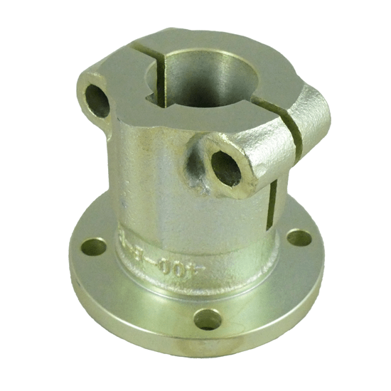

Interesting - any thoughts on the pros and cons of a split coupler? It seems to introduce the potential for more play in the coupler on the shaft as there are more moving parts. Would require specific torques and loctite on the securing bolts too?
It seems to be the way to go if you've got deep pockets, and in particular, if you've got a mechanical seal rather than a stuffing box. Me, I can't afford to travel in those circles.
The big pro is ease of installation and removal. Because it is easy to remove and install there is less opportunity for damage to the transmission, shaft, and coupling. When installing the coupling is snug getting the nuts as tight as you can with a ⅜" ratchet is enough although there is probably some engineering document with a specific amount, however there were no instructions about torque.
The key and key way prevent slipping.

I don’t have a split coupling. When replaced my shaft, I didn’t think about using a split coupling. But I should have.
A year or 2 after I replaced the shaft, I decided to upgrade to a Volvo dripless shaft seal. But of course, this meant removing the coupling. Mine was still new enough that it wasn’t too hard to get off, but I think a split coupling would make that easier. And eventually, I will need to replace the Volvo shaft seal…and by then my coupling look as bad as the one I replaced when I replaced the shaft…and that one took 2 days to press off :-(

I used a split coupling to replace the 35 year old coupling removed. Cost for the split coupling was not much. about 18% of the new shaft and machining for the shaft to fit & face
Price varies based on shaft size and length...
From Fisheries Specifications:
All things being equal, split couplings are easier to install and remove than solid couplings.
• Order a "No Bore" coupling for machining a custom shaft size
• "No Bore" split couplings come with a 3/4" to 1-1/4" pilot bore
• codes for transmission types permit matching to your transmission bolt pattern: A=Allison, B/W=Borg Warner, C=Capitol, H=Hurth, N=Newage, P=Paragon, TD=Twin Disc, VP=Volvo Penta, Y=Yanmar, ZF=ZF
There appears to be a corrosion reduction coating on the coupling. With the association of saltwater I expect surface corrosion will occur. I will try to minimize this so that the coupler can be reused in the future, but it is likely that the coupler will need to be refaced so I see it as being able to save the shaft and the coupling becomes a consumable.
I did not have a specific torque value. The coupler was a press fit. There is a bronze key used to match the couple to the shaft. I used lock washers and tightened the bolts as much as possible.

… it is likely that the coupler will need to be refaced so I see it as being able to save the shaft and the coupling becomes a consumable.
Can you clarify what you mean by this? Why would it need refacing, and how does it save the shaft?
I have a 1” shaft with a Yanmar transmission. Couldn’t I put a 1” split coupler with Yanmar bolt pattern on without any further modifications?
24,750
Sure.
My old coupler was rusted onto the shaft. After inspection of the stuffing box the shaft was damaged and needed to be replaced. I cut the old shaft.
A new coupler gets milled to fit the shaft. The face that gets milled at 90 degrees to the shaft and milled smooth to face the transmission.
If you can remove an old coupler undamaged you’ll want to assure you can fit it back on the shaft and that the face will be 90 degrees to the shaft. If not the alignment of the shaft might be a problem. Just like your disk break’s rotor. They surface the parts for a perfect fit. If there is not enough material to surface you need to replace, or try to reassemble and then attempt to realign.
