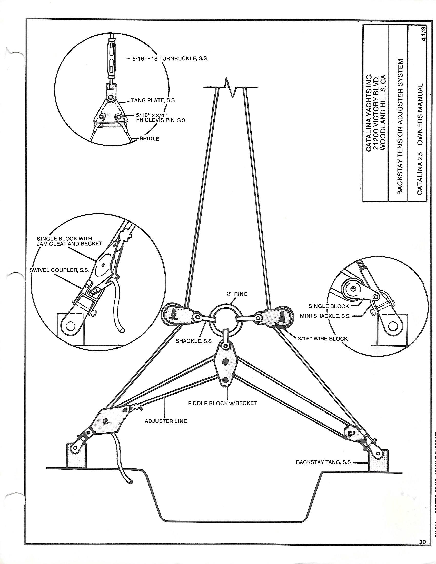

I am very new to the Catalina 25 world, so forgive me if I say something stupid. Just bought a 1987 WK with standard rigging. If C22BC's Catalina 25 has a split back stay, wasn't it originally designed to have the tensioner. I have no idea how much length one will take up (doesn't seem like much), but your rigging's length was possibly cut with that in consideration. I know Catalina direct has the Back stay adjuster system as an improvement, but I think C22BC's 25 would need the original tensioner at a minimum. If you replace your back stay, you might want to consider going with the Back Stay adjuster. My understanding is it gives better mechanical leverage than the original system, and if you trailer it will take the place of having a quick release lever.

You should be able to add the tensioner without unstepping the mast. I can't think of a safe way to put on a back stay adjuster without unstepping the mast. If you have your boats manual, it should have a drawing of your tensioner. This is the drawing for a 1987 Standard rig. If you don't have all the parts, I would think it would be about the same cost or cheaper and much better to change to the back stay adjuster system. To see the adjuster system, go to catalina direct, select catalina 25, then select rigging, standing rigging, shrouds. It will be in the top row. There are two there for standard rig, not sure what the difference is in them. If you select Catalina 22 and follow the same selections they have a picture of the backstay adjuster installed. I believe it is very close to the same design except the 22 is 12:1 as opposed to the 25's 8:1.

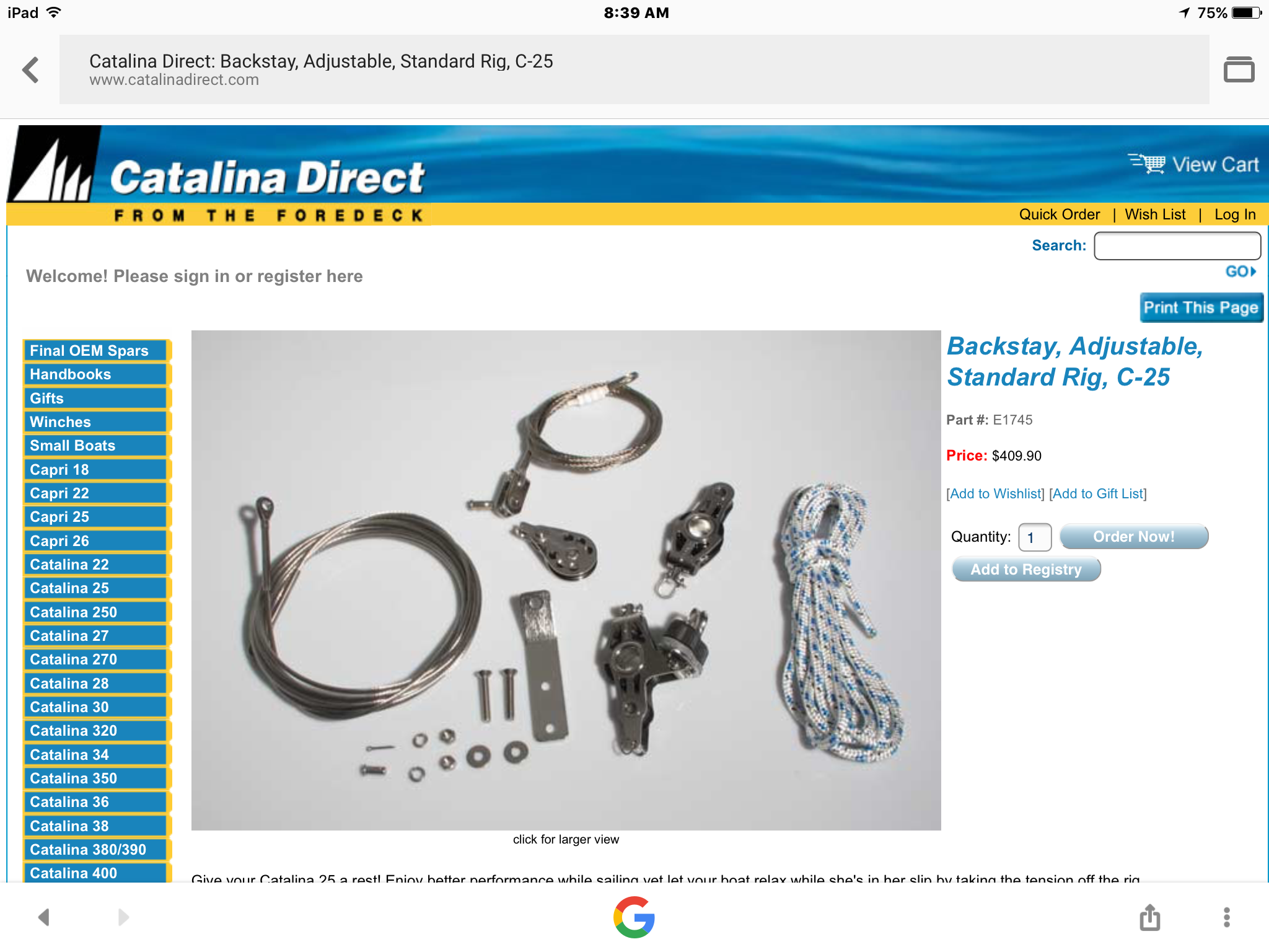

I like that system and how it works with existing chain plates , I still can't figure why the extra cable comes with the kit maybe it's the back stay replacement as well . We sold our 22 last fall and just bought this '84 SK /SR in Feb , way more rigging then the old 22 . Shooting for April sail .
Checking owners manual

This is what I'm finding , I guess I could go to West Marine or somewhere similar with diagram and buy pieces . Thanks for the input .
