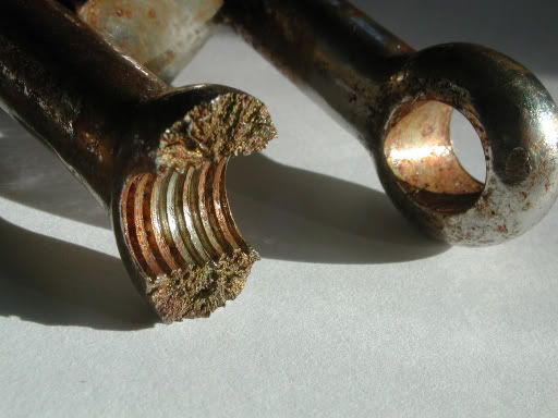

Crevice corrosion begins nearly immediately once stainless is devoid of oxygen and in salt water. These effects are cumulative. A number of yeas ago I dropped a $350.00 stainless Schaefer genny car over board one day while washing my boat. I dove but could not see nor find it without a dive light. It was three weeks before I could get a diver to retrieve it. The block was destroyed and heavily pitted in a very short amount of time sitting in the very silty soft mud. I tired to polish it but it was to no avail as the surface was so pitted.

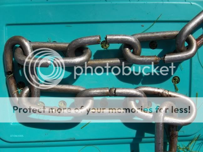

An important point about stainless chain is that the welds on stainless chain have usually not been relieved or passivated from the welding process as it is quite expensive to do this, even for quality anchor chain companies like Acco, Peerless etc. who sell 5/16" ss chain for $20+ per foot.. These welds may develop crevice corrosion relatively quickly, within days, under water and cannot easily be inspected. They can also develop galvanic corrosion because the weld stick is not always the same composition as the extruded chain stock.
The main point is that stainless can be destroyed when buried in oxygen-starved bottoms in SALT water. This is part of the reason the alloy in prop shafts is not 316L though at the surface the oxygen content in the water may be hing enough to prevent crevice corrosion & micro stress cracking.

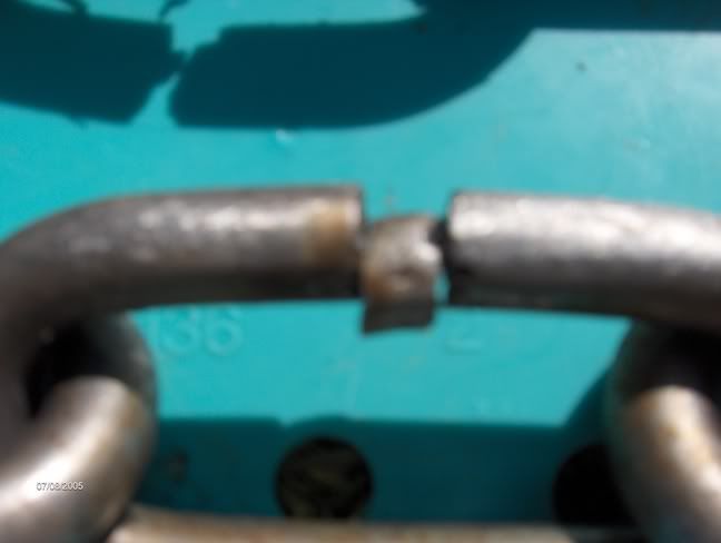

These photos of stainless chain were posted on another forum by a member for RI.

You'll probably never have a problem with your size boat but do be aware that stainless can fail with little warning while still looking fine and that any crevice corrosion or micro stress cracking is cumulative. It's just good info to know.
