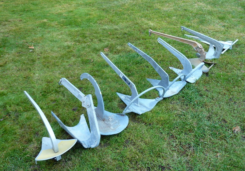

Does anybody have any experience with the spade anchor, or know anybody who has?
I own two, one aluminum & one steel. I would not invest your money in the aluminum version. The nice thing with them is they can be broken down.
Back row you'll see them:

Mainesail, You have enough anchors for a ten day cruise. But do you have enough chain and rope? ;) ;)
