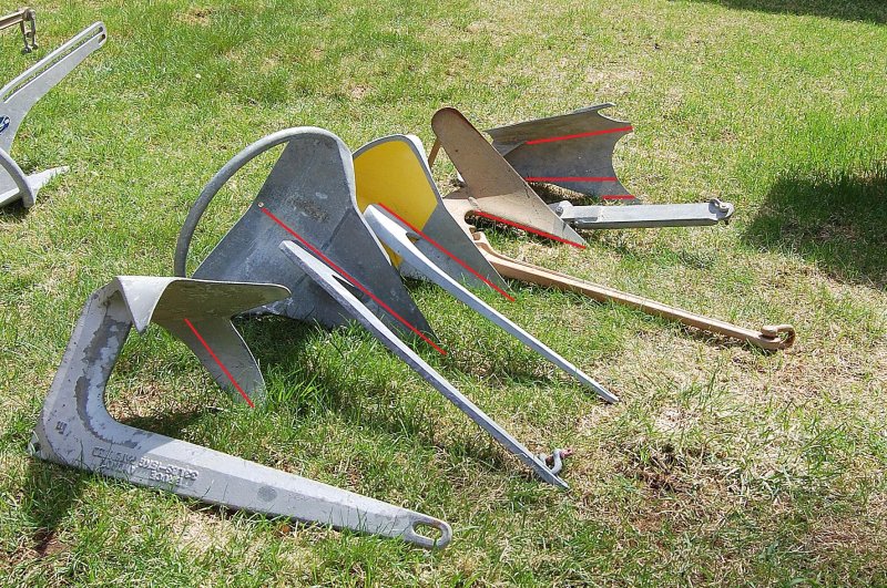

With all the threads on anchoring this week I thought it a good time to do another comparison. This time I took my 35 CQR and my 33 Rocna to a hard sand intertidal area to compare how they act while being set.

Both anchors were set up exactly the same on the same exact hard sand only inches from one another so the densities could be as close to identical as one could hope for. There is no trickery here just actual performance under the same identical situations.
