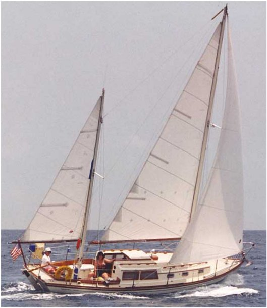

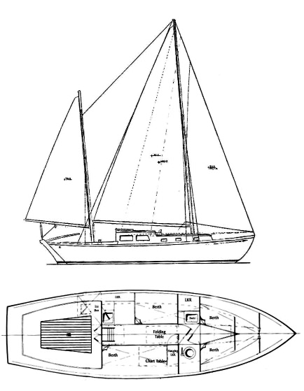

Glad you decided to join us Dakota. Welcome and congrats, I think< on your boat. No boat owner wants to pick up their new boat and have their mast fail. I hope this was more expected than a surprise.

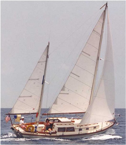

Looking at boat data on your Bermuda 30, it is reported to be a "masthead" rigged ketch.
Do these images look about right?
The upper image gives us some indications as to the original sail plan. It shows foresails, those sails that are attached to the forestay, coming in different sizes and hoisted to the top of the mast where the forestay is secured. You should have a "JIB HALYARD" that is used to hoist your foresail.
  1. It would run through a sheave at the mast head and down the inside of the mast to an exit box about 8-10 feet above the base so that you can reach up and draw the halyard down to tie off on the mast.
  2. Or you can attach a block to the mast head and run your halyard down the outside of the mast. This is really old school and has the draw back of the halyard banging on the mast during a windy night. Wood spars make less noise. Aluminum spars sound like a clanging bell.
I am a bit confused why you are referencing the H28 when you have a Bermuda 30.

Thanks for the reply, jssailem. Yes those are the designs for our boat. I have it rigged to the masthead through the sheaves that came with the mast. They are external halyards (and quite noisy in a blow, we keep them pulled out with a bungee).

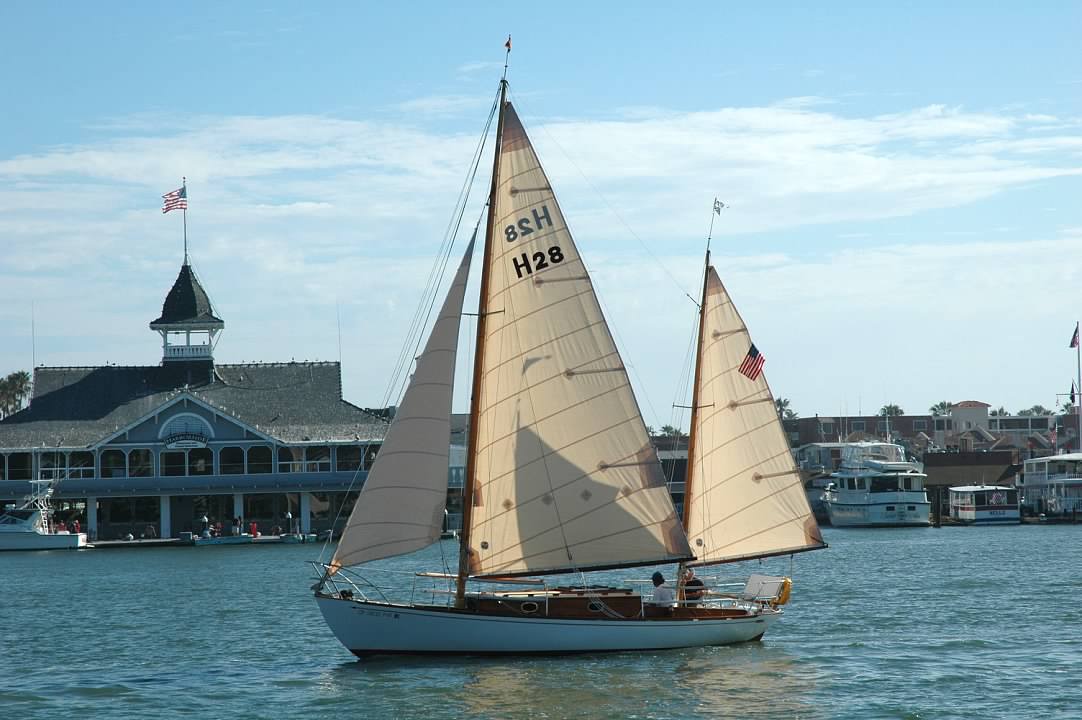

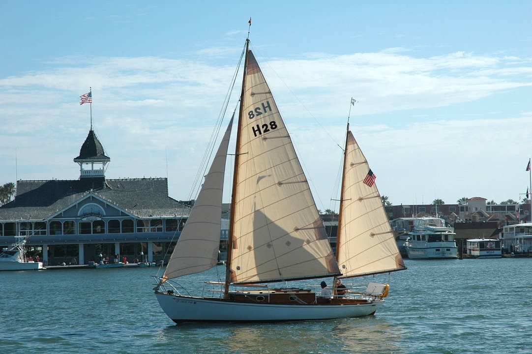

this is sorta what I’m talking about. This is an H28 with the jib attached lower than the masthead. Our original wooden masts had a tang in this same spot but I didn’t include it in the new masts, I just ran them to the tippy top. It’s been working just fine...just wondering why there would be a difference or if I should add a tang just for the jib?
we usually run a very large Genoa on the Bermuda, as it is pretty underpowered and the summer winds are quite light in the PNW.

It is a little difficult to clearly discern, however, the Herreschoff 28 looks to be a fractional rig, not a masthead. The extra lines may be spinnaker halyards.
14,182
Dlochner, are you talking about a baby stay? We could definitely use one! But these this design looks different than most baby stays I’ve seen on other boats
No, a baby stay is different. It is used to keep the mast from pumping and to induce bend in the mast.
In the poster, it might be a solant rig. This is a twin headstay and allows for flying 2 headsails in down wind conditions. When one headsail is used it is usually flown on the inner forestay because it can't be tacked on the outer forestay.

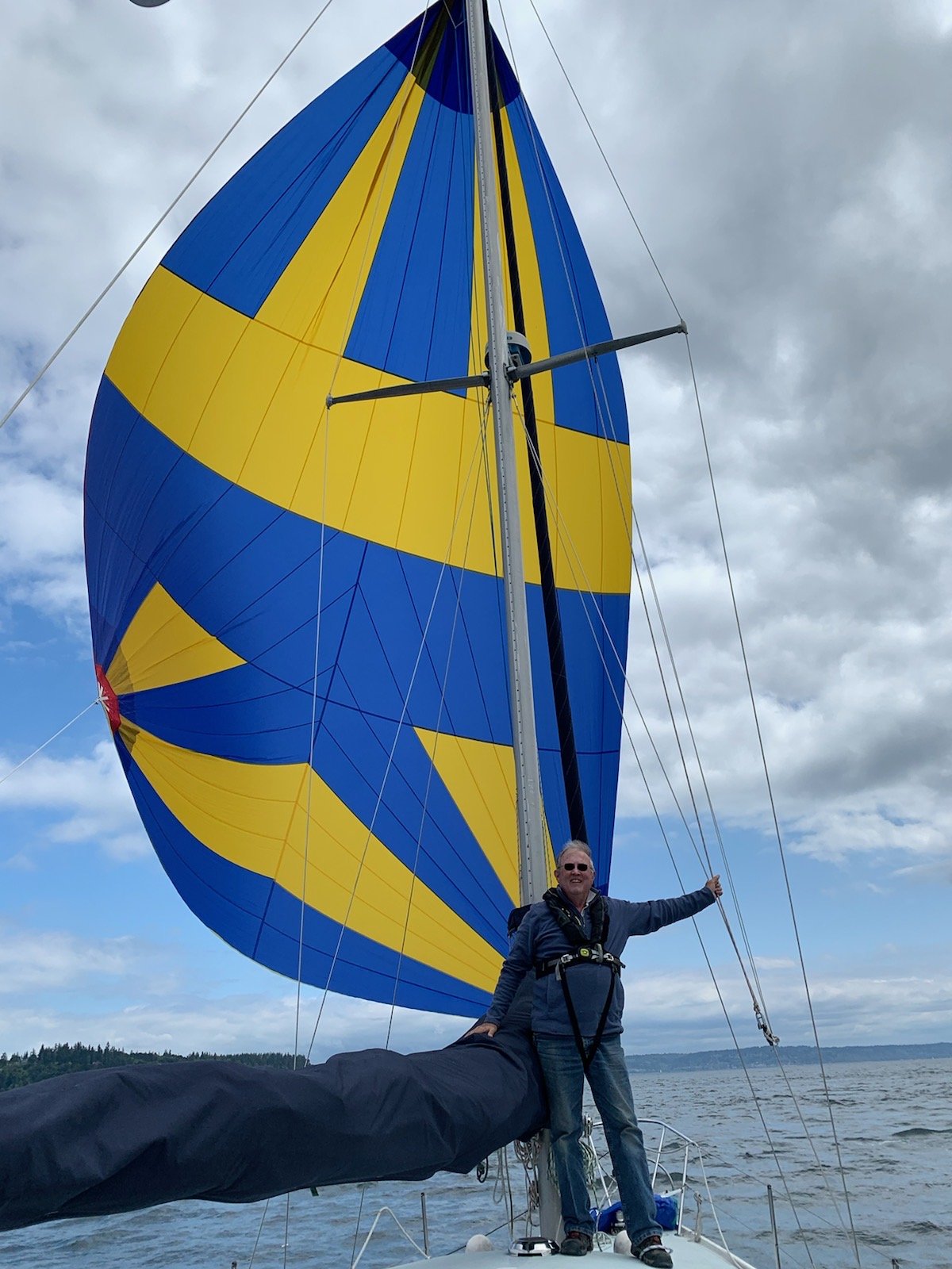

A consideration of the light winds is to use a light sail. An Asymmetrical is a reasonable option of your boat. Besides the pretty nature of the sail, it can proved a lot of cloth to capture the wind and move your boat along.
I added one this year. Flying in a seven knot breeze, on Possession Sound near Hat Island (Gedney Island if you're looking on the charts).

This is a very old design which may be a way to have a fractional rigged jib without the need for running backstays or jumper stays. If the original mast had a jib halyard at (just under) both the inner and outer stays it could have been intended as a solent rig. These days, a solent is considered to be an inner stay, close behind, and parallel to, the forestay. The idea of a solent is to have more versatility in sail plan. Use the solent (smaller inner) jib for heavy weather or upwind sailing and set the outer jib or genoa for light air reaching and running. With modern roller furling this can be a great, versatile setup.
The rig would, of course, need to be designed to accommodate the loads and attachment of the inner stay. If you are happy with the performance of your rig without the inner stay then no need for the added complications.
You can get similar results to a solent by using a smaller (110% ish jib) and a code zero on a furler set just forward of the forestay. This may require a small bow sprit, fixed or removable.

Sail Boat Data calls the Bermuda 30 a Mast head rigged ketch.
This data from sail boat guide. supports that claim,
Rig and Sails
TypeKetchReported Sail Area377′²Total Sail Area 300′²
Mainsail
Sail Area175′²P27′ 0″E12′ 11″Mast Height?
Foresail
Sail Area125′²I29′ 11″J8′ 3″Forestay Length31′ 1″
Based on the I and P reported lengths.

hey that’s great! Please do! We have a drifter sail that we use for light winds but I’d probably be happier with an actual asymmetrical.

Not trying to :hijack: this but as I have a goal to try to learn something each day I saw this as an opportunity :)
In the photo there are several “stays” leading off aft of the main masthead.
One appears to support the top of the mizzenmast mast so that makes sense to me (I think ;) ) I think one of the others I see is perhaps a topping lift.
To my eye there are two more:
Are these both backstays for the main? If so would you have to drop the mizzenmast sail so it’s boom wouldn’t contact them during a downwind course?
