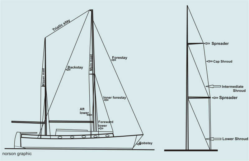

The image appears to have dual back stays for the Main mast.
Perhaps this diagram can shed light to your quest for names of the stays..

Standing rigging on a Ketch.

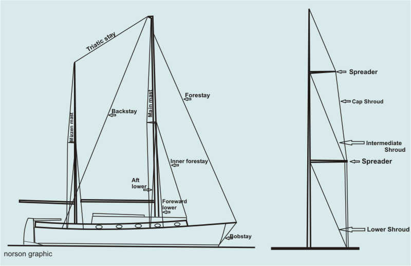

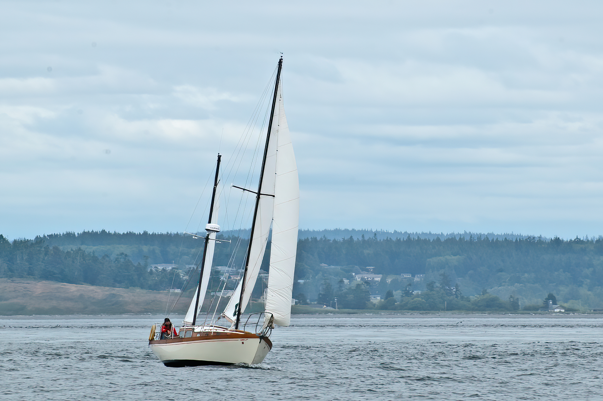

Thanks. Now that I look at the line drawing and again at the photo Jon posted it’s obvious the backstays are more or less inline with the base of the mizzenmast so the downwind contact thing probably isn’t a concern.
The triactic stay is interesting, sort of like the forestay for the mizzenmast AND something of a backstay for the Main.

ohhhh yes the triatic or king stay? All the stays for the main mast stay clear of our mizzen boom, however the MIZZEN mast has twin backstays that only allow us to wing the boom out to say...a deep reach. I’m planning on changing them to shorter spectra stays with block and tackle to create running backstays to allow the mizzen boom to wing all the way out.
PS I seriously thought the lady in the photo was topless the first time I saw that pic too...

is the girl in the photo topless?
it's fair to assume that boat gives a relaxing ride :cool:
Now everyone is going back and zooming in to take a look..
At least I did.:biggrin:
Yep!
Droptop!
