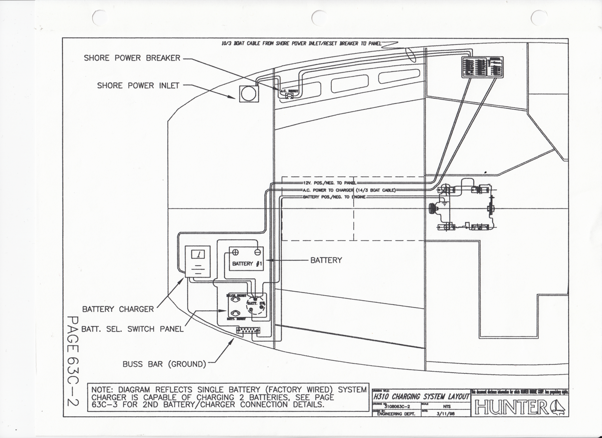

This is why I was hoping to locate a diagram for the Hunter.
Don't waste your time looking for a copy of the charging system of a Hunter. This is mine from my 1999 H-310 manual that came with the boat as new. I've kept the copy resolution as high as possible but the wiring at the alternator and starter is just chicken scratches.
Jul 7, 2004
8,542
Hunter 30T Cheney, KS
Thanks Ralph. That was the diagram I don't have for the 30T. It does show how you'd expect the alternator output to travel to the AB switch. I really need to trace mine because I don't see any wires behind the switch that might be it - just to what I think is behind the cockpit control. Thanks again.

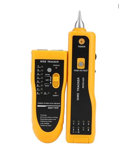

Justin, have you ever played with one of these :
I bought one of these over 10+ years ago looking for a wire in the boat. I paid next to nothing for what I thought was a real piece of crap. I was within inches of heaving it into the ash can until I started to get the hang of using it. Nothing in the instructions about the finer points of using the tracker. It was an art, more than anything else but I got to where I could trace a wire, stashed in bundles, from one end of the boat to the other in one fell swoop, usually more often than not. It did the job for me.
Fast forward 10+ years and I'm sure they're vastly improved from what they were back then. Probably don't even have to be on your boat to trace the wire :biggrin:.
Likes: Jkutyna

Interesting. I have never seen these before. I thought I had all the cool gadgets.
I didn't want to be 'that guy' but as a former naval nuclear electrician, this was my first bit of advice to you. After 30+ years, nobody has a boat that is OEM anymore, so asking what others have isn't going to be too useful. You can get a toner/tracer on Amazon for as little as 20$ or less now a days and it will save you soooooo much time.
