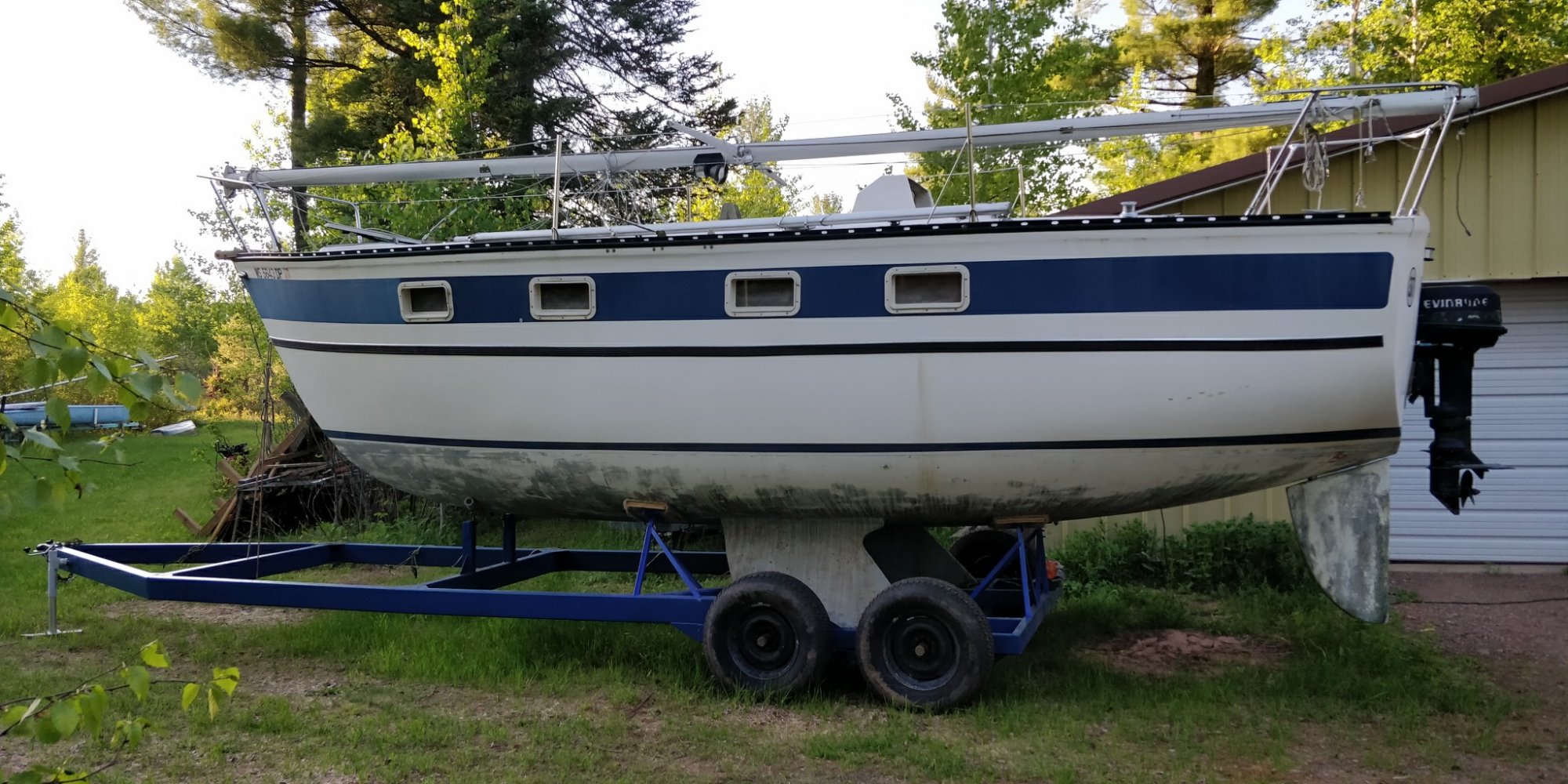

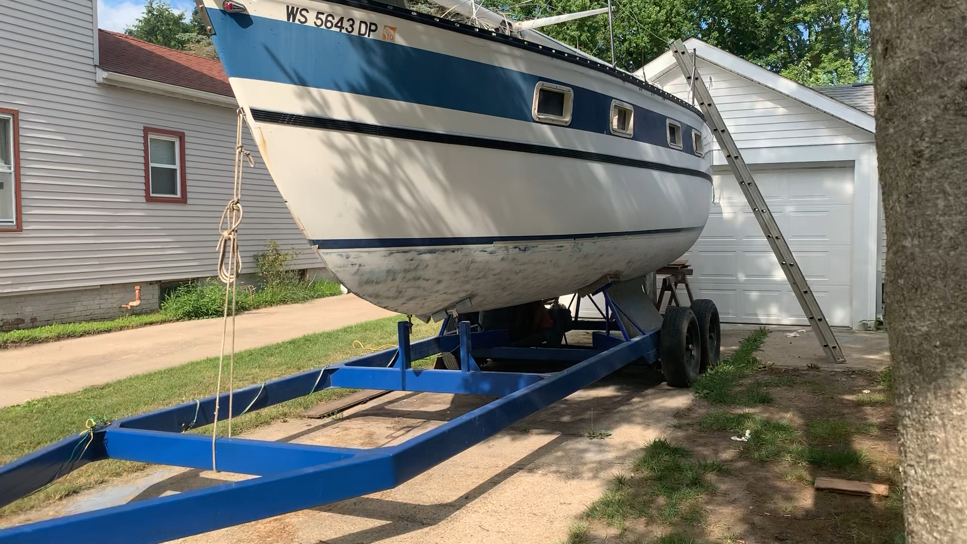

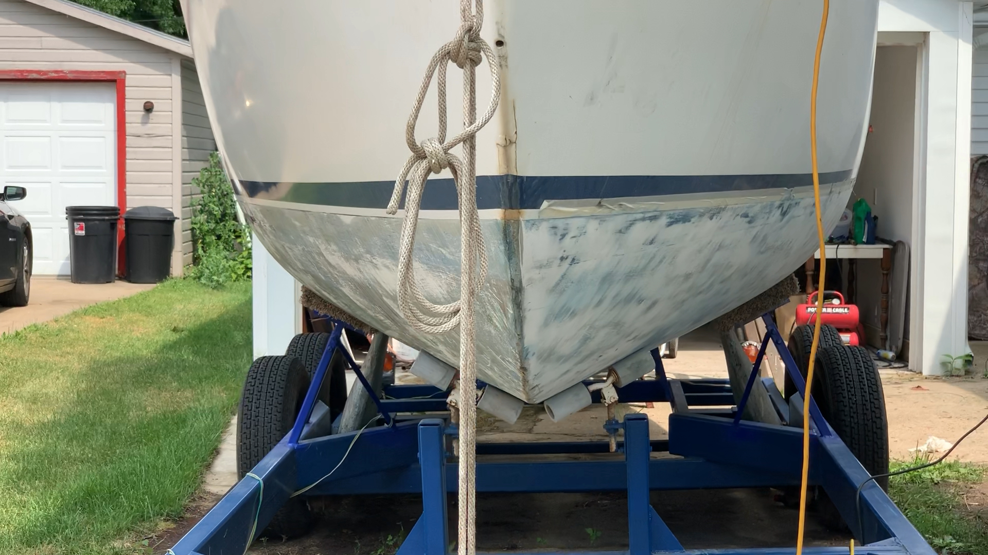

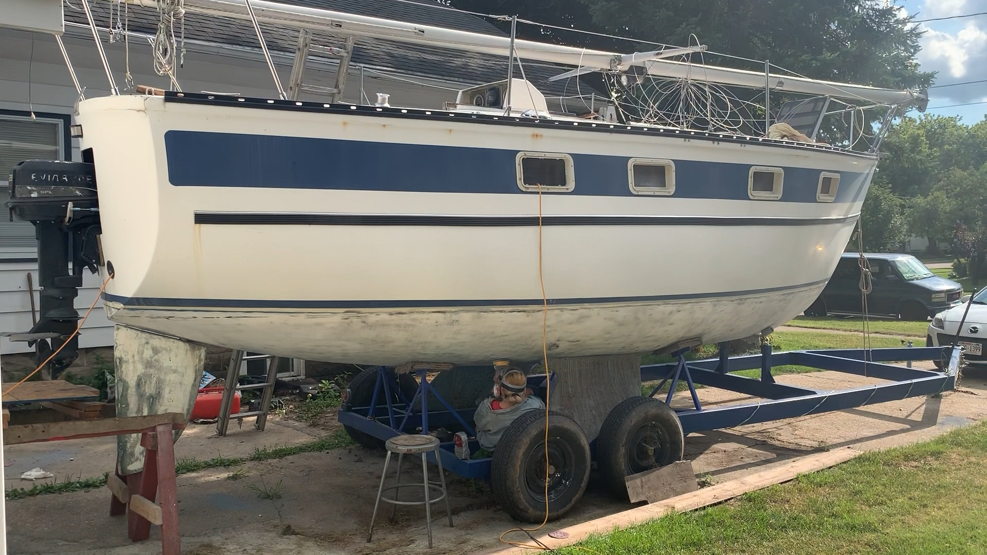

I am stripping my sailboat's bottom back down to the gelcoat. I'm new to sailing and have a few questions I've been meaning to ask.
First off, I've felt a bit overwhelmed the past few days. While at first, we were able to get a lot of paint off fast - getting that last 5% has been exhausting. I've noticed more dinks in the boat stem, some large areas of delamination on the rudder, and I'm not sure what direction to go with these keels. My goal is to get the boat ready for the water asap. I want to sail this year yet. I've really been looking forward to the chance of asking other sailors plainly - What should I do next? What steps would be your top 5 to get this boat ready? Barrier coat is normally the next step, but I haven't been able to find a definitive answer online to the question: Is this sanded enough yet? Is 95% of the paint removed good enough before barrier coat? Can barrier coat go over small areas of delamination without first gel coated? What would be the easiest way to get the remaining 5% of paint off? Thanks!
Before Sanding:
After Sanding:

After Sanding 95%+ of the Bottom and Barrier Paint:

Welcome to the forum!! Lots of great questions and applaud you on doing this project yourself and great progress so far!! My wife and I sanded and painted to our first sailboat bottom and that was enough to give us some experience.
To remove the last 5% of paint consider stripping with a paint stripper/scraper or blasting with sand, bicarbonate of soda (baking soda, which is much less aggressive than sand and easier on the underlying gel coat) or dry ice (the impact of the very cold dry ice pellets provides a thermal shock to the painted surface that aids in breaking up and removing the old finish AND blasting medium sublimes into carbon dioxide gas, leaving only the paint residue to clean up) by a qualified contractor.
The yard did the following procedure a year and one-half ago after purchase of my Hunter 46 as a result of barrier coat failure, particularly on the keel due to lack of maintenance by the previous owner. Grind out all the corrosion products from the keel, fill in any cracks and voids with epoxy. Check the hull for dryness with a marine moisture meter to be sure it is ready for barrier coating. Then apply 5 - 7 coats of barrier paint followed by 2 coats of antifouling paint. Might refer to the following link entitled "How to barrier coat and bottom painting boat" and "A Smorgasbord of Tools and Patience are Required for the DIY Epoxy Barrier Coat Removal".
Apr 26, 2015
663
S2 26 Mid On Trailer
Rudder: You may be able to inject some epoxy through small holes in the rudder and clamp the area. It might stick it might not. I did this and it worked for awhile or until our first 115 degree day on the trailer when the skin expanded. I'm going to rebuild the rudder this fall. A delaminated rudder is a failure waiting to happen since the load paths cannot be maintained.
Bottom: When we did our bottom on our 26' boat, 2 years ago, we sanded until it was all gelcoat. One way to tell if the barrier coat will stick is to take a clean rag with a serious solvent on it and very slowly wipe an area. If anything is on the rag keep sanding. I wore out a palm sander and the new one is on it's last leg. If you have any blisters or any scratches, repair them now before barrier coat. We had over a hundred dime sized blisters.
Keep sanding and good luck. Another Pulp Fiction fan.
13,059
Go to Lowes and buy a 5 lb bag of garden lime and put it in a 5 gallon PVC bucket. Add two full cans of drain-O to that and then just enough water to get it to a melted peanut butter consistency while stirring. Spread that slop on the stubborn parts with a paint roller on a pole. Let it dry, pressure wash it off and most of the paint will come off with it. For the one or two stubborn spots, I use citrus strip and a scrapper.
DO NOT LET THIS STUFF GET IN YOUR EYES. Wear goggles and gloves.

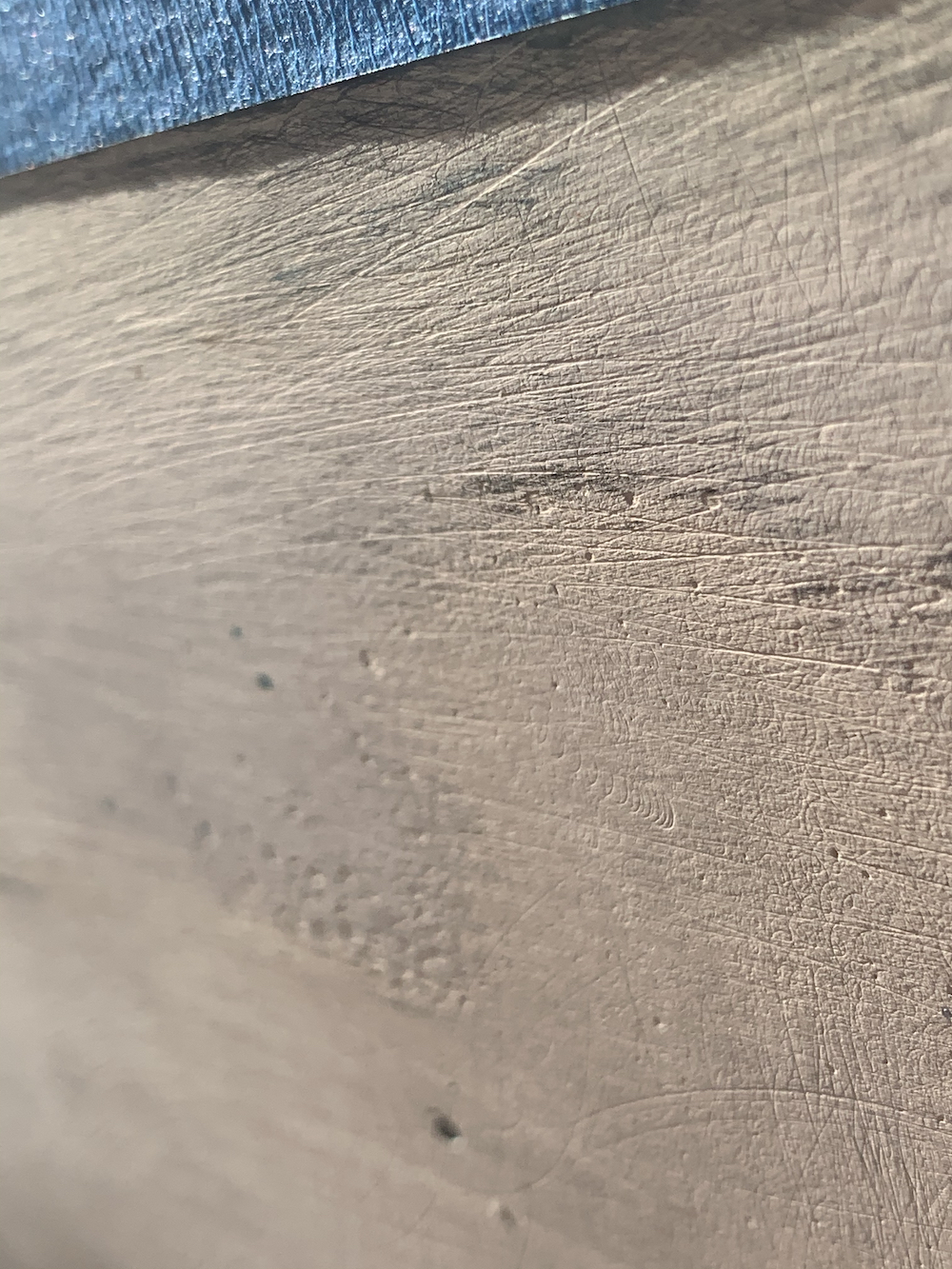

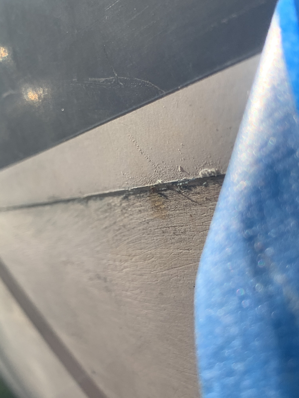

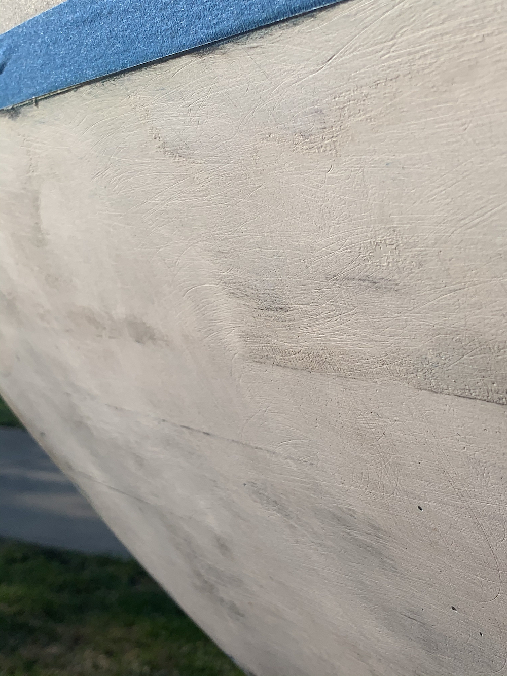

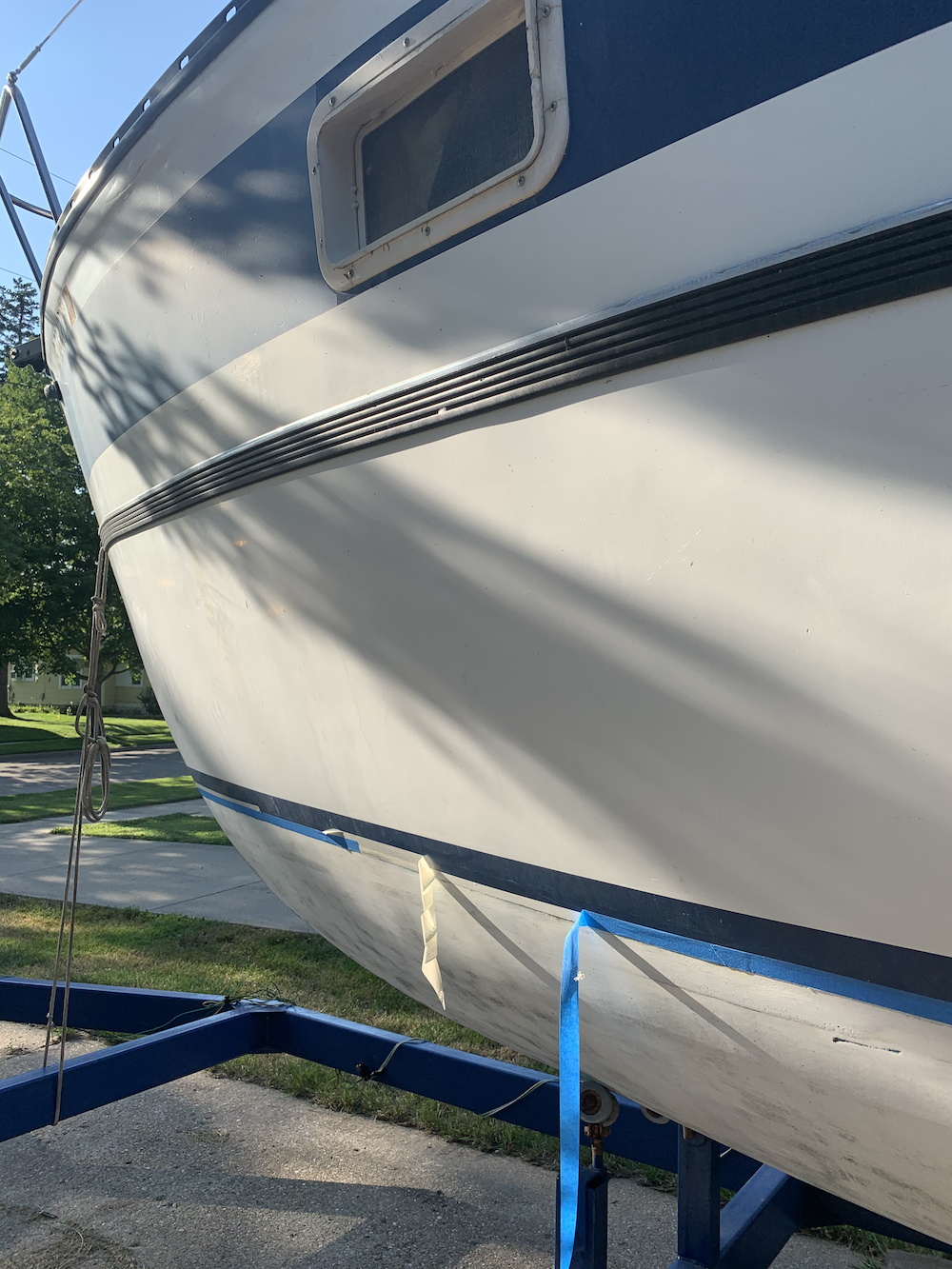

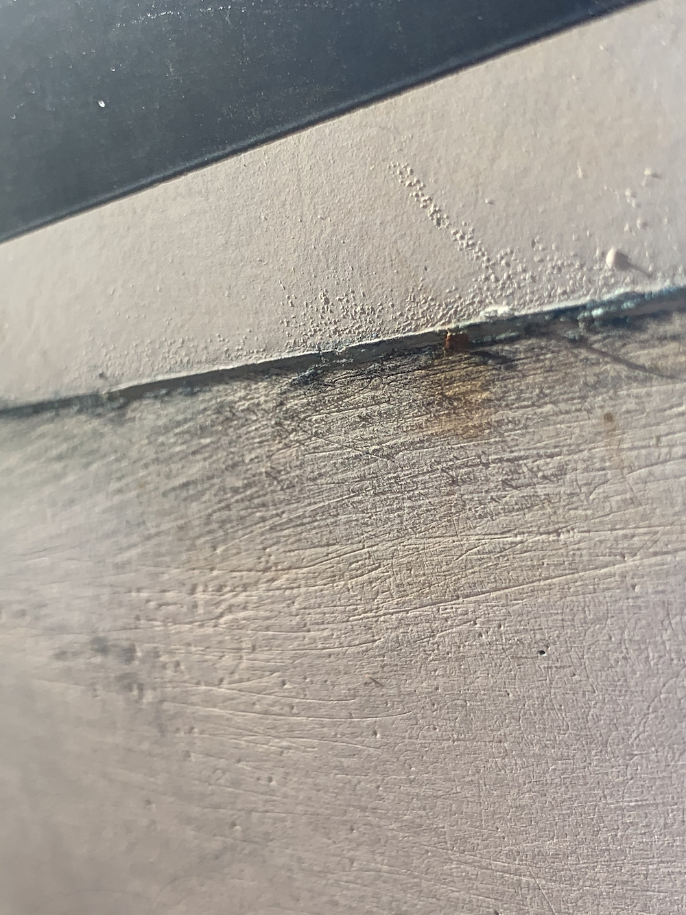

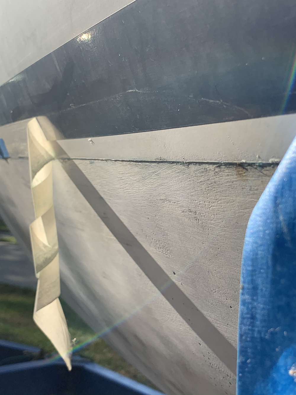

@Davidasailor26, I've added close up pictures of the paint "ledge" and "white" layer. I added a few extra pictures to fill in the scene too. Is this "White" layer gelcoat or epoxy barrier coat? Thanks
Bootstrap Paint Ledge:
More Bootstrap Paint Ledge:

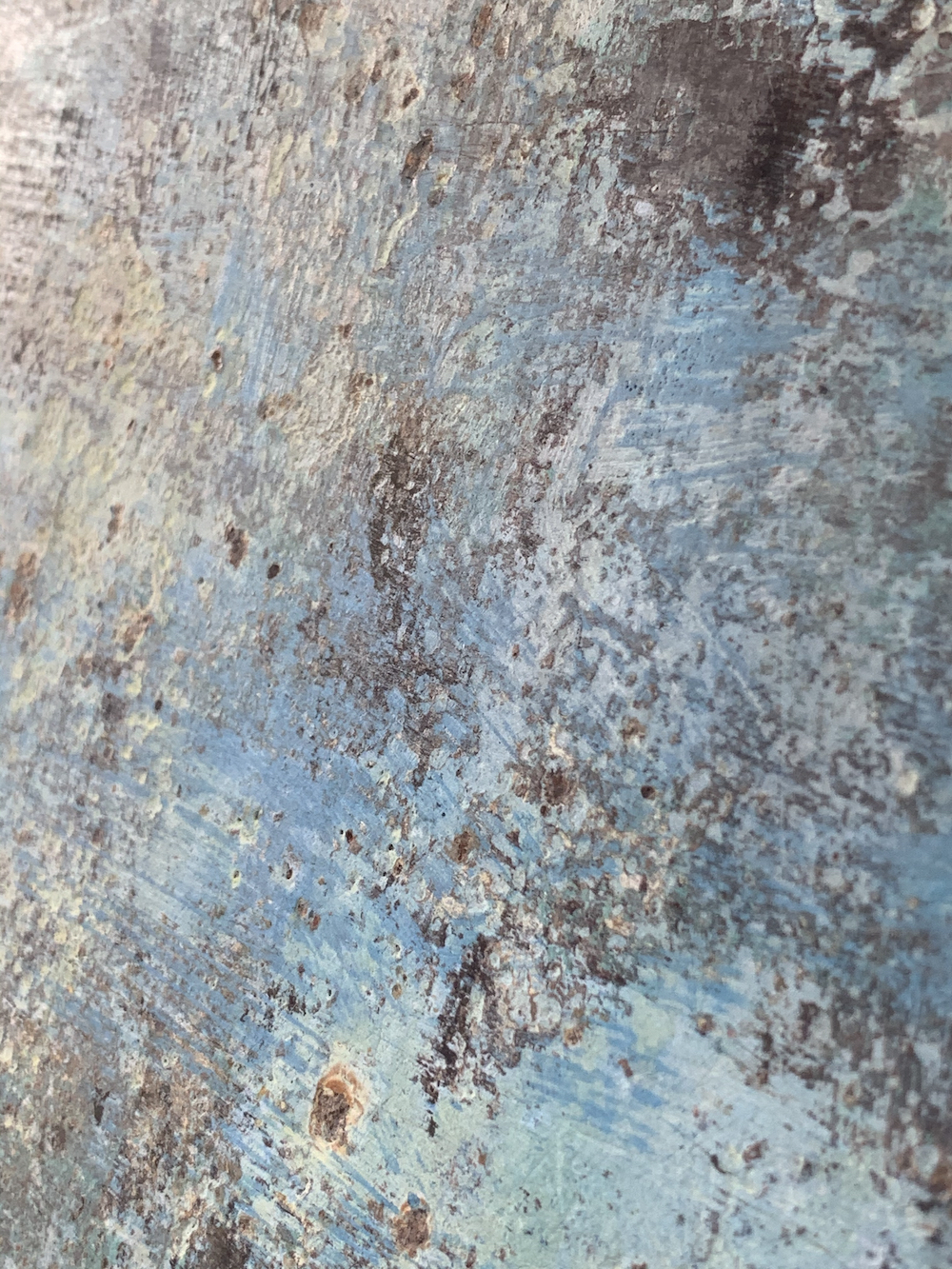

Keel Texture After Some Sanding and Acid - Any idea what color the iron is here?
Gelcoat or Epoxy Barrier Layer?:
May 17, 2004
6,241
I’m guessing you’re getting down to gelcoat, not any previous barrier coat. It doesn’t look like there’s any distinct edge at the top of it, and it doesn’t look like there’s any color change in the places it’s scratched through.
On the keel, I’m thinking the solid metal is the relatively smooth homogenous looking gray color in the top right of the picture.
