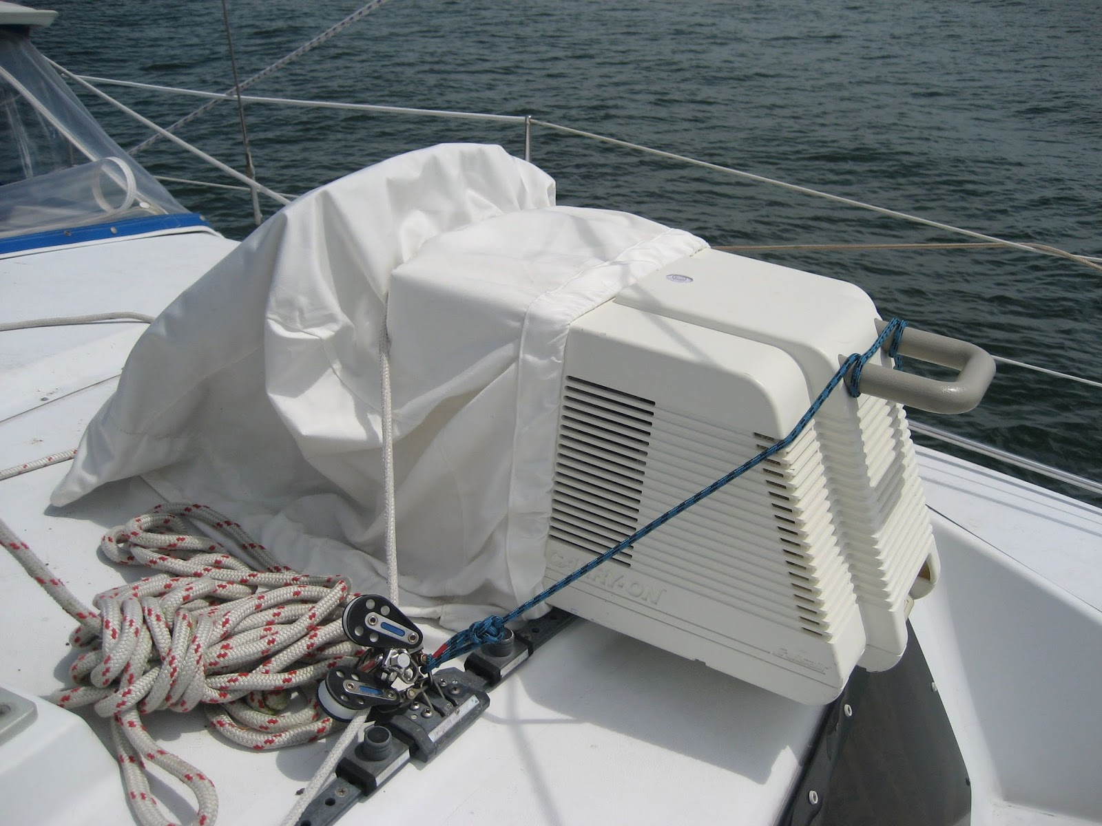

I used a cruiseair-carry-on on my 32 foot Ericson and it did a great job They fit over a cabin hatch . Cooled the whole boat down. The only downside was it was a bit heavy . They don't make them anymore. I still have mine, I'll be selling it as soon as I get around to it, my current boat has A/C.
Here's a pic of one

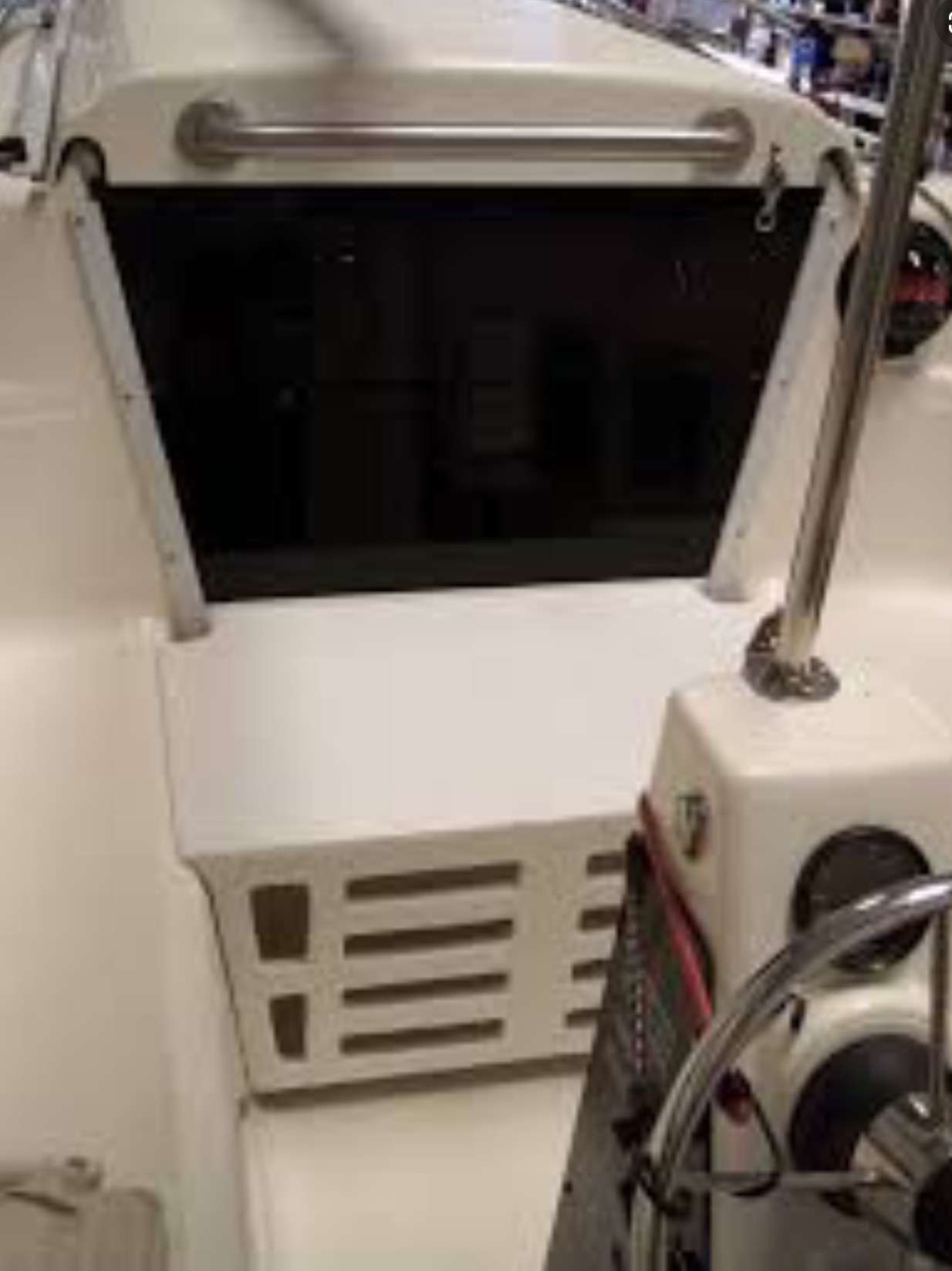

The previous owner of my first boat, O'Day 25, installed a small window unit in the aft bulkhead that vented and drained to the cockpit lockers. It wasn't what I would have done, but it worked for his needs to 'camp' on the boat at the slip and it proved to be nice when I was working on her on in the heat.
Personally after dealing with all the half baked 'fixes' on my O'Day 25 I decided we were only doing these things right. My Cataline 310 comes with an install AC system that also has head and is just wonderful. Happy wife loves it and we are going to carry a small portable generator this year for summer hot days to have a cool cabin while out on the lake away from the slip.
