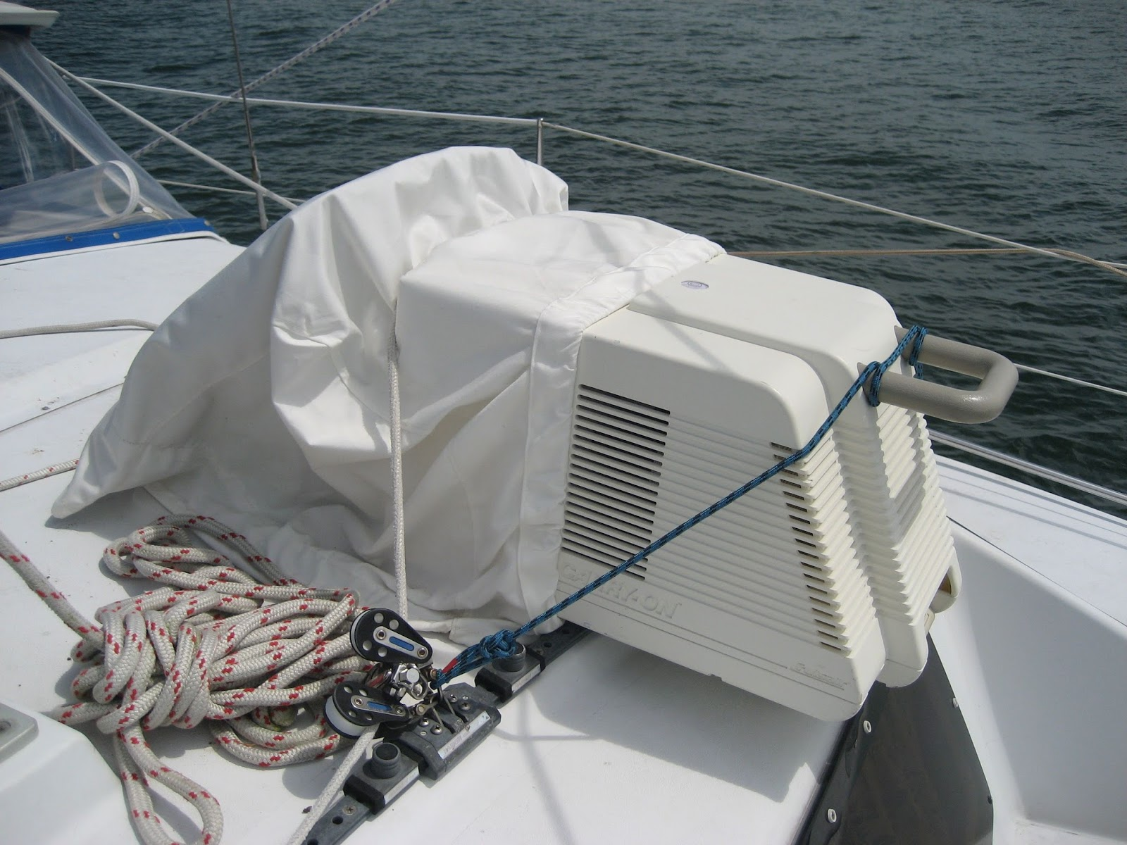

I tried to use one of the AC units with a hose on my Catalina 28 one year. One night when it was 90F and humid we turned it on. In the middle of the night I woke to a mist of water in the aft berth. The condensation on the cooling element was dripping onto the fan and shooting water into the cabin. It soaked the floor. And in the process the water on the plastic squirrel fan broke a blade and it made a horrible noise. These units were designed to be level. I tried to make it so on the unlevel cabin floor, but obviously when my wife and I were in the aft cabin the bow raised and the condensation ran forward in the unit instead of backward to evaporate on the hot side of the condenser as it was designed to operate. I repaired the squirrel fan and gave the unit away.
Instead I went with a small window AC unit sitting on the foredeck just forward of the V-berth hatch. I have a wooden shim at the forward end to level it approximately, but if the condensation does drip, it will be on the foredeck not in the cabin. I made a shroud out of Sunbrella to keep the part that is normally inside the windows out of the weather. I used Velcro around the V-berth hatch to make it water tight. When I tried it, I found that there was too much mixing of the incoming hot air and outgoing cold air through the V-berth door. I made a fabric piece that attaches to the AC unit between the air intake section and the outflow section and led it half way high through the V-berth door. It seems to do a good job of cooling the main cabin. The V-berth is still usable, but the fabric chute makes it harder to crawl in and out (although you can detach it and reattach it). The AC unit is small enough to lift through the V-berth hatch, and I normally store it on the side of the V-berth when we aren't using it.
After all is said and done, I would prefer a proper marine AC installation, but I don't use the AC enough to justify it.

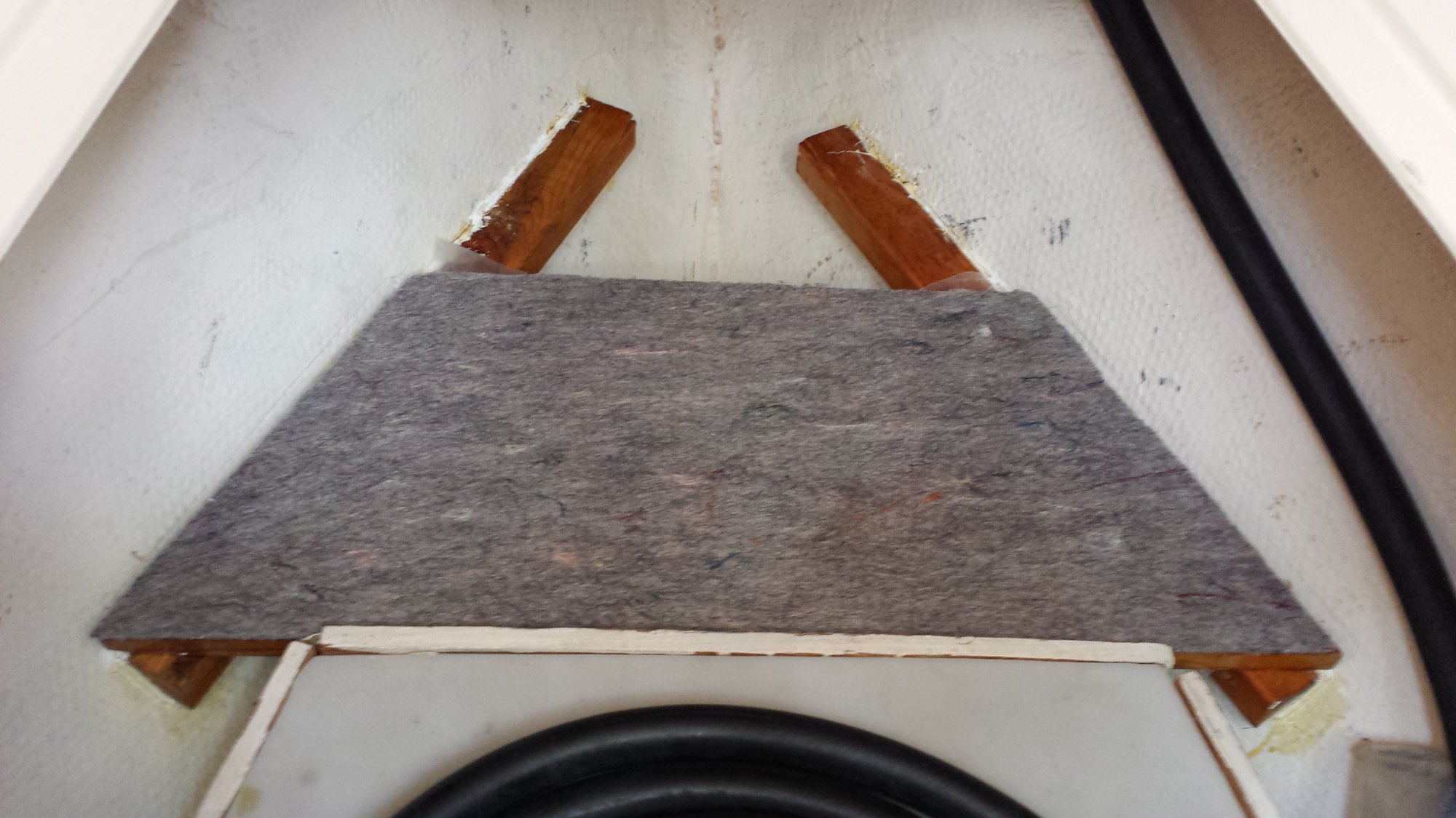

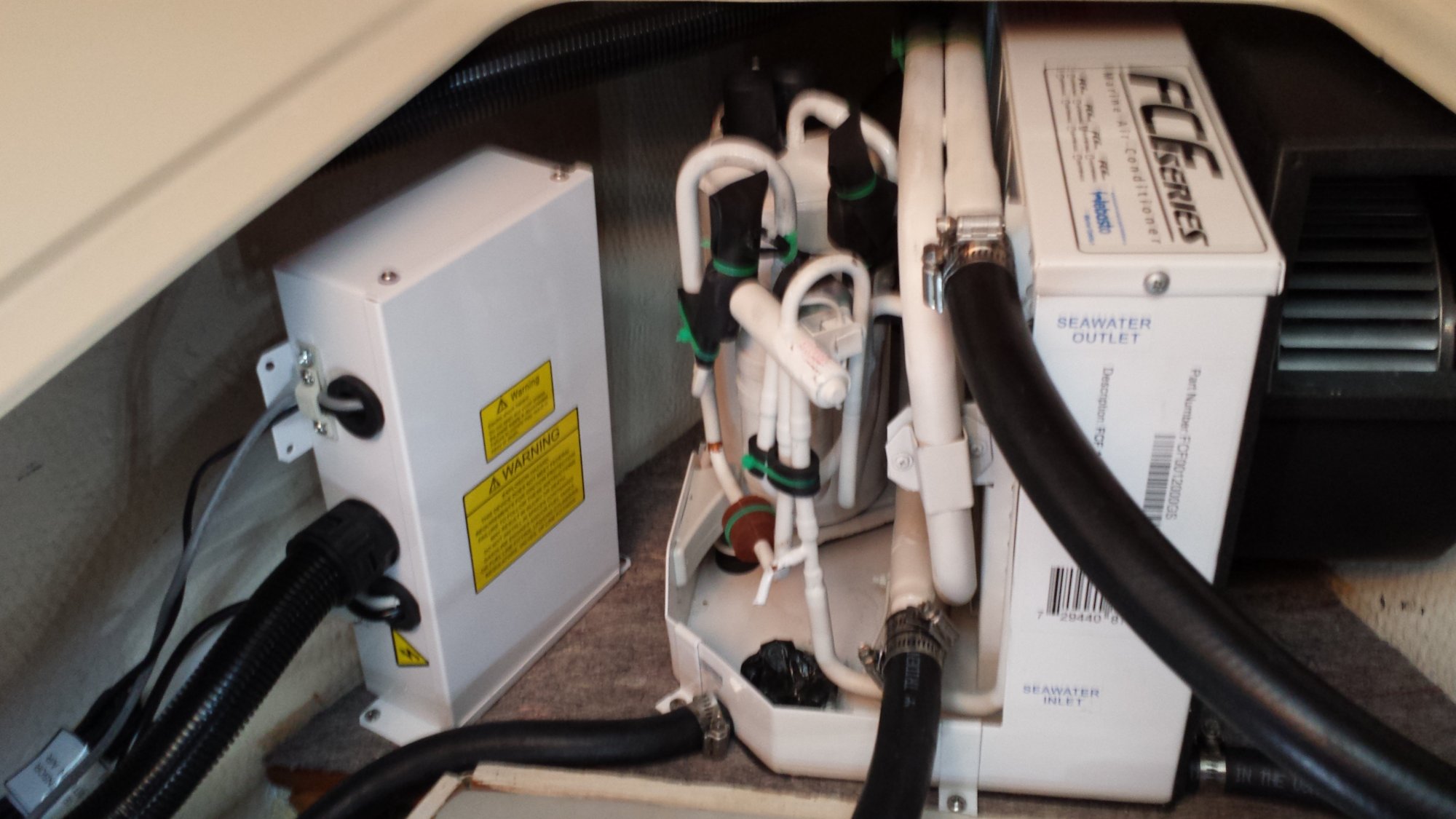

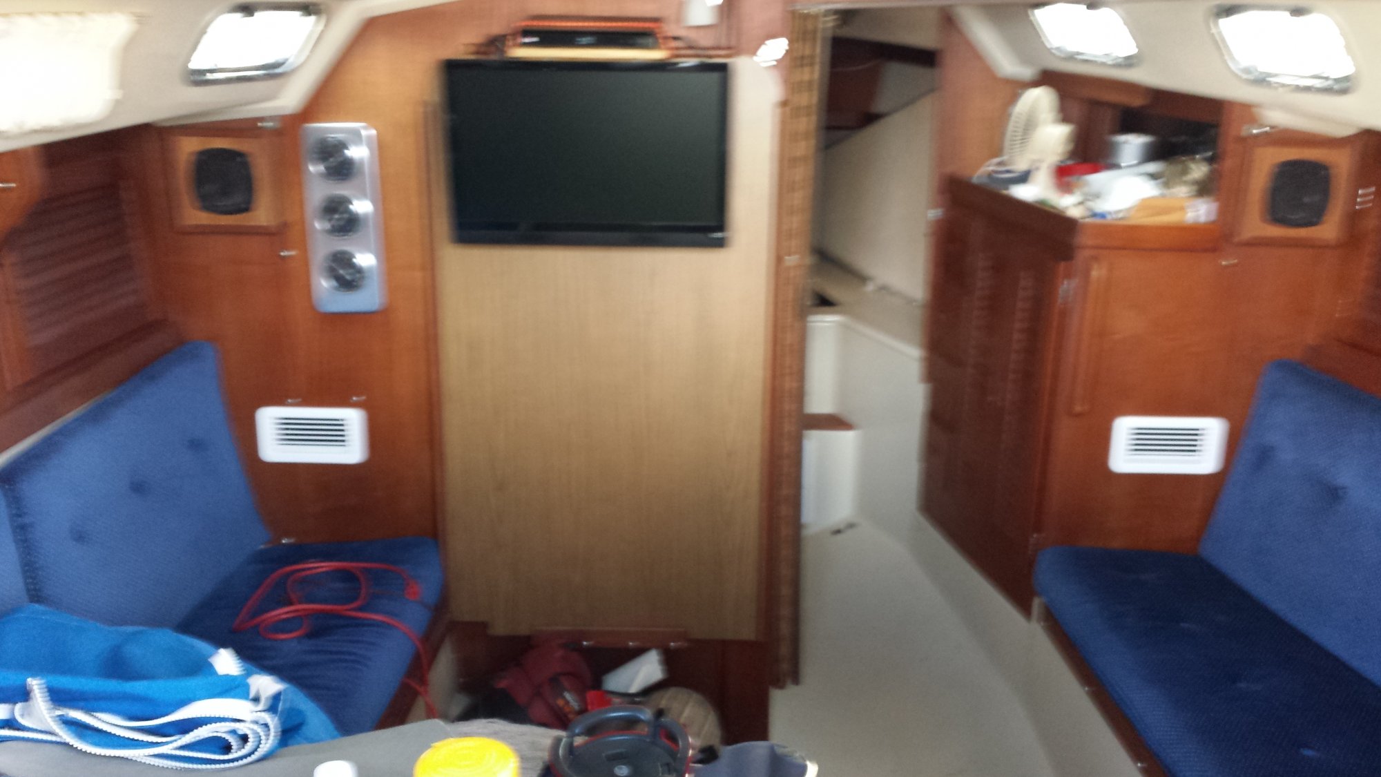

I have a 87 Catalina 30 and I also sail on the Chesapeake bay. I went down the road of a cheap widow air conditioner in the companion way (works well after the sun starts to go down and until maybe mid-morning). It was only a 500 BTU unit, so it wasn't too heavy, but still I was concern my wife would have difficulties moving it out of the way in an emergency (i.e. fire). So I went with this 12,000 BTU marine unit:
Webasto FCFK Air Conditioning Unit w/ Reverse-Cycle Heat - Complete System Kit
I installed it in front of the water tank in the forward v-birth. I built a small shelf and put some left over speaker mat on it to kill vibrations (the mat was left over from when my son built his sub-woofer enclosure for his car, the grey stuff). I ran one vent under the head's sink to the bulkhead on the port side of the settee and ran the other vent through the bottom of the hanging locker to the starboard side of the settee. I point the airflow a bit upward. To my surprise there is a slight breeze going into the v-birth, so I didn't add a small vent to it like I was planning to do. I sleep in the v-birth and the A/C is pretty quiet and doesn't wake me up. I put it in in 2016.
The shelf top is blow the top of the water tank to provide clearance for the top of the A/C unit.
The A/C unit before I install the vent hose Y slitter and vent hose.
The location of the vents (sorry for the blurriness). The air return vent replaces the teak access door for the front water tank cutoff valve (its slightly visible, its the extra white part below the teak step to the v-birth).
