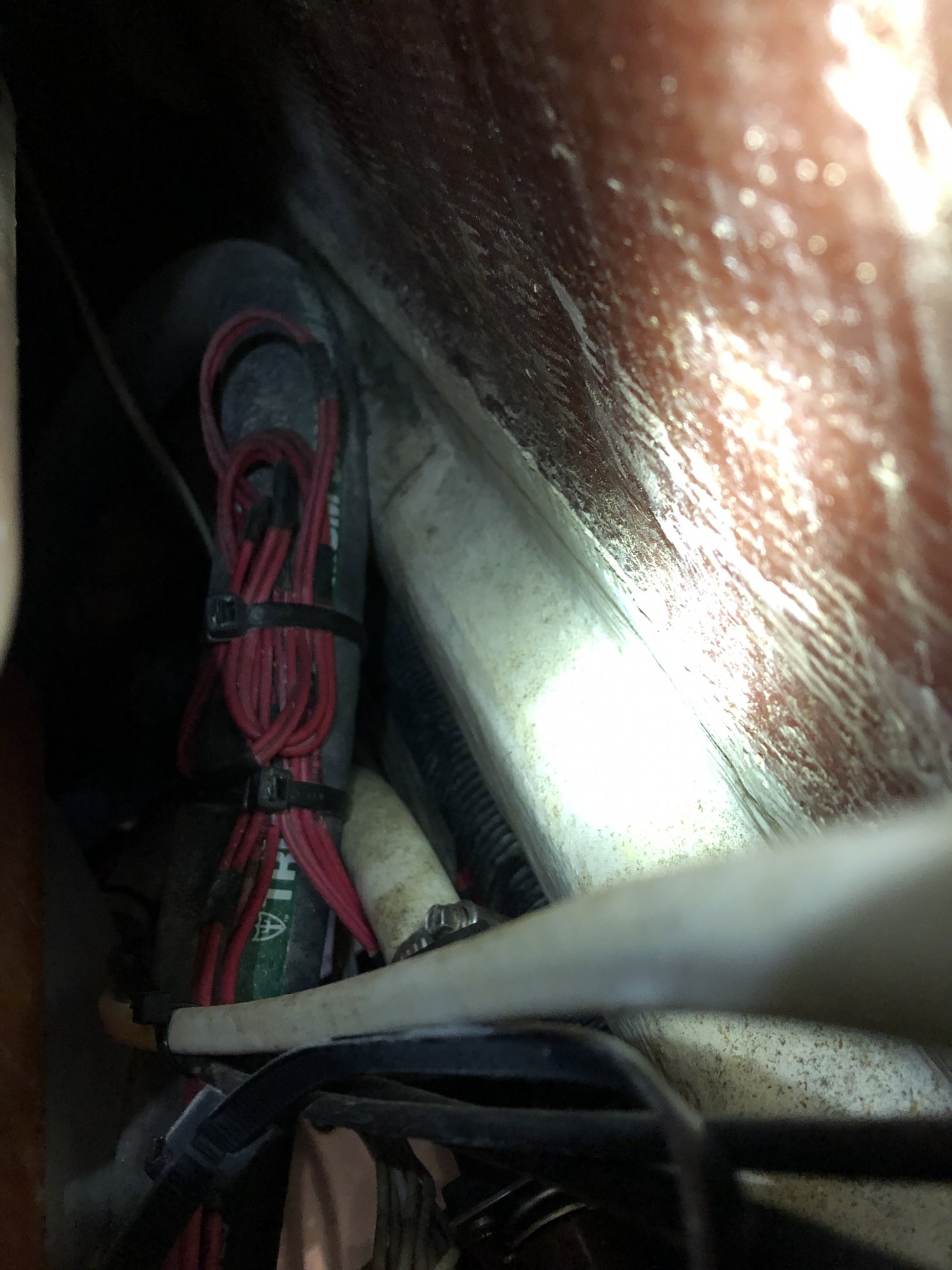

I'll take photos the next time I'm on the boat, but generally speaking I likely will be unable to reach the bottom connector to completely seal the outer hose.
The best thing I might be able to do is to master some kind of (rubber?) gasket between hoses to make it somewhat closed.
Would this completely defeat the purpose or would it still reduce the smell?
So far I didn't find any 2.5" ID sanitation hoses, only heavy-duty exhaust or light-duty PVC with PVC having a huge price advantage. :)

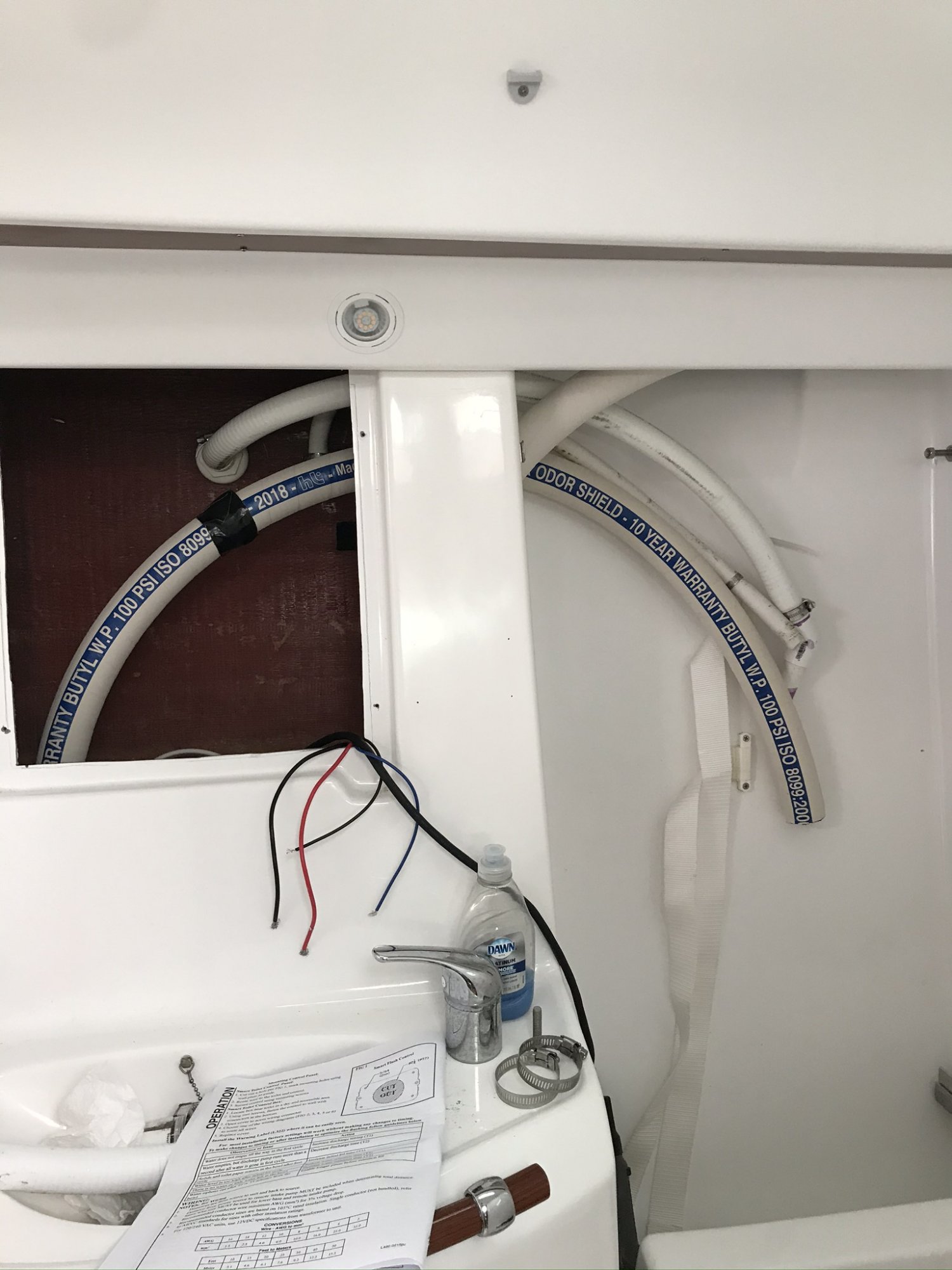

I would suggest removing the holding tank. It makes removing and snaking the new hoses much easier. It also gives you a chance to thoroughly clean the tank. I found it easier to attach the pump out hose to the tank while it was out then install it back in one piece.

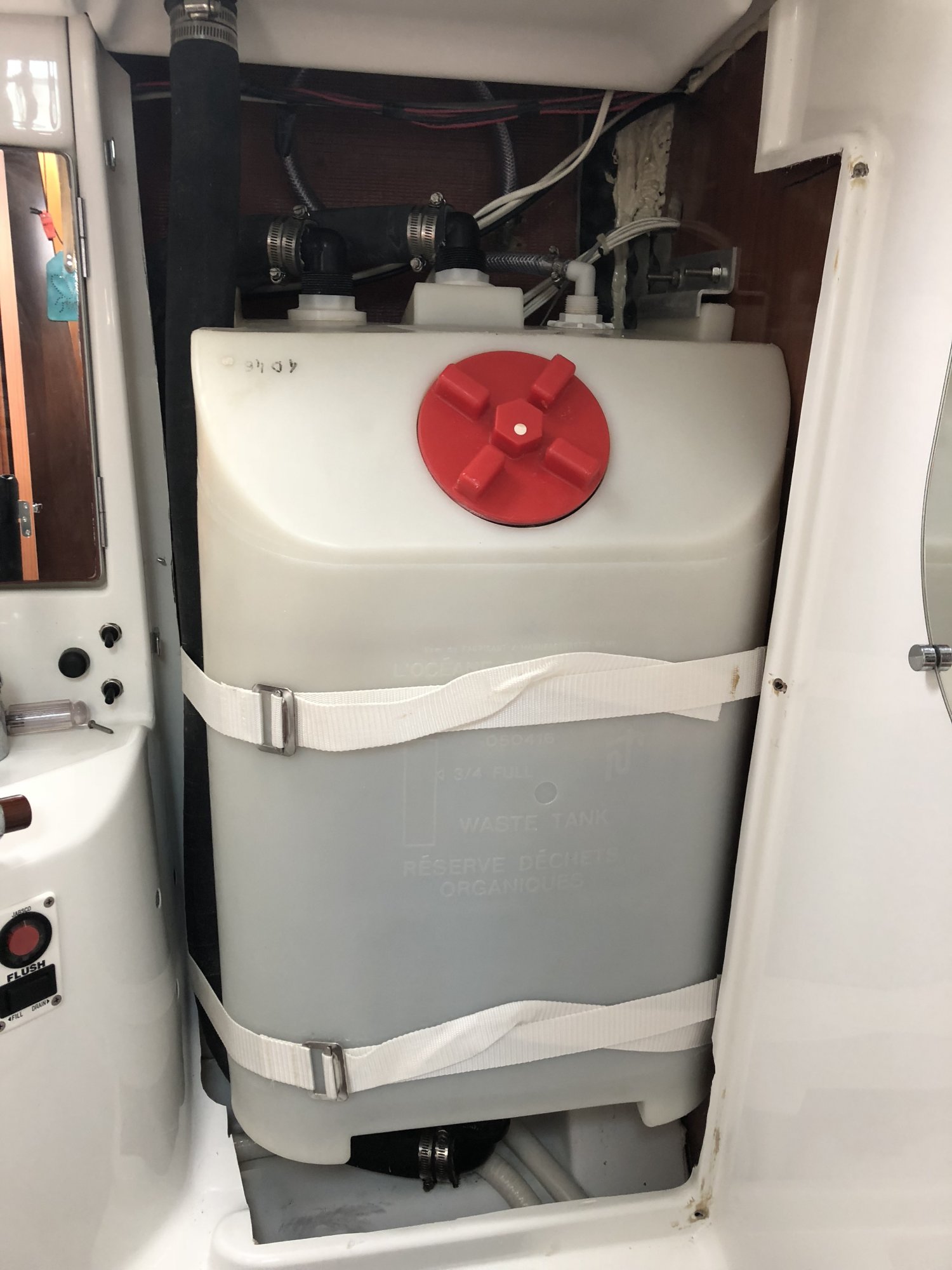

@Bob S - thanks for suggestion and for the picture!
I'll take pictures on my boat next time I get to it.
Removing the tank would definitely make plumbing easier, but how did you remove it?
Did you have to remove a front wall (with the door) in order to remove the holding tank?
On my boat the door is definitely smaller than the tank, but the wall appears to be somehow screwed in from the back.

This is the aft head on my 393, there’s a panel held in place by 6 screws. Remove the screws and lift up the panel. There isn’t a door on my panel. The tank is just strapped in place. Haven’t been on a 373 but I can’t imagine they were built so that it couldn’t be removed. Good luck

The holding tank isn’t behind the panel behind the toilet? The 423 has a removable panel.... tank is behind it mounted on the wall and is easily removable. I know beneteau wasn’t overly considerate with things but I find it hard to believe you can’t get to tank. Btw..... I am removing and changing hoses right now. Beneteau also thought it a good idea to strap wires onto hoses using zip ties in areas you can’t easily reach......

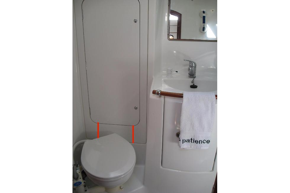

@NYSail I CAN remove the top hoses, but it looks like their fittings will still prevent the tank from lifting high enough.
I'm thinking about cutting out the bottom section of the panel (at red lines) and re-attaching it afterwards.
I agree that anything other than replacing the hose is just a temporary measure, but I also need to wait until the boat is on the water to pump out the bottom hose before detaching it.

I would remove at least that piece then put a nice piece of wood or plastic board of some sort in its place with screws for future removal. Access on a boat is king! does your tank have a clean out port like the one in my picture??
