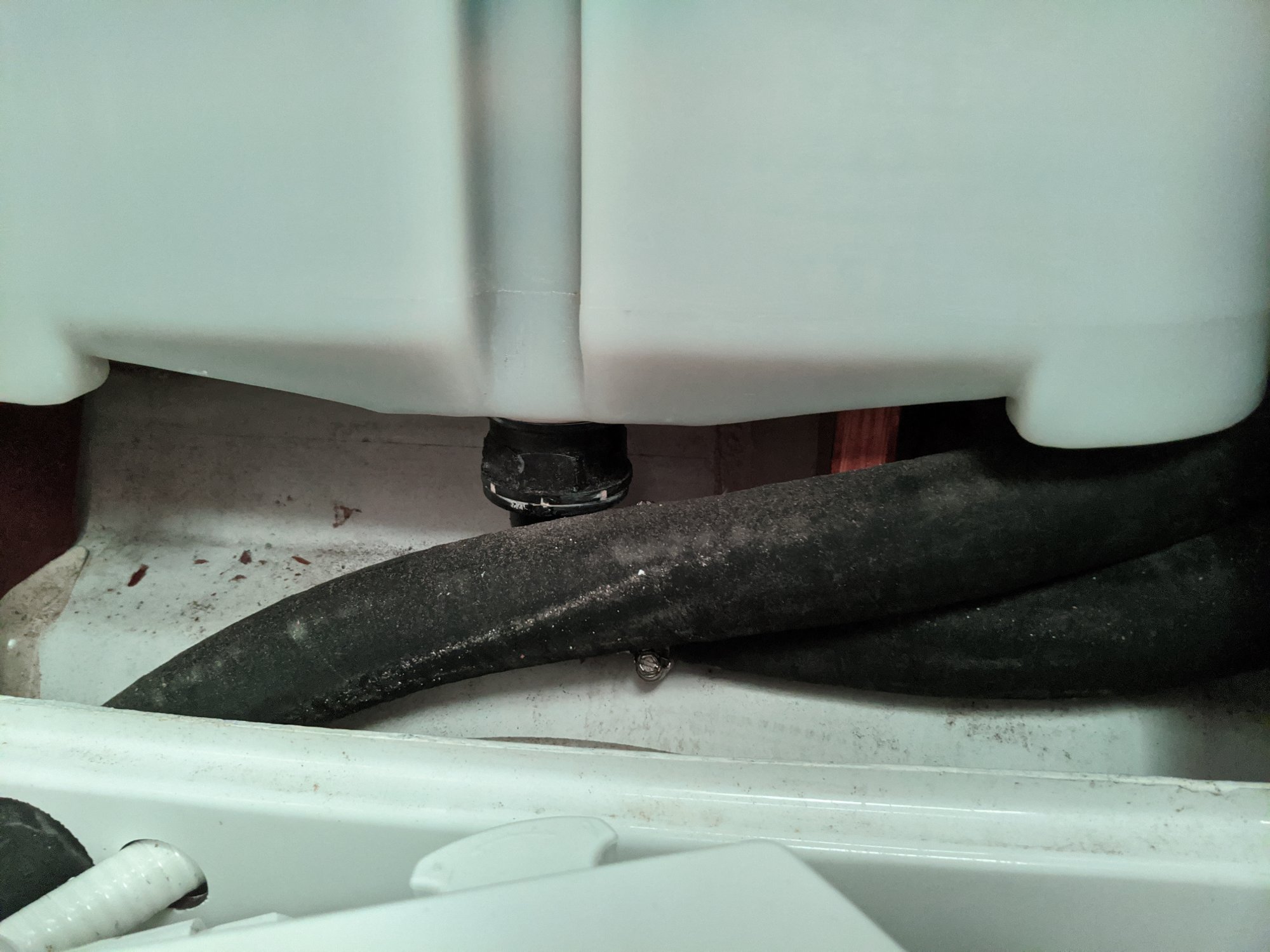

@NYSail - thanks for suggestion! Yes, my track has a clean out port similar to your picture, but pump out hose is under the tank, so it is not empty.

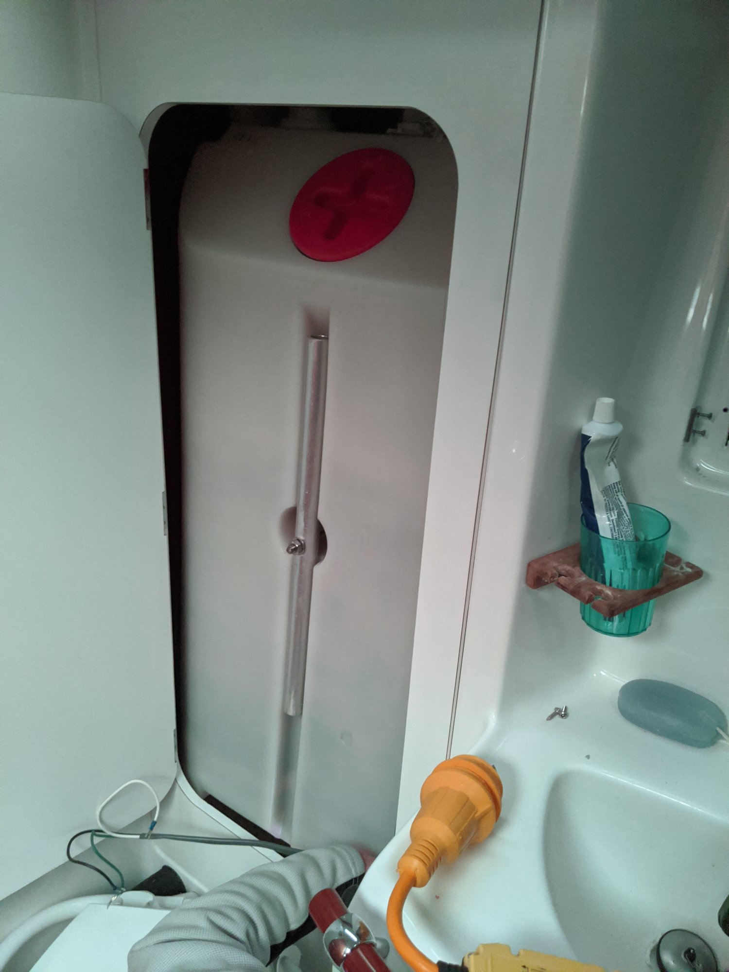

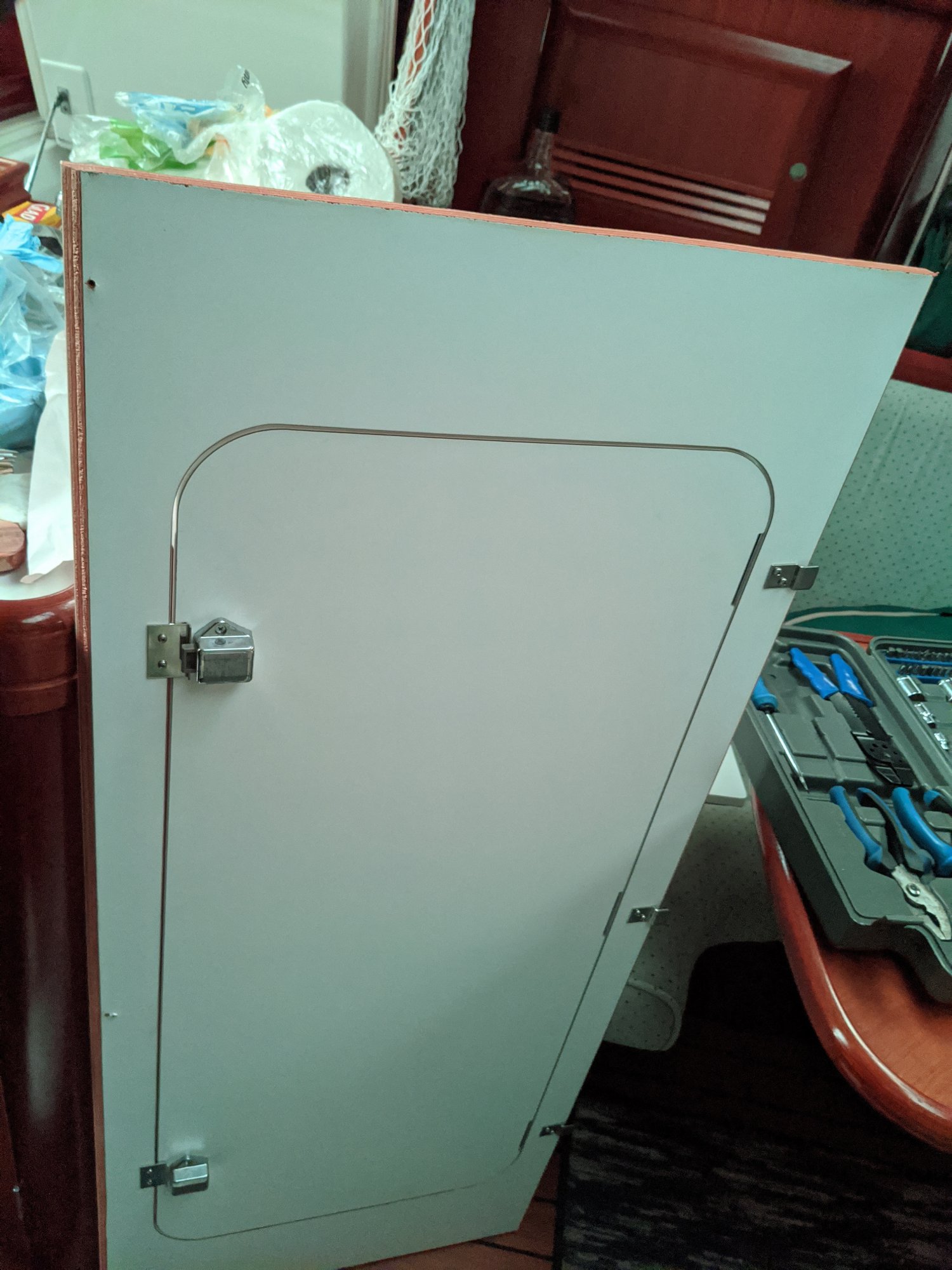

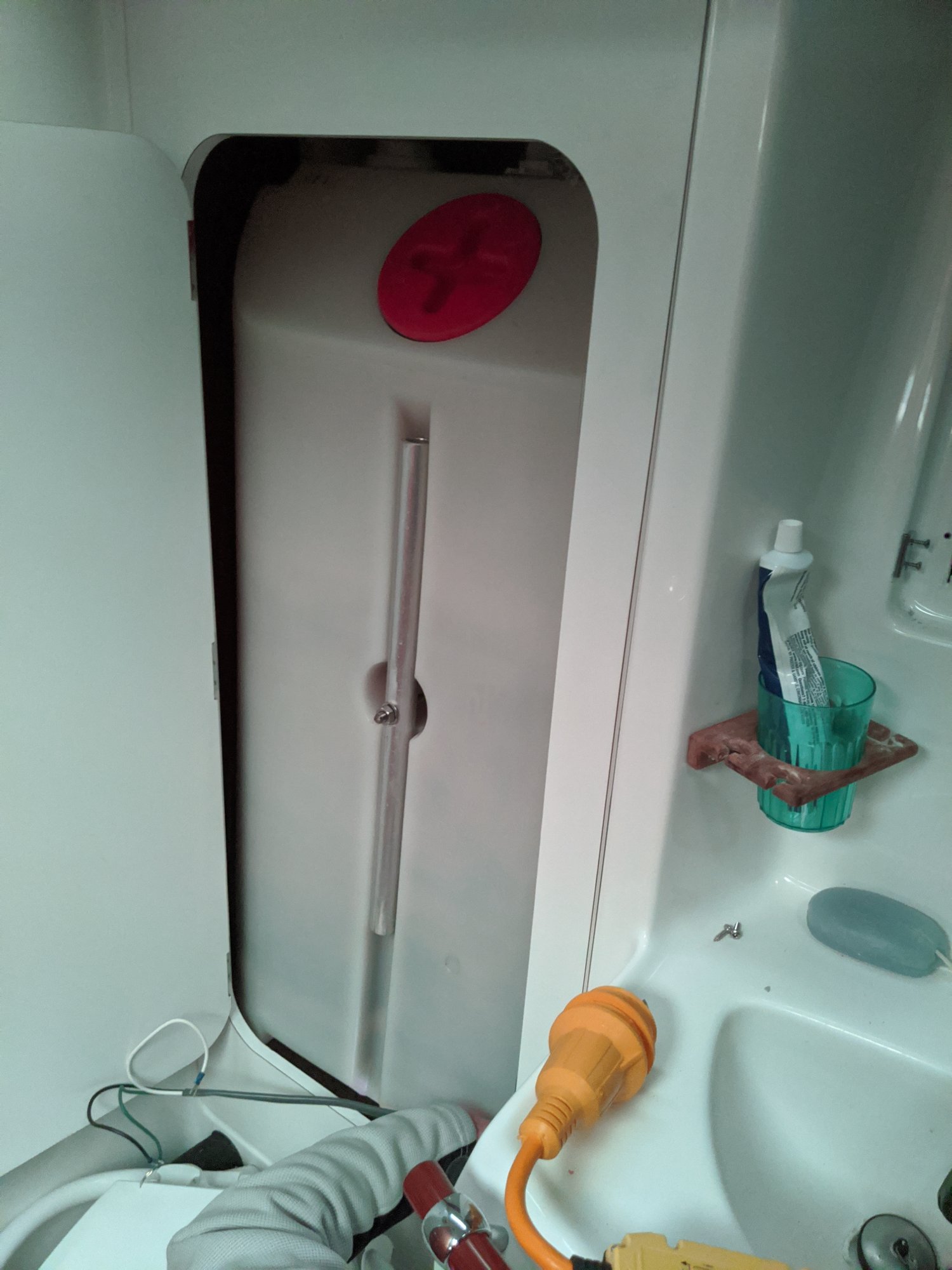

My friend has noticed that the wall IMG_20200223_144146.jpg with the door is only attached by 3 screws on the right side.
Although they were screwed in from the inside we were able to unscrew them through opening under the sink and behind the mirror, and remove the wall without cutting it.
That required cutting the caulk on top and removing the toilet, but wasn't nearly as difficult as I've dreaded.
Here is the picture of the removed wall: IMG_20200223_145914.jpg

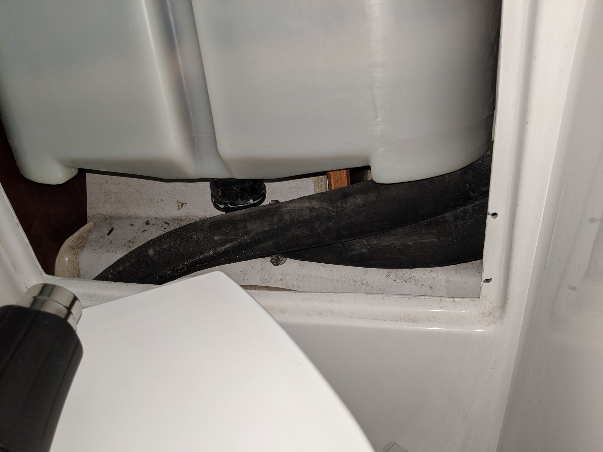

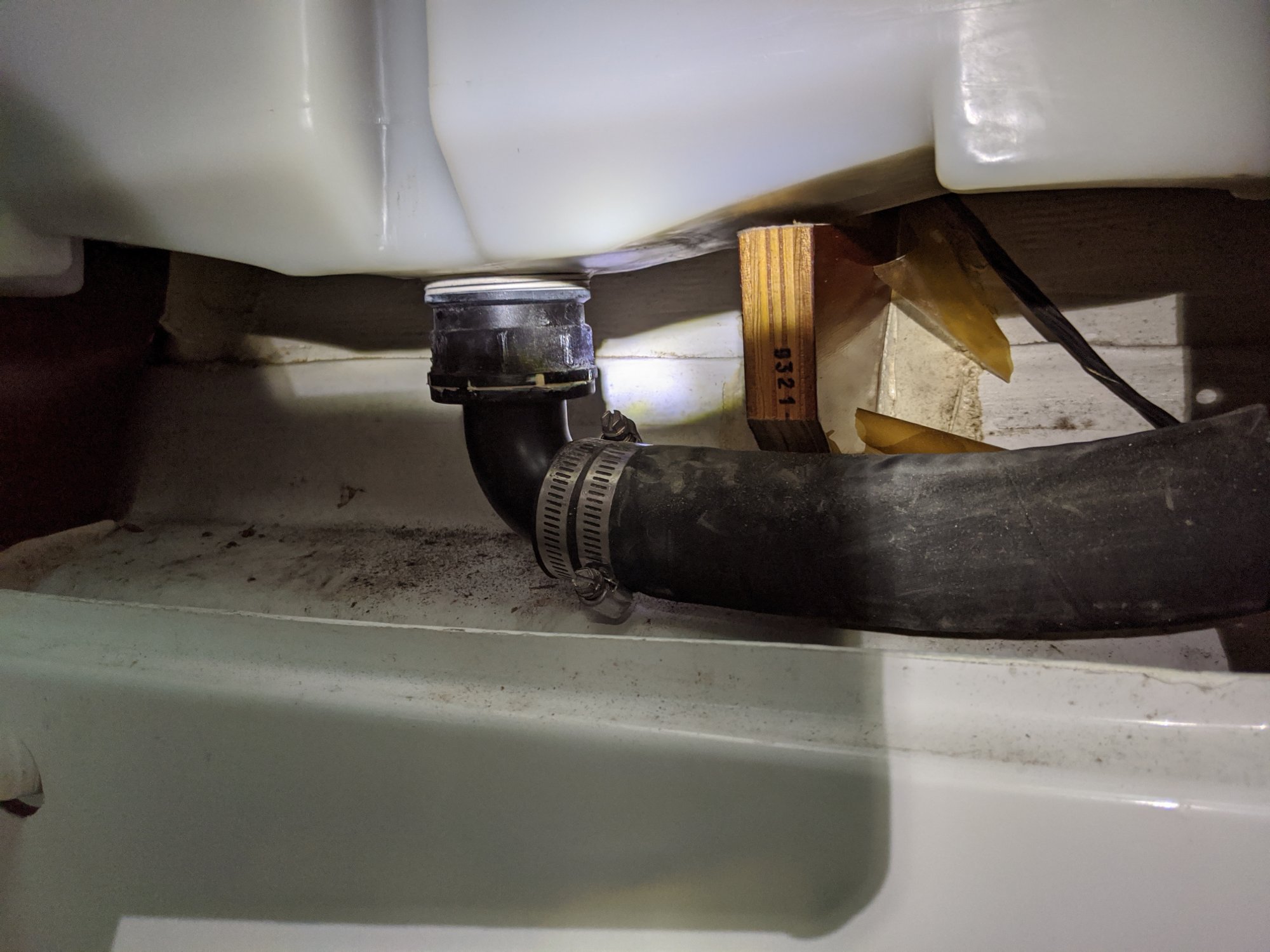

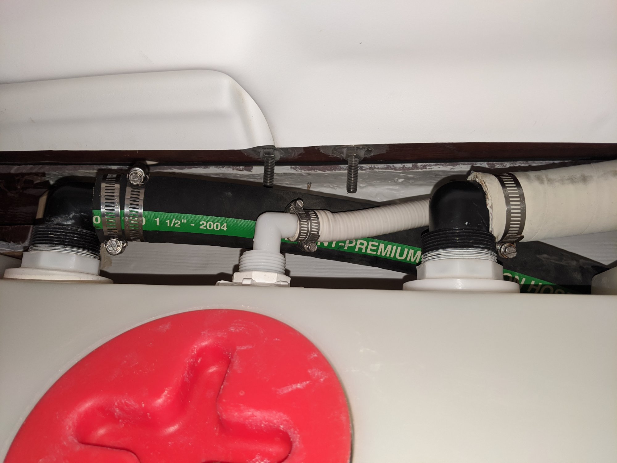

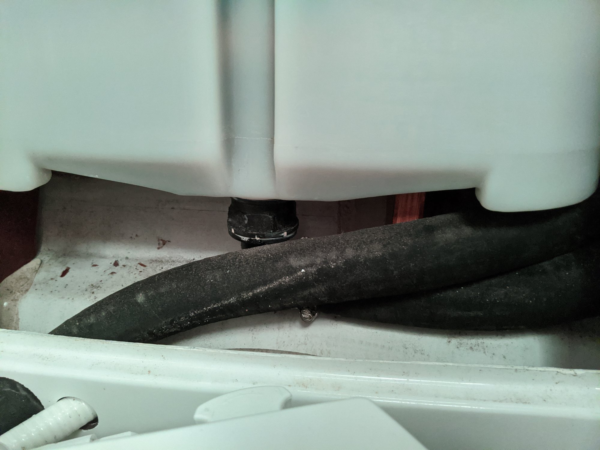

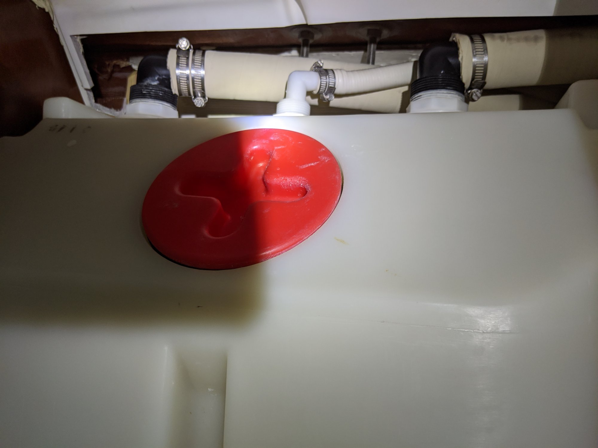

I've replaced two hoses that are attached to the top: IMG_20200223_153835.jpg and have a reasonably good access to the two hoses that are on the bottom:IMG_20200223_145002.jpg .
I'm also considering removing the tank with the bottom hose attached and doing the replacement outside of the boat to avoid risk of spillage.

congratulations! Yes remove the tank before surgery! In the long run will probably save you time. You have 2 hoses attached to the bottom?? Deck and mascerator pump-outs? That would mean no internal pick-up tube.... If you do have one (pick up tube), check as they are prone to failing. On the 423 they used it for the mascerator pump and when it would give way the pump would not prime.

Some posters have had great difficulty replacing hoses on the tank barbs. Replacing on the outside could save a lot of trouble and frustration.

Sounds good! I found that a heat gun has helped tremendously to remove old hoses, and getting new hoses on was suspiciously easy.

I only have one hose attached to the bottom, the second one goes from the toilet to Y-valve.
I've already found out about detaching internal pick-up tube last year after my brand new macerator pump has refused to suck anything. :/
I've re-glued it and it seems to work so far, but is there a better long term fix I can apply with tank removed?
